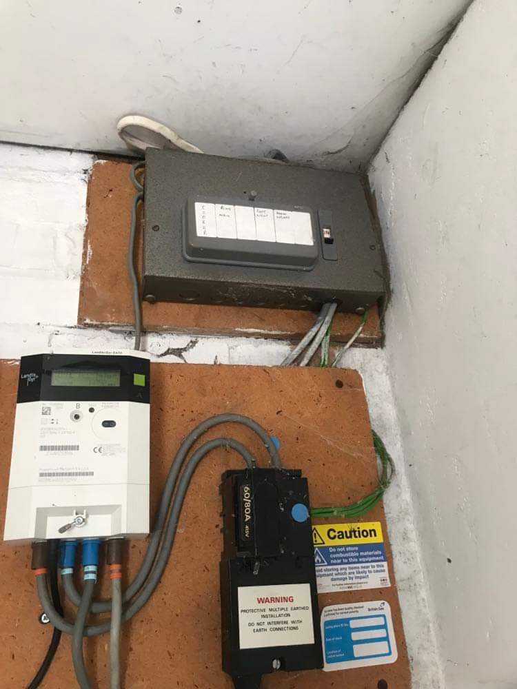

HI , potential 2 bed 1970’s bungalow buyer here….
Our surveyor (RICS) has pointed out there is no circuit breaker to the electrics (fuse board, meter etc. installed in garage). Please see crappy photo attached. Vendor bought property in 2005, and, looking at the photo, the installation does NOT look to be from the original build era.
I’ve asked to see the EICR from vendor but yet to have a reply.
I guess I have 3 questions for you.
Is this lack of a CB a C1?
Would we have to install one ?
Would that then entail a full rewire?
I’m obviously wanting to renegotiate the selling price - any opinions from you guys will be really instructive . Thank you

It has fuses rather than circuit breakers. It has no RCD protection. I would say it could well be original
Its not dangerous, it's just 'of its time' - it's certainly not a C1. That said, a new consumer unit would be advisable though.
An EICR (electrical assessment) would be useful to see what sort of a state the installation is in, but the wiring could well be in good order. An electrician will test this as part of the EICR.
Oh and welcome to the forum.
On its own, an old fuse board like that will be a C3 on an EICR “improvement recommended”
There will be a whole list of C3’s regarding rcd protection, lack of SPD, etc….. but there’s no reason to upgrade unless a C1 or C2 is present.
Of course, upgrading the board would probably wipe out every C3 on that list, but as it stands, there’s no reason for the vendor to reduce the price…. But then again, there’s no harm in asking.
If there is no RCD protection to supply sockets for outdoors it will be a C2.411.3.3
As others have already said the condition of the installation some 30-50 years on can very between "OK, but dated, not enough sockets" to "shoddy mess of DIY and other work", so the fact the CU is quite dated is not really your biggest concern.
If you do buy this property you will want to change it for various reasons, ranging from improving safety (even if currently "adequate") to part of a total rewiring job if you decide/realise there are simply not enough sockets and lights, and/or where you want them.
If you might rewire or do any sort of major job, then please do it first - before you consider decorating and new carpets!
