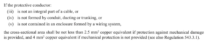

My folks property,was built in the 60's.and had no cpc to any fitting or switch.
An inspection showed they had all been clipped back at the sheath (t&e) :rolleyes: some micro surgery later,saved the day.
I guess the original spark must have been a Christian fundamentalist...
Was that also the case under the old 16th?
The singles that I ran in were insulated and sheathed, as I needed to pick up some live feeds and also at that time it cost less than g/y singles
Not 100% sure about the 16th mate. I'm sure someone will be able to tell us.
