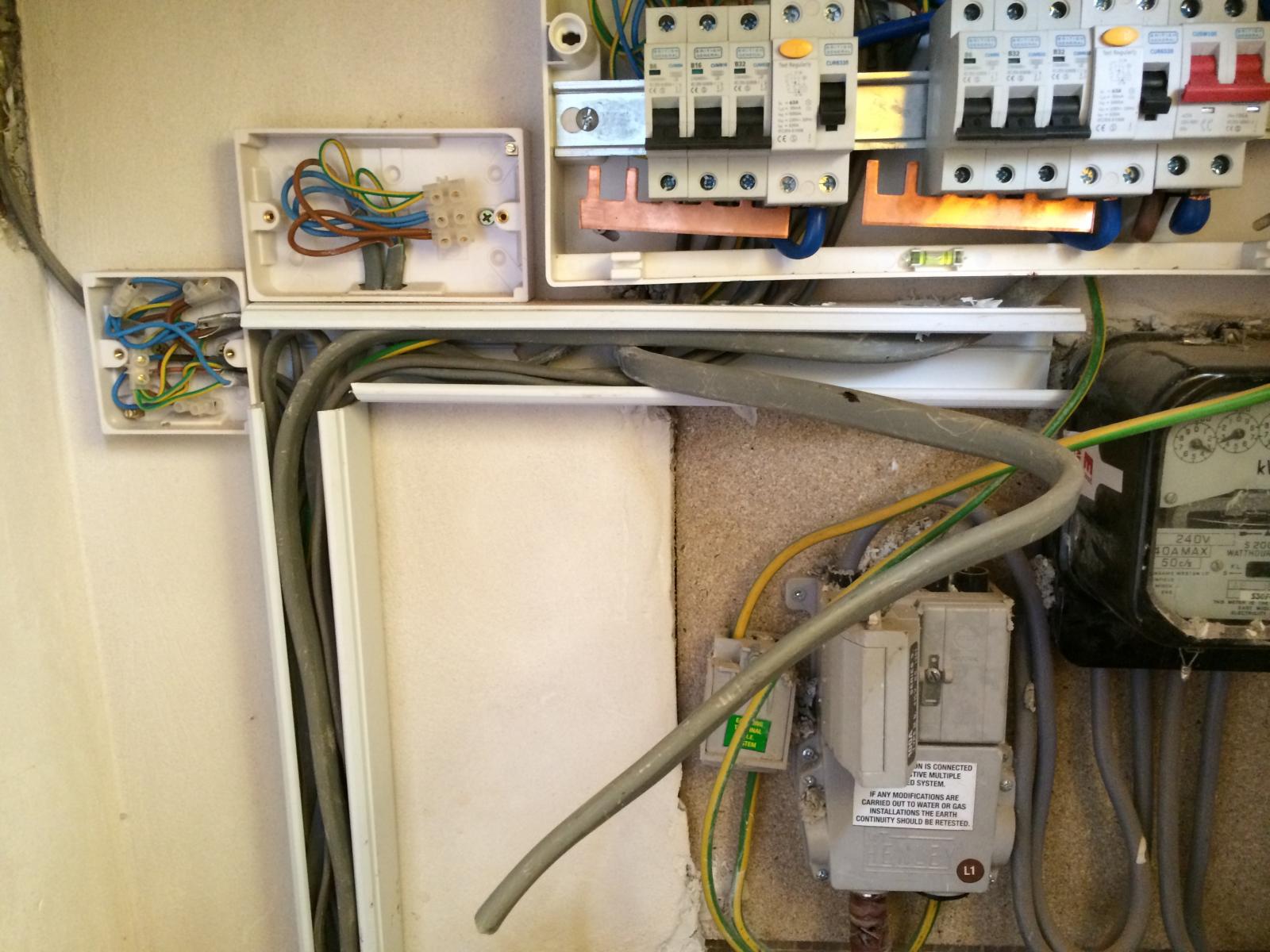

Just found the photo, don't know if I added it earlier on, but he has put that its TNS with PME ?? WTF?? Not only that, he has specified that the Ze is 0.71 ohms.
Take a look at this photo, clearly says PME, so should be less that 0.35 ohms and certainly not 0.71, admittedly I didn't measure it, but am going back after the weekend.

I would just like to add, in the photo above, I have removed the trunking cover and the patress box lids so you can see whats inside.

A Ze over 0.35/0.38 ohms isn't as uncommon as you might think!! There are quite a good few Converted TN-S system that are still ''Work in Progress''!! But i wouldn't think that many are in the 0.70 ohm range....

the guy that "installed" that mess has missed his vocation. with workmanship of that calibre, he 'd make an excellent plumber.
Reactions: 1 person
Its people like that make proper sparks look bad to customers. Inform elecsa asap so he can be struck off!!!!
even the polish builders at todays job were not that bad apart from they forgot to tighten up neuteal
a water heater under a sink
what a waste of time,I went with glenn to discuss this with elecsa/niceic today at the show and what a load of garbage,despite clear evidence they won't act unless the customer complains,they said they couldn't act on the photo evidence as they are not the police,the guy wouldn't even agree that it was a shoddy install! He was totally not interested and would not even say what action they would take against the installer,however he did say that if a complaint was made then the original spark would be given time to correct it and resign it! would you trust him?

This needs to happen.. uksparks, you are sitting on a prime example of why the current system is failing the industry and the British public. I urge you to assist the customer through every stage of this and make sure the installer and his scheme are held to account !
