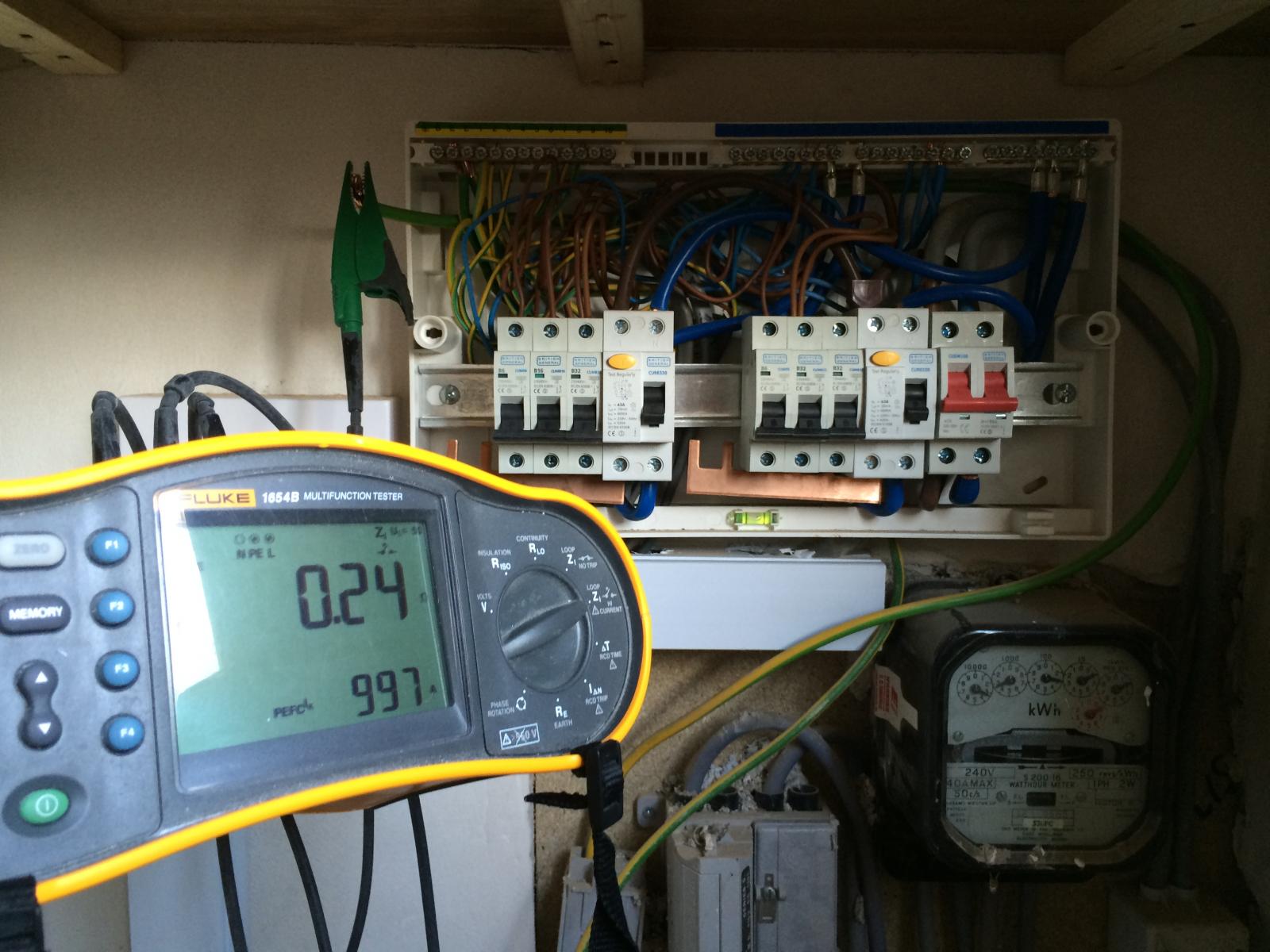

Well I have done the EICR, oh dear, ohhhhh deeeeaaarrr, oooohhhhh deaaarrr, I think you are going to need to sit down before I tell you... (Plug i need to type it all up then tell you)

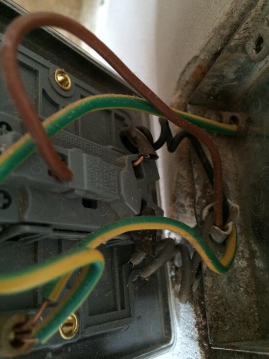

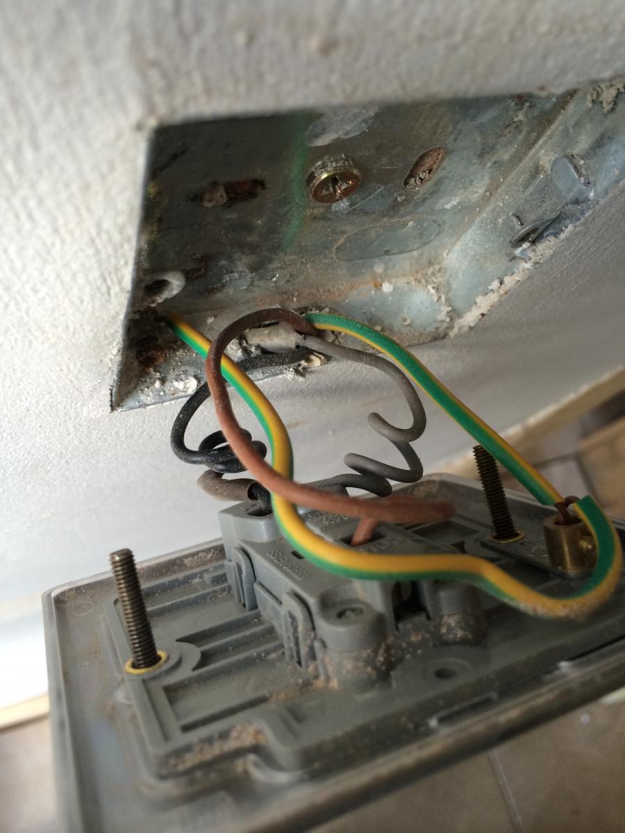

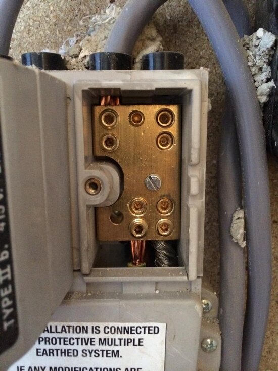

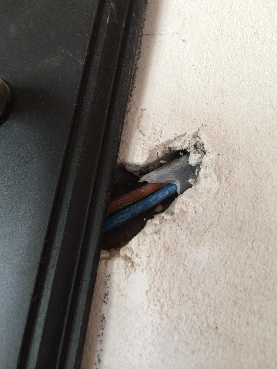

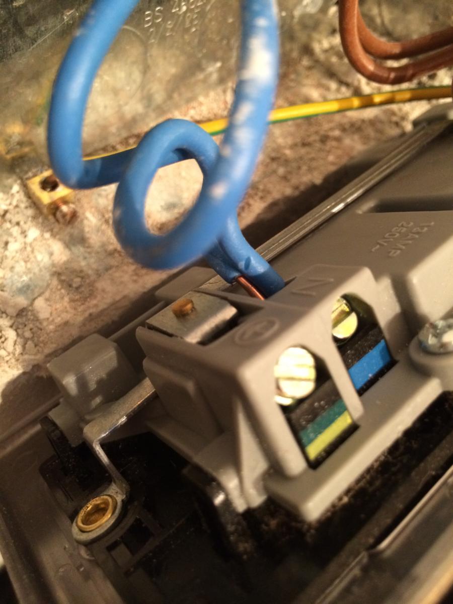

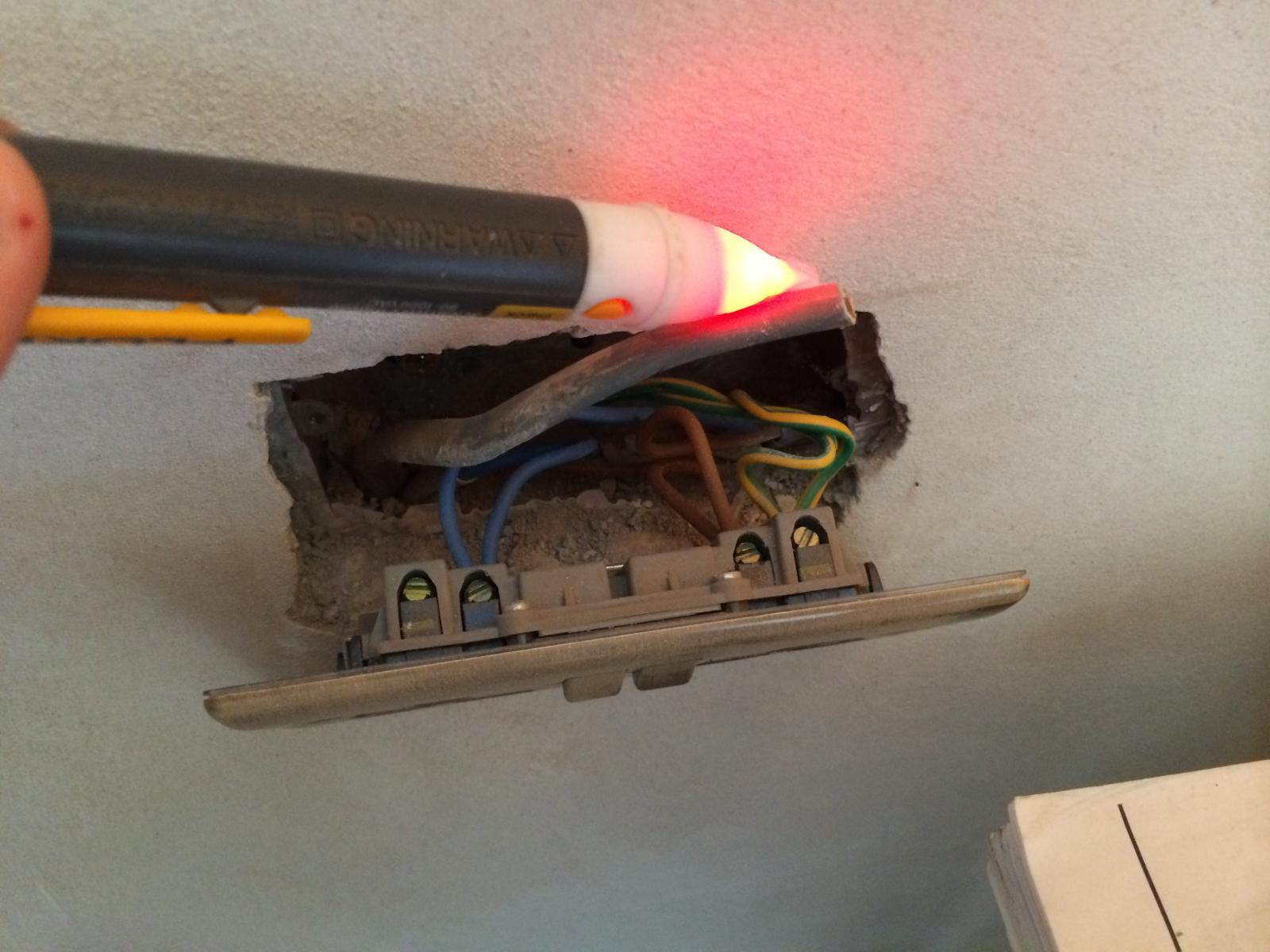

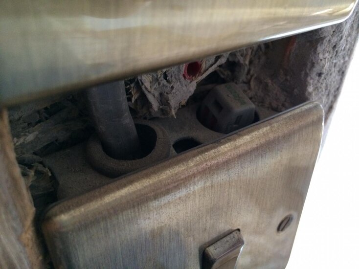

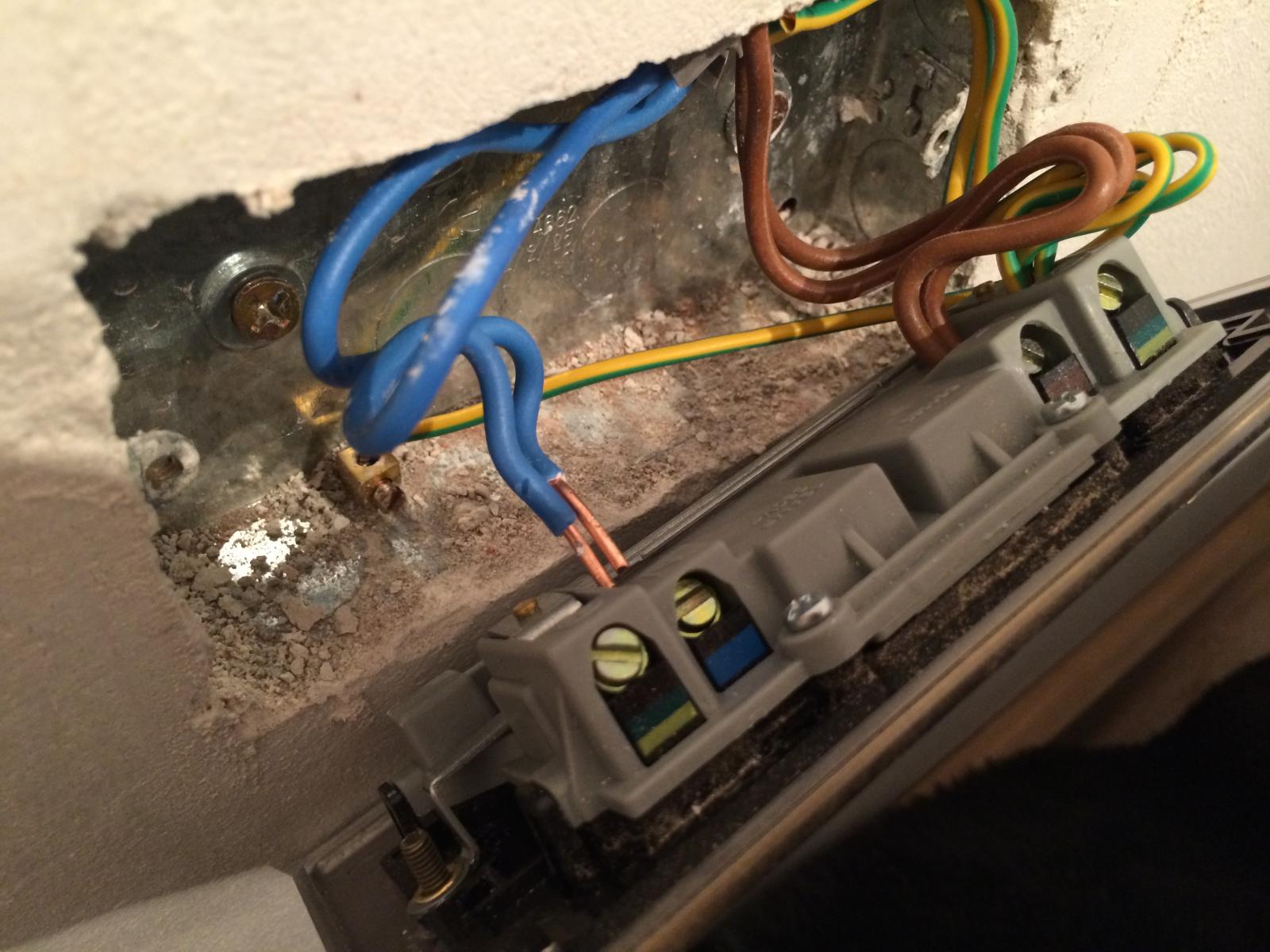

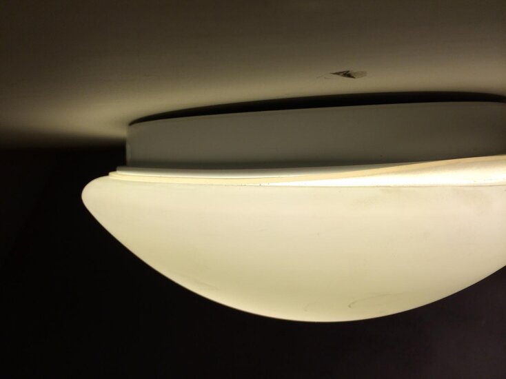

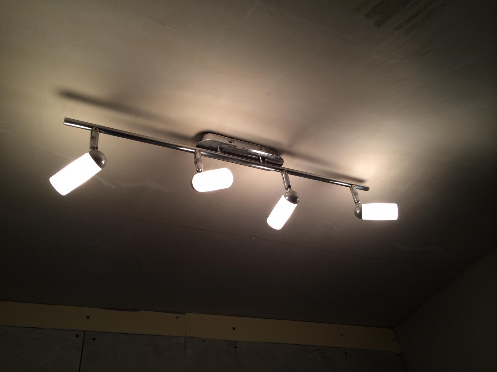

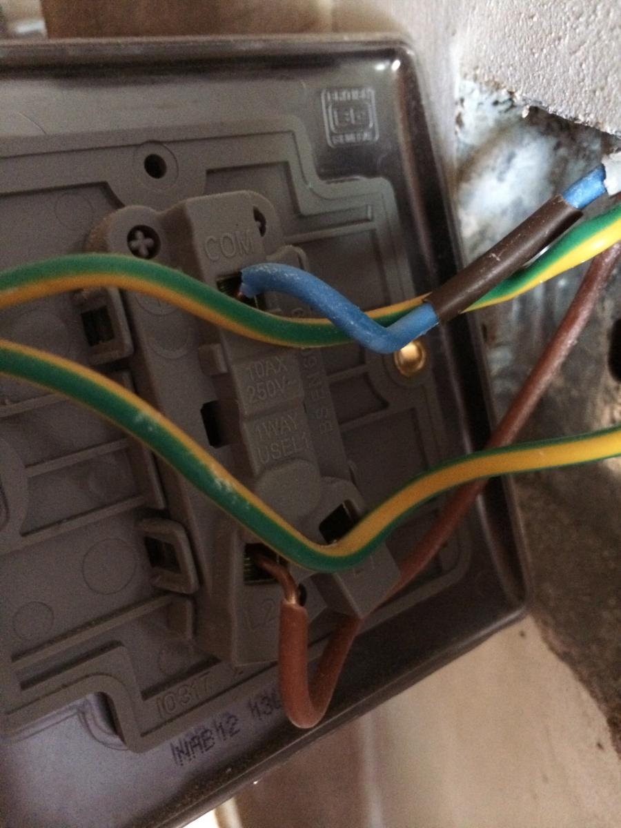

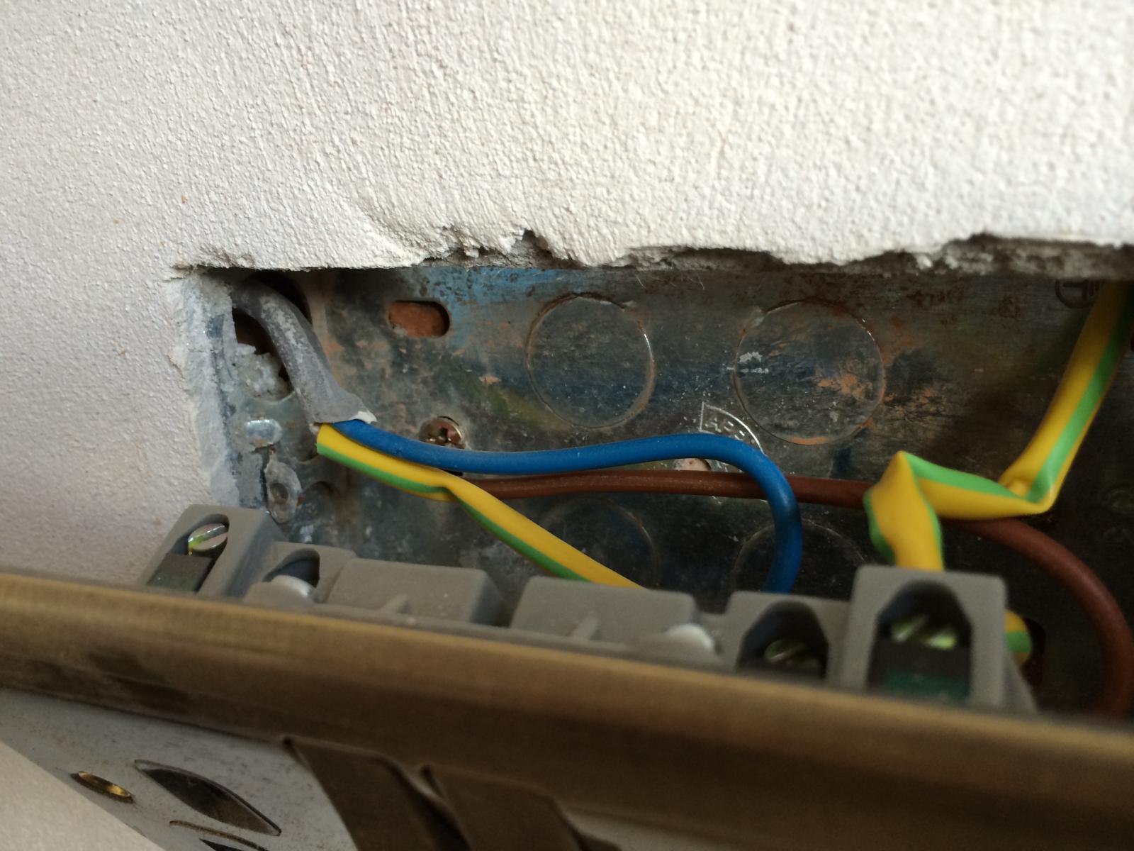

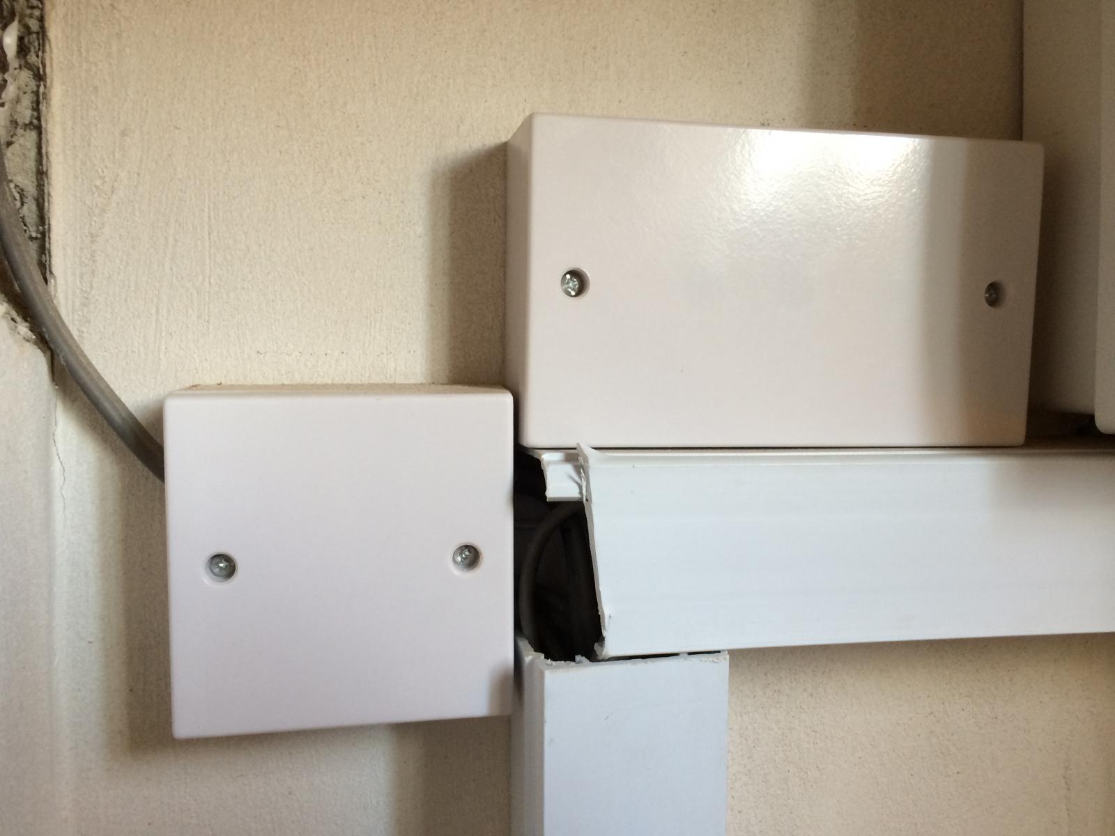

Ill let you read it then ill tell you if you have missed anything, but check out a few photos below...
2014-06-24 12.09.06.jpg2014-06-24 12.03.09.jpg2014-06-24 12.01.43.jpg2014-06-24 11.27.38.jpg2014-06-24 11.25.42.jpg
Unsure of the IP rating of this above shower...
Seal not fitted correctly...
No grommet example and no brown sleaving
2014-06-24 10.35.16-1.jpg2014-06-24 10.29.23.jpg2014-06-24 10.30.30.jpg2014-06-24 10.19.50.jpg2014-06-24 10.13.03.jpg2014-06-24 10.10.27-1.jpg

The OC and >200 were all meant to say >2000 on the test results as they were all open circuit.
i am sure he has just made the figures up, like the Ze for example... And PFC...
Reactions: 1 person
Picture 2 and TNS on his report, not much point in carrying on really!

theres a hell of a lot wrong with the installation considering it's brand new!

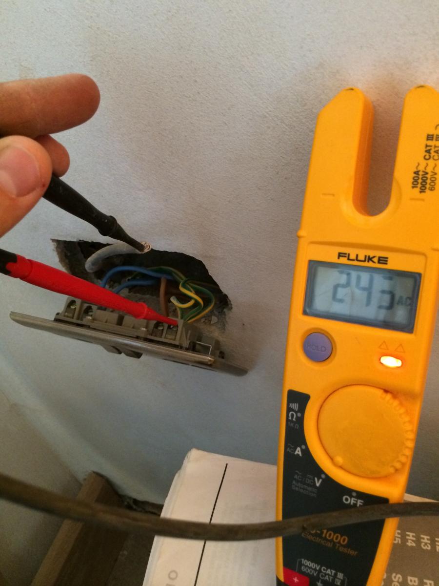

forcthose of you who missed it, half the downstairs light circuit has no CPC continuity to the MET, ecerything visible was correctly connected and no junction boxes anywhere so I'm guessing the break or whatever is causing it is hidden on a wall somewhere.

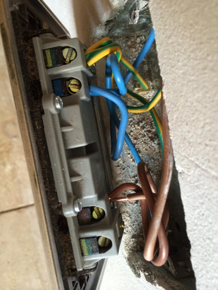

The other thing, the upstairs sockets, it's a radial (apparently) , there's seven sockets in total upstairs, but 4 of them are spurs... Or appear to be. There's no junction boxes anywhere and all sockets oybgave two cables so none if them are spurred off a socket.
am I not right in thinking 4 out of 7 sockets being spurs on a radial us raking the pee and not allowed?
As a radial additions can be made at any point! That said on a rewire that shouldn't happen!

Another thing, on the 5x RCD test, theres no way what he has put was correct because I tested it numerous times and it kept giving me approx the same which is a lot less that he put, I bet he made it up.
I did just look in the BGB and yes thats correct, but regardless its still crap IMHO plus where the heck are they all connected? Seems a bit dodgy to me.
You know, its unacceptable making them all spurs because if you can get one sodding cable to the socket you can get two, there's just no damn excuse!
