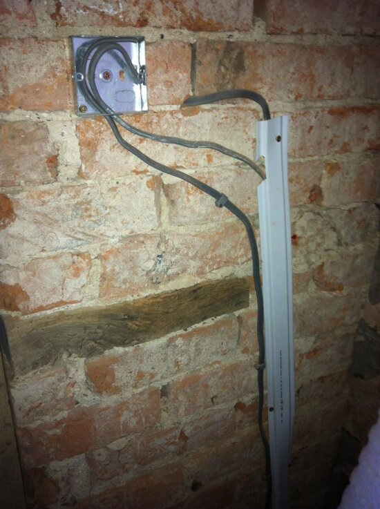

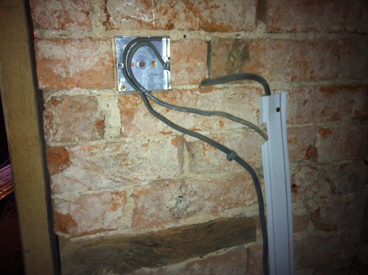

I now have the interesting job of running in a new ring for the kitchen and radial for rest, plus a light circuit, I really don't know where to start. It's going to have to be taken around the outside I think, I can clip to wall, put 3mm steel capping over it then it's having 50mm of render so it will be hidden, where the heck I am meant to get 3mm from though I don't know.

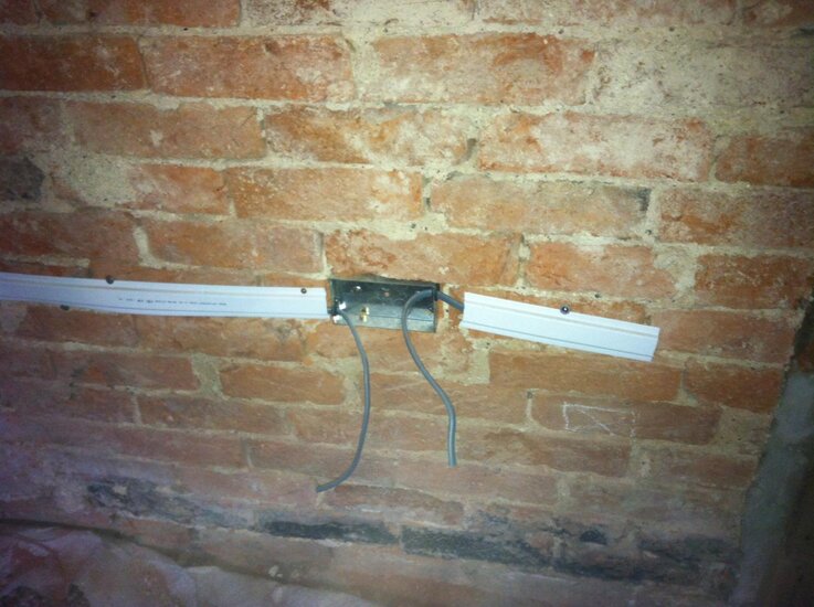

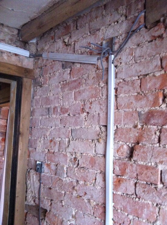

Tidy job that.
that kind of pish would bring a tear to a glass eye.
thats a rip out and start again job if ever I see one
Reactions: 2 people

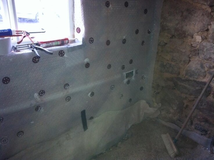

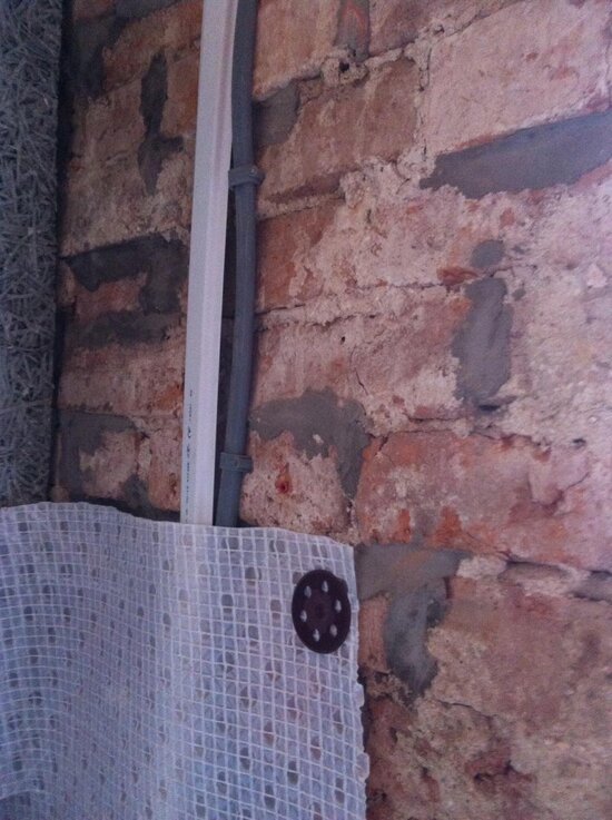

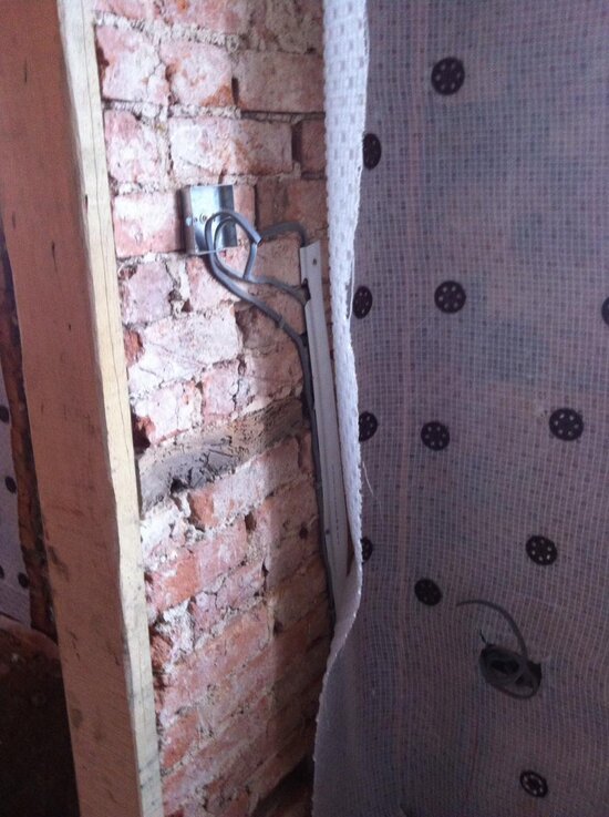

I don't think that's his fault, looks like it was put on after anyway, something to do with the lime render maybe, I don't know.

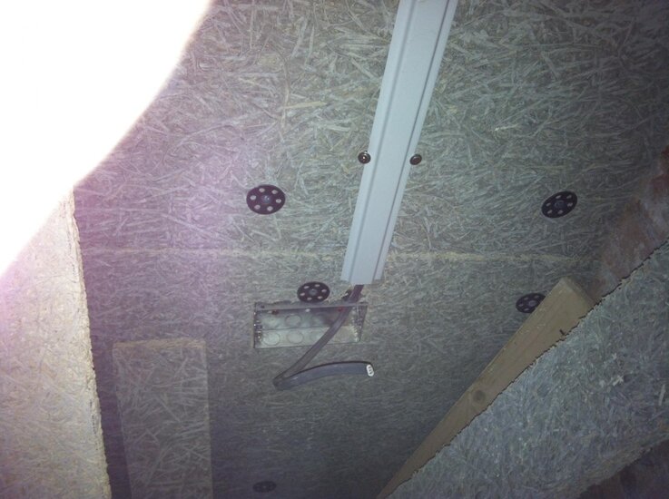

well if its SBR then he shouldn`t be drilling it......
if its platten then cutting out for boxes in it breaches it......
so its a no-win....

No idea, I tend to stick to electrics as I think I'm quite good at that. You know, his brother is a plumber, can you believe it, you would have thought he was the plumber, hang on a plumber would probably have done a better job of it.
The customer is literally running out of money quicker than you can say it due to everything and I know this would be a huge set back. I do feel for them but they need it looked at. They are paying off rent on another house at nearly a grand a month whstvtgis is being done. I'll tell them that I think it needs further attention at a cost.

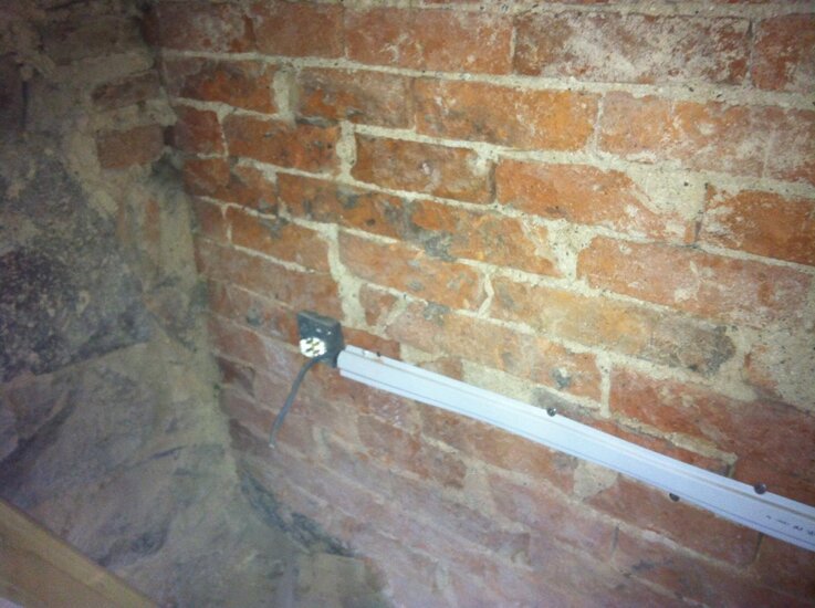

the OCPD is wrong if it's radials but then he claims they are rings... God knows eh, it would be a nightmare to get to the bottom of going in blind.
this is a small claims court job, unless his insurance company will cough up for it voluntarily.
Could well be worth getting building control out to give an independent assessment of it, otherwise it will just end up being your word against his in court.
I'd also make sure elecsa know that rectifying this work will need to be charged to his insurance, it looks like half the walls are going to need ripping out to get the cables into safe zones, as well as bringing the new supply through to the extension.

Just looking at the certificate, there's so many bits missing and incorrect information, he clearly has no idea. A PFC that high is obviously too high for the breakers, so it didn't register with him there... PME or TNS? Which is it, he needs to know this else how can he possibly know if it complies?

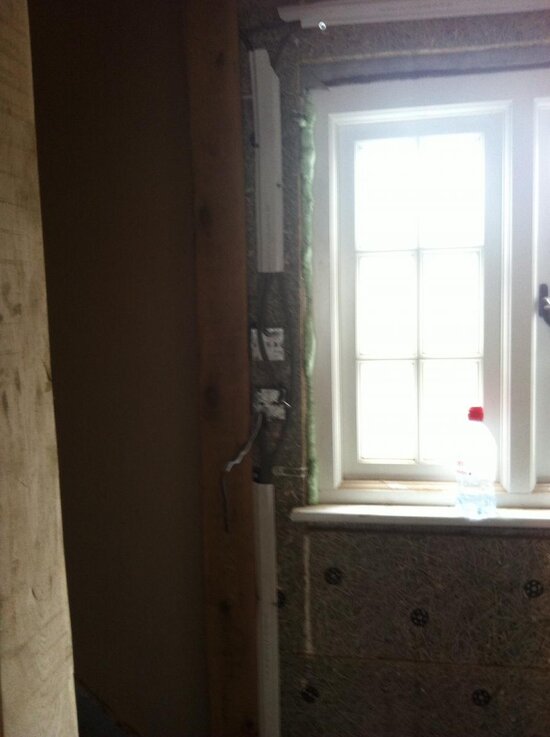

In one of the pics it's capped on top. It should have been studded out using the designated fixing points. The builder should have known that too. I think this is a case of employing 'cheap' contractors who are chancers. Always costs more to put right

I'm sure he is a nice lad and when I spoke to him he sounded nice etc, but unfortunately this electrical work is substandard.

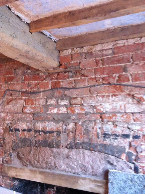

I can't believe what I'm seeing...well I can actually it happens way too often! He could have at least used rubber grommets tight git.

This work is a breach of the building regulations and therefore an offence under the Building Act.
This should be enforced by the local authority, although possibly the HSE may be prepared to take an interest.
Putting people at risk by undertaking such a low standard of dangerous work is something that should be addressed.
The HSE can cover work undertaken by self employed persons, although they may refer it to the local authority.
