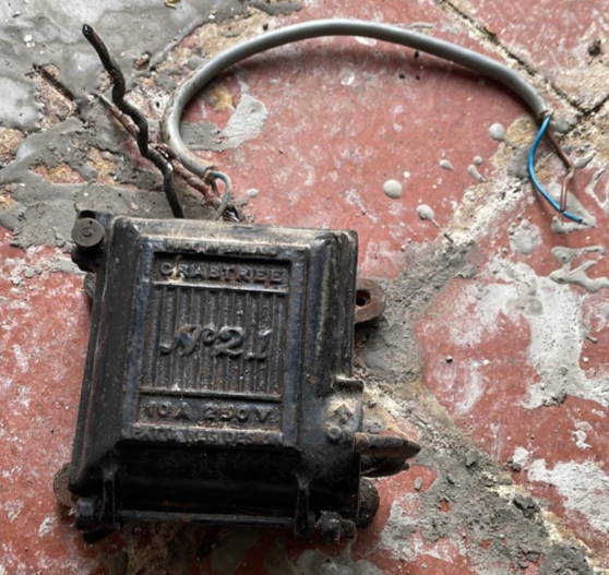

The factory I work in was a WW2 Hospital. We had a bit of quiet time so I decided to check the old conduit systems that are no longer in use but have never been taken down and found runs of old tinned copper Imperial singles. The conduit also led me to an old Crabtree switch that was behind a wall.
The switch was in a poor condition so I decided to restore it. I sandblasted it, painted black and wire wheeled the brass switch knobs and pins.
My question is with the size of cable that was attached to the switch, what power did lights used to draw way back then? (Please see attached photos of the imperial single and restored switch.)
I know Lucien is no longer with us but his history lesson really inspired me to not just chuck things away. So thanks Lucien! The single was also manufactured by the same cable company that manufactured the lead sheathed cable in my attic; Callenders Cables. Shame there’s no date stamp.

It is a bit before my time, but the typical home lighting wire in imperial days had only 3 strands (now 1mm/1.5mm style), so seeing 7 probably puts it in the modern 2.5mm sort of territory.
@7029 dave might have something to say about this!
Yeah the standard lighting cable in imperial was 1/044 3/029 3/036
eg 1represents the amount of cores after the/ is the conductor diameter size in inches
Cable sizeStrand diameter (mm)Strand csa (mm²)Total cable csaNearest equivalent
1/.0441.1180.9810.9811
3/.0290.7370.4261.2781.5
3/.0360.9140.6571.9701.5/2.5
7/.0290.7370.4262.9832.5
7/.0360.9140.6574.5974/6
7/.0441.1180.9816.8676/10
7/.0521.3211.3709.59110
7/.0641.6262.07514.52816
Thanks everyone, appreciate it. I had good fun doing it. I'm eyeing up a Bill Talisman cast iron enclosure for the next restoration.
Speaking of that enclosure, could anyone tell me whether the rope looking material on the lid may have asbestos in it?
Definitely asbestos.
I'll leave it well alone from now then. I have done work in the enclosure before, but haven't touched or disturbed the rope.
I know this will sound naive but are there specialist electricians that deal in the removal of asbestos enclosures?
I'm ashamed to say I've only notice that rope when I zoomed in on the picture, never noticed it once when I was working inside of it. Learning curve for me to be more vigilant I think.
