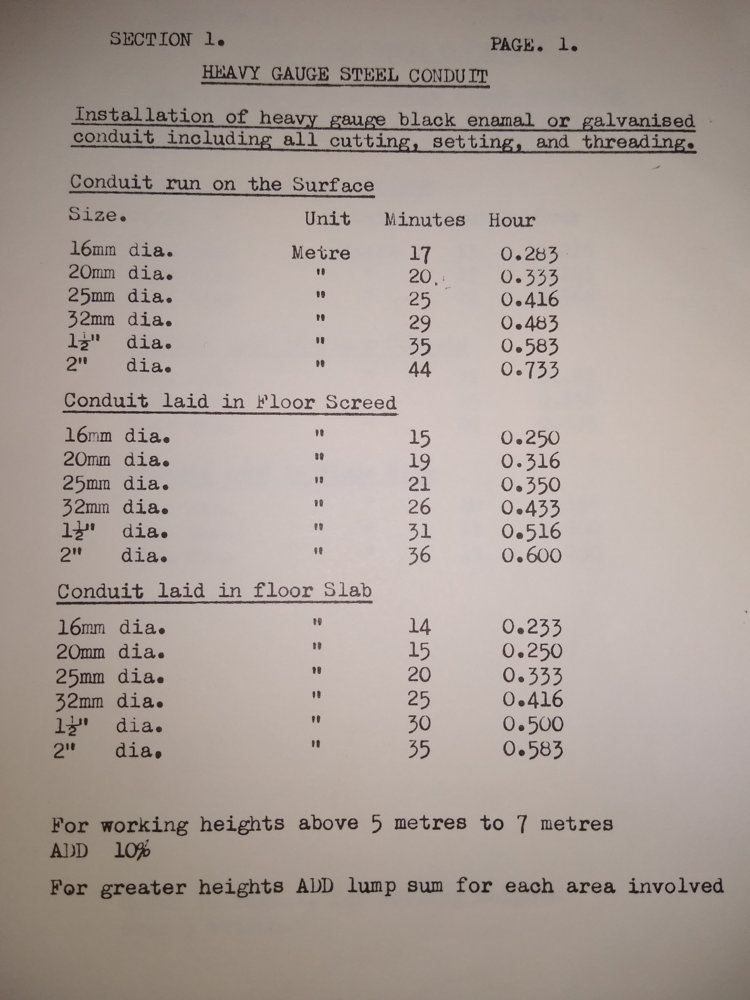

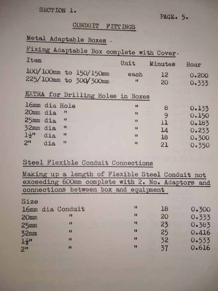

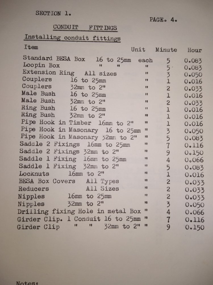

I've got a book, albeit rather aged, on time norms for pricing if you'd like me to dig that out ?

It's a very laborious way of working things out, but this might give you a rough idea of where you need to be. Try roughing it out with this method after first having an estimate at times and see how they tally up.
Not much has changed in the installation of steel conduit since the publishing date of 1978 so it should still be relevant.
Dependant on complexity it takes 50-75% more time than plastic conduit in my experience. So whereas it make take me two days to put in a plastic conduit around 20m x 10m warehouse including pillars and connection complete with testing it could take 3 to 4 days in galv.

Not much has changed in the installation of steel conduit since the publishing date of 1978 so it should still be relevant.View attachment 55977View attachment 55978View attachment 55979

It's actually my dad's old book that he taught me to price larger jobs from. Doesn't get much practical use these days but it's still being kept. ;)
