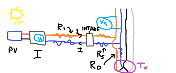

Hi new member here looking for advice. I’m having a nightmare with my installer and Solis and wondering if anyone can come back with any ideas.
5kw solis hybrid inverter, 7kw BYD battery and 6.3KW 20x 315w panels on the roof (two strings). system points SSE at 45 degrees.

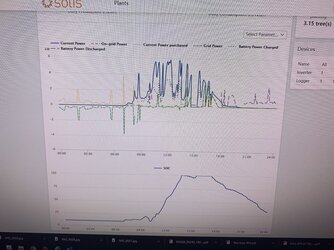

On very sunny warm days the inverter shuts down all generation, current and voltage drop for about an hour as sun is highest in the sky and system then comes back online. I think it’s hyper clipping but Solis and installer disagree (Have no idea say it’s impossible) and want me to video it and check voltage off each strung next time it happens with a MM. I think the panel are producing too much power on these days over 6.5kw even though that would assume max manufacturing tolerance etc are met and the inverter is shutting down as it’s only rated max 6.5kw.
Anyone ever experience this before any ideas? Inverter has been swapped already issue remains. I’m asking them to install the new released 7kw Solis inverter to see if it fixes the issue or temporarily disconnect two panels and see if it goes away. System only installed since last September so this summer is the first one and a nightmare so far of inverter changes and arguments. See photos of the issue occurring.

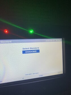

Have you or your installer checked the inverter is set to the correct country code? I've had inverters supplied which were pre-configured for another country which has led to this kind of problem. (Solis was not the manufacturer though).

On really sunny days there is peak PV generation for long period of say 5kW. Some or all of this power is exported to the grid. Let me assume for now it is all exported.
The Solis inverter computer monitors the grid voltage to detect its presence and to act if the voltage is too high or too low. If it acts it is to disconnect the inverter from the grid terminating the export of power.
The Solis inverter measures the grid voltage and if over a rolling say 5 minute period the average voltage is greater than say 255V it acts and disconnects the inverter from the grid. Also, if the grid voltage exceeds say 260V momentarily it will also disconnect from the grid. These time periods and voltages can be preset and are sometimes mandated by the DNO to safeguard the grid's power quality with respect to voltage. It could be quite a problem when a few/many solar PVs are grid connected on the same local distribution line.
The inverter cannot actually measure the grid voltage Vg - see my attached diagram - because it is connected to the grid by cables with resistance - Ri, Rs and Rd.. To export power the inverter voltage Vi must be greater than Vg. Thus when exporting power the inverter output voltage Vg depends on the grid voltage at the time Vg and the volt drop between the inverter and the grid which is I x (Ri + Rs + Rd).
At peak power output of 5kW the current I is circa 5000/250 = 20A.
The voltage drop is of the order Vd = 20 x (Ri + Rs + Rd). If the total resistance was say 0.2 Ohms then the volt drop while exporting 5kW at 20 A would be 20 x 0.2 = 4V. The installation may need the inverter cable (Ri) to be upgraded to reduce its effect on Vd and thence Vi. Not so easy to do this for Rs and Rd.
On a lightly loaded grid in summer the grid voltage Vg may well be high. On very sunny days with high levels of export Vi monitored by the inverter which is Vg +Vd may break one of the inverter voltage checks - rolling average or momentary excess. And it disconnects for a while.
There is also another 'feature' in the solis inverter which may be enabled. This is the power-voltage reduction profiler.
See Page 33 of the Manual of :
https://www.cclcomponents.com/solis-4g-5kw-solar-inverter-single-phase-2-mppt
where you can see the volt-watt diagram. See how the power reduces linearly when the voltage exceeds V3. V1, V2, V3 and V4 and the associated %power output may be preset. But I note the default settings are 100% for each of V1-4 so unless someone has set this feature up I do not think it is having any effect.
What to do?
1. Examine the size/csa and length of the cabling between the ac output of the inverter and the intake. Do a volt-drop calculation for I = 20-25 A. Is it 'excessive'? Could you tell us the length and csa in mm2?
2. Take some voltage measurements Vi, Vd(at intake) and Vg (disconnect installation from grid to do this). Do this on cloudy days, normal sunny days and peak sunny days. Do the voltages suggest the inverter is working as designed to disconnect if Vg is too high the rules for which I described earlier? Is their high voltage drop between intake and grid or inverter and intake? Ampclamp the ac output cable to measure I.
3. Check tightness of all connections.
4. If you have a three phase supply check that the inverter is connected to the phase with the highest loading.
5. Check to see that phase to phase voltages are about the same.
6. Check phase to Neutral voltages - this helps to discover a low conductance neutral.
I have to finish for now but I noted that two pieces of data the inverter monitors (and records?) are Vg and I - perhaps you could keep an eye on it?
Or something along these lines.
Errata - in my diagram voltmeter Vg should be at Tx - but you spotted that already.

whinmoor i believe its properly set see image below
PV Inverter cutting off array sunny days IMG_8030 - EletriciansForums.net

Each time it happens the battery is full.
PV Inverter cutting off array sunny days IMG_8033 - EletriciansForums.net
So i assume if the battery was full and the house cannot take all the generated power from the roof it will discconnect from the Array as it in essence is no lonegr tied to the grid for excess power release?
Is ther any way to see/measure VG and VD as form your diagram they seem to be other side of the intake which I assume is my meter cabinet?

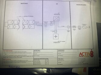

I will ask my installer but if it helps see atrached wiring diagram, test cert with cable gauges and image of AC cable well seated with 300/500V on sleeve etc
PV Inverter cutting off array sunny days IMG_8038 - EletriciansForums.net
PV Inverter cutting off array sunny days IMG_8037 - EletriciansForums.net
PV Inverter cutting off array sunny days IMG_8035 - EletriciansForums.net

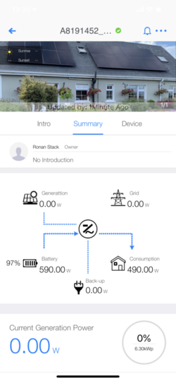

Also does the below look correct, my app shows power flowing to the grid but I would have expected this backflow to have a setting in it.
PV Inverter cutting off array sunny days IMG_8027 - EletriciansForums.net

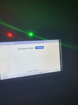

The screen image which shows 'Backflow Power' set to +0000W is odd because this it the limit set on exported PV power and it is/appears to be set to zero watts which might tie in with disconnection when the battery is 100% charged and if charging the battery is first use of PV energy ie: no battery charging and export at the same time.. Are you able to confirm from your generation meters that your installation has indeed exported power to the grid? On sunny days and low domestic load do you export? You could check this by turning off all the circuit breakers in the CU except for the one for the PV installation so any excess PV energy not being used to charge the battery is exported. Obviously best done when the battery is 100% charged if you can establish this. See 5.5.7.1 in manual.
Also, please confirm the state of the 'Off-Grid' mode see Fig 5.38.

Uklad: What inverter type do you have please?
[automerge]1598628106[/automerge]
Cable is long as inverter is one side of property and consumer unit other it also has to go up and over into attic space and back down so approx 15m.
What is the length of cable in the attic space please?
How hot does it get in the attic space on the problem sunny days?
[automerge]1598628649[/automerge]
Please look carefully at the white cable to the inverter which wends its way to the CU via the loft. Imprinted on it should be a figure in mm2 - what is it?
And what is the BS number?
Thanks Marconi and UKLad I will order one Of the monitors and set it up.
Im on a few days holidays as of this morning so away from home but will be back with more info next weekend
will be back with BS standard of the cable I just missed it in the images I sent can only see BS EN but number is missing.
I have a solis 5kw hybrid inverter
The attic doesn’t get over 27 in summer and approx 12m of the 15m cable run through it.
Uklad: That is a helpful post because it is a line of investigation at the moment - thank you Sir.

RonanIrl: I have used these plug in meters for untrained folk to check supply voltage. I need to check further but I think they report max and min values too ie: of power, frequency or voltage.
Anyway it would be a safe way for you to monitor the supply voltage and they are not too expensive. All you'd need to do is plug it in and select the mode for frequency and voltage.
