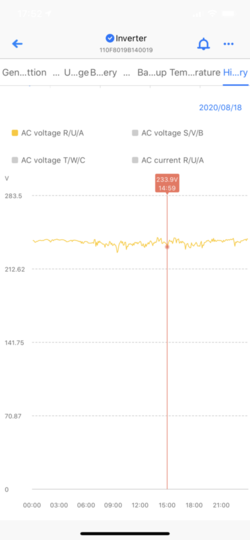

Hi guys so finally back form my holiday and the power logger was here.
Have been monitiorng it and it is reporting 235V...only fluctuates about =/- .2 either way. I know it will be most intersting to read it when the issue occurs next but thought this would be good info now as I dont think I will see the error until next summer due the weather and sun is now lower in the sky. (ony happens on sunny days in summer May-August)

Voltage meter is in place has hadly fluctuated since install more or less stable bwteen 235-238Volts. Jumped to 238 when the run was out one day.

looking back at the last time this happened see the voltage RUA (not sure what this is though) seems it’s lower than the input voltage I get of approx 235v perhaps the issue is here.

Thank you. I will ponder more on the plots. R,S,T or U,V,W or A,B,C identify which phase the voltage refers to. In your case the inverter and your home is single phase which means only voltage for one phase, phase one or R,U,A is measured. I don't think for now solar voltage rise is the problem.
The dc voltage plot clearly shows (but see my PM to you) the voltage dropping from 200 odd volts to near zero volts - this could happen if the shunt relay opens. The dc voltage plot also looks erratic but that may be the time scale selected for the plot. For the shunt relay to remain closed it requires ac power to be available on the supply side of the left hand lockable ac isolator shown in the schematic of your installation in #11. You could ask the electrician who visits on Friday to check thoroughly all the ac connections between the inverter ac output right back to and including where it connects to the incoming mains in case there is an intermittent open circuit perhaps caused by poor contact or a deteriorated contact and similarly between the shunt relay and the ac isolator - which is/are only apparent when high ac currents are flowing eg: high export/backflow power. While he is present he should also check the dc connections to the array and battery.

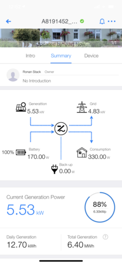

Ok so that makes sense to me but i see power being exported all the time on my app for example today I was generating 5.23, battery was full 7KW and house only using 330W, eddi hot water heater was off as desired temp was met so rest was showing as flowing back into the network. If this was the case I wuld be getting faults alonmst daily in summer as my house has a very low load of 330W and high generation of 6.3KW max =-5%.
How do i change form self use to prioritise self-consumption and export/sell surplus' as you note above
Today was a great example it was super sunny loads of power, full battery, low house load and no heating water load and the system didnt switch off..seems to be heat related as the system will turn off if its also a warm day yet no alert codes on the inverter, maybe the installer is correct they are thinking the shunt is malfuctioning (switches off at over 70 degrees interbal temp) in the attic and shutting down hence sutting off grid access for power to escape. Attic owuld not have been more than 26 today but im guesisng can get higher in summr so that coupled with an inetrnal fault on the shunt could be the problem but im not sure.

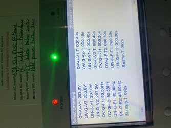

Also I’m adding below an image showing the settings for ireland Per the inverter. Note the down times for voltage over etc are only 40 seconds so seems to indicate this issue is either outside the inverter or the rules are being broken continuously for long lengths of time when the system goes down.
also see today’s status with battery full house drainage very little and export occurring on a sunny day.

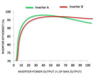

There will necessarily be a thermal gradient between the junction of the IGBT (a semiconductor power switch necessary for the conversion of dc into ac) and the the ambient air flowing of the heat sink of the inverter box. It may be then that at on very sunny days, with high ambient temperature in the loft and peak pv power generation the IGBT core temperature has been exceeded causing a shutdown of generation.

1. Re: Fig 3.3 - Meter Communication socket - Is anything connected to this socket?
2. Re: Your # 37 - the power figures do not balance. Power in from solar and battery is 5.6kW and power out for consumption and export to grid is 5.16kW - a difference of 0.44kW being apparently dissipated as heat in the inverter box - if the readings are correct. Rather a lot of thermal heating inside the inverter box.
3. It appears from the power figures that at least one of the grid power or consumption powers is being measured in order that the other can be recorded. Maybe the consumed power is being measured by a current clamp and not the export grid power. Could you have a look around the consumer unit for a clamp - no need to open it up. It would be helpful if you took some photos and post them for me to look at of your loft inverter installation, your supply metering, inverter metering and consumer unit being careful to capture the cable routes and switchgear. And also for the data logger.
