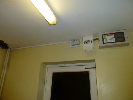

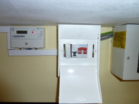

No DC isolator as SMA say the 4000 TL does not need one (has one internally). AC has one just to the right of the Sunny Boy on the loft, then cable follows siol vent boxing down to utility room. Pics below. The ceiling hole is not them! But note the lack of blank plates in the small CU (ours was full). But the good news was "they only cost 15p" - which is good to know when you forked out £10K.

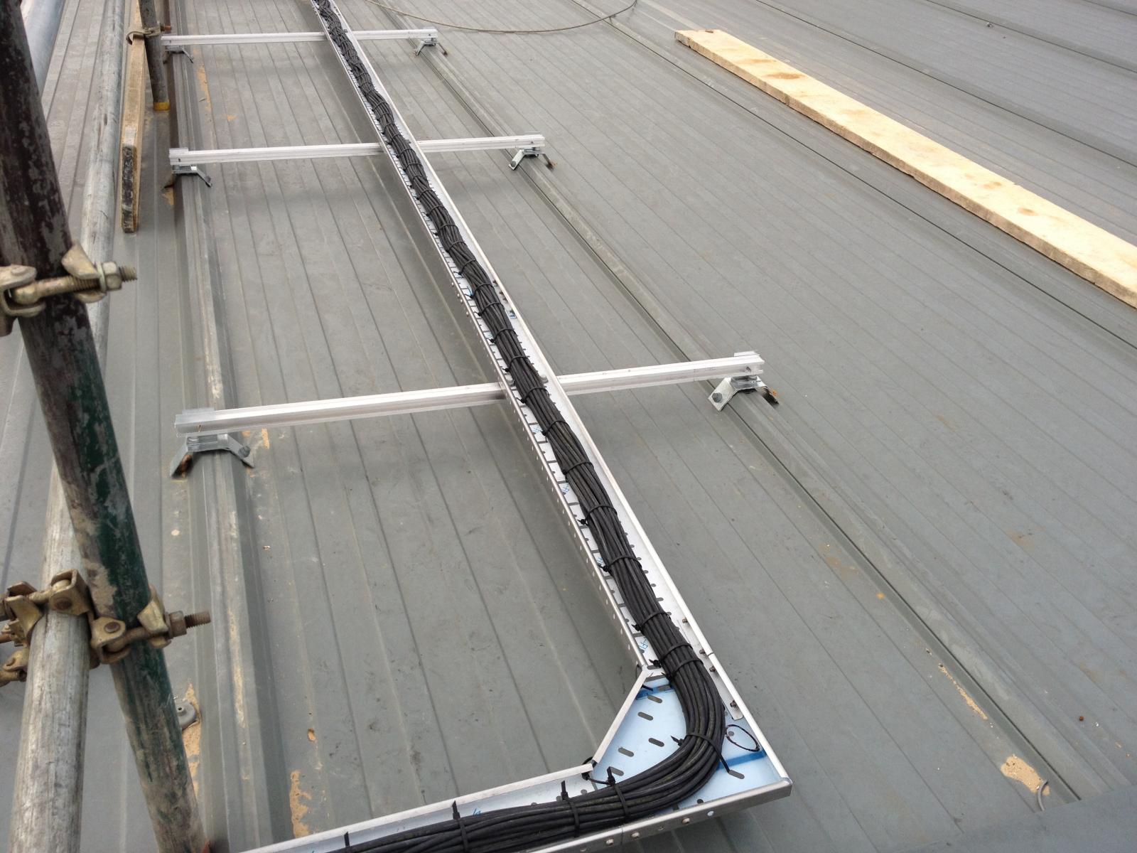

I condemned this installation that was fixed by the customers roofing contractor as it was a brand new roof and they didn't want us to screw to it - I refused to issue the MCS certificate until it was fixed to my satsifaction - we supplied the s/s tray for the roof and installed the cable, they bodged the fixing, note the number and spacing of cable ties that we put in ... if they'd let us do what we had propsed they'd actaully have had a better jobdoen in the first place and it would have cost them less - next time they'll let us do it!
We've just done the snagging list on over 200kWp for that client (which we installed in just 3 weeks :) )and the only thing he could come up with was that we could have trimmed some of our rails shorter ...

dreadful bit of trunking work as well!!
strictly speaking the innner insulation of the cable shouldn't show. Thats more a reflection on the shabbiness of the trunking. how hard would it have been to get it to butt up against the meter!?

I can't see the DC isolator but you aren't allowed to have cable suspended from the screw terminals so if they haven't used compression glands and/or clips thats another breach.
