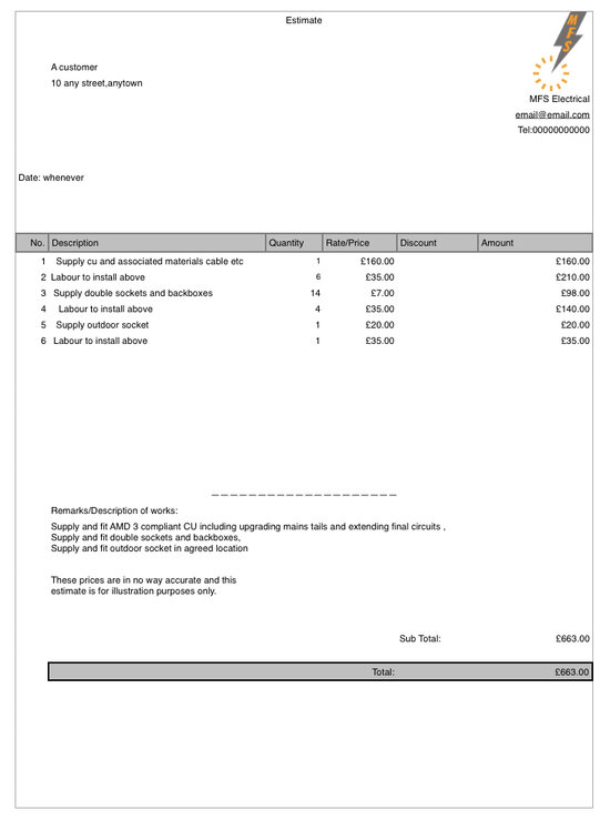

I tend to mostly use estimates rather than quotes that way if anything unexpected crops up I have a get out and don’t need to run at a loss. I do tell the customer if anything crops up that will change the price and I’ve only ever had a problem with one customer complaining about me changing the price from my estimate but I pointed them to the Ts&Cs on my website, which they should have read beforehand as stated on the bottom of all my estimates/quotes. I’ll post up a mock estimate so you can see how I do it now. See if there is anything I can improve to make it go a little quicker.
This isn’t the current template I use to deliver estimates it has changed a little since this one was introduced but it was the only one I had in my phone it still looks pretty similar to the one customers get now and you can get the gist of how I convey the price. Also editing this template is a pig on the phone and that’s why the lines are all over the place it isn’t what it usually looks like, honest.
The prices within are completely made up and do not reflect in anyway, any real pricing of MFS Electrical.
This estimate is for illustration purposes only and any reproduction is forbidden except where permitted in writing by MFS Electrical.
Again, the prices within are totally made up and do not reflect, in anyway, any real pricing of MFS Electrical.
This estimate is for illustration purposes only and any reproduction is forbidden except where permitted in writing by MFS Electrical.CD529A3D-BC74-44E1-A438-46B6C85F1194.jpeg
I’m thinking of changing to the second one because it will save a bit of time on each one so it will be somewhat similar to @essex and @MDJ ‘s quotes/estimates I do like to let the customer know how much materials are Vs how much labour is but it is getting quite impractical. I do think though that there are a few higher value jobs that I wouldn’t have got without breaking things down as with the first one, As quite often the customer can be shocked at the overall price... especially with higher value jobs.
Excuse the disclaimers it’s not that I don’t trust my fellow forum-mates. I just thought it would be prudent to include them as this is a public forum:rolleyes:
