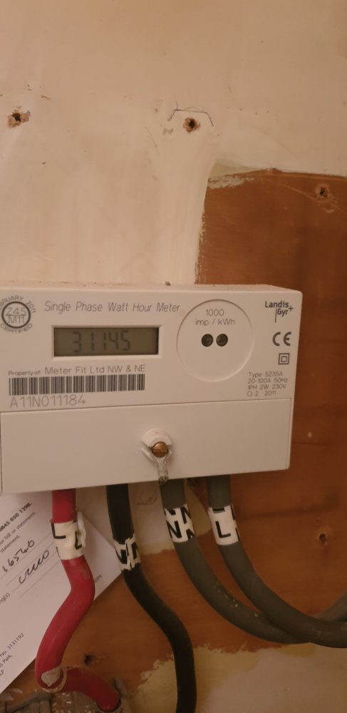

I have attached the picture of the meter.

If that is a picture of your meter then the problem is that there are no cables connected to it.

I am only concerned now that they will accuse me of tampering with meter due to RED message on meter.
Just wanted to understand whether someone else had a similar problem.
never did shy away from paying bills but want to pay for something I owe.
RED usually means redirect, but as you say there are no solar panels, it’s a mystery.

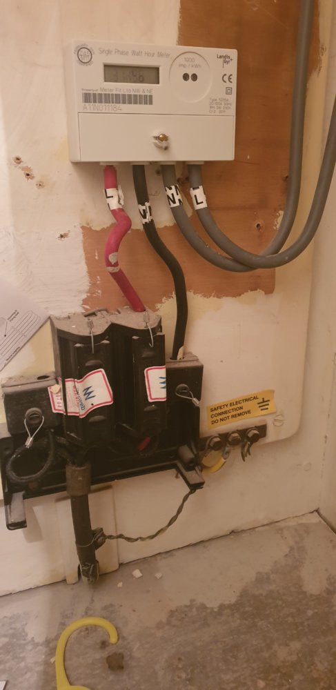

Can we get a photograph of your actual meter? With fuseboard and any suppliers cable you can see. From that we can probably advise much better.
RED is the code for reverse energy detected and is a feature to show if the meter has been connected backwards . It will also occur on PV systems when energy is being fed back into the grid .
I suspect if there have been no readings for a while and you are new to the flat ,you are paying for the previous occupiers usage . £100 per month on leccy is well steep, unless you are in the cultivation business
Sorry mate, but can you show a photo where the other end of the cables go to from the meter? One way will go to the supply cable/main fuse, the other to your distribution board, possibly via a big red switch.
I think the grey cables HAVE to go to the dis board. The red and black coming from the supply are in the right place, so it’s not, as some thought, the meter connected back to front
You could try switching off the power at your consumer unit (fuse box, big red switch normally) and then check to see if it still indicates a reverse flow on the meter. If it does I would request a meter change from your supplier.
The solid conductor helps a lot, and the high CCC of MI. There should of course be a lid over those MICC wires that is now missing.
