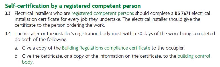

As per Part P of Building Regs, once electrical work is performed by a registered competent person, the installation certificate needs to be given to occupier and also to building control.
How does the electrician give this to building control? Email? Post? Do they confirm receipt? Do they issue anything in return?

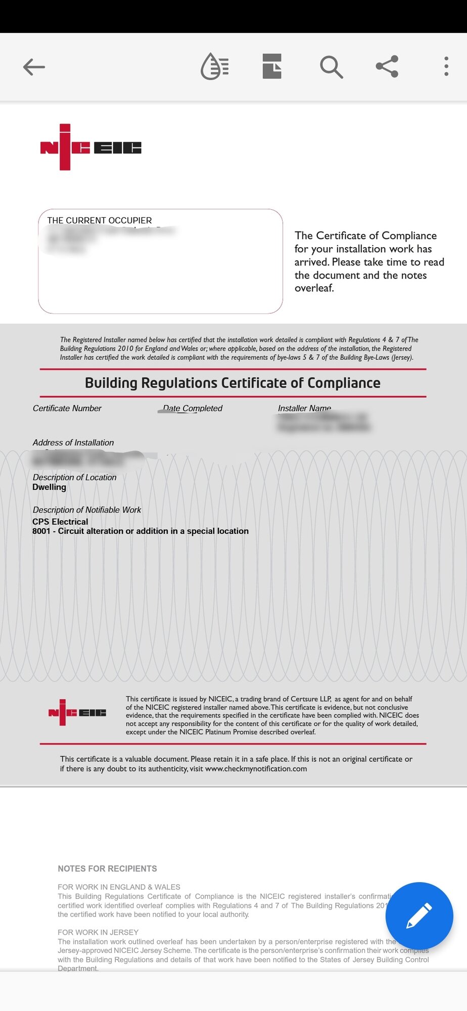

I notify online through my scheme, download a copy of the LABC compliance certificate, and then email to the client with the EIC.
You don't give a copy of the EIC to building control, that's not required by part P.
In the excerpt from part P you attached to your post it requires you to give the EIC to the person ordering the work
And then a building regulations compliance certificate (not an EIC) to the occupier and a copy of it (or required information from it) to building control.
The building regulations compliance certificate is the document that your part P scheme produce and send to the relevant people when you notify the job to them.

Napit emails them to the client directly unless you tick the box that asks for snail mail, in which case they post them.

3.4.b above isn't referencing the EIC, it's referencing the BR Compliance certificate - which is what you pay a scam for.
No, it is not. It's just certificate with all the test results, installation details and inspections. Compliance certificate is 1 page document stating details of the installer, installation address, eic number for this installation, date of which the work has been completed and description of the work

The scheme notifies building control, and the member and the customer get a completion certificate.

3. The scam tells your customer you've done a good job and sends them a Building Regs Compliance Certtificate
4. The scam tells the customer's postcode Building Control that you've been there and done a good job, sends them a copy of 3.
