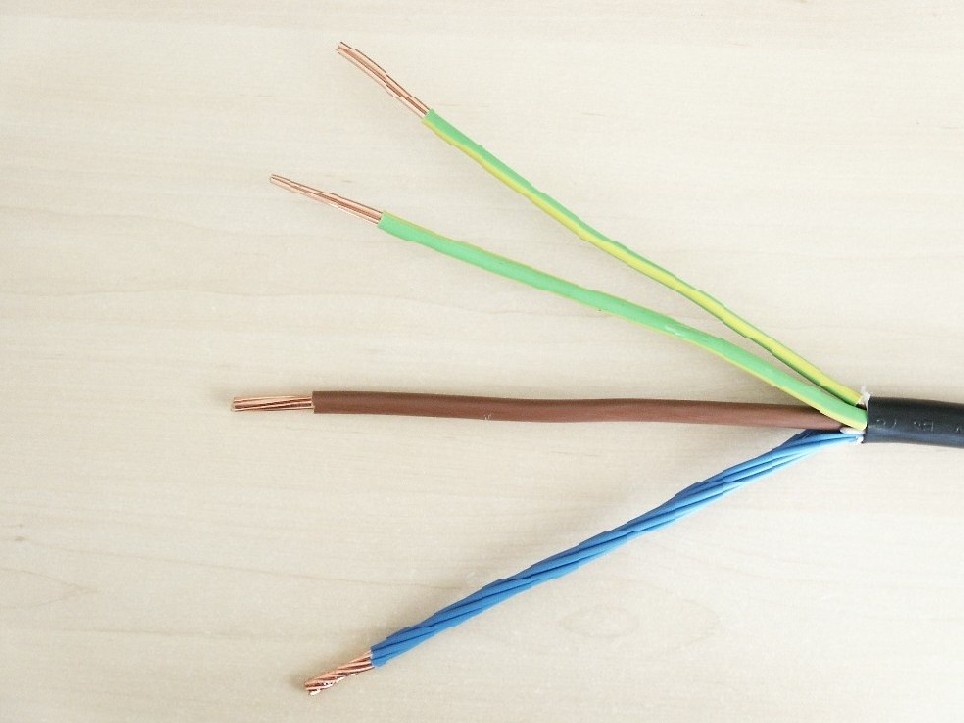

because the insulation covering the neutral strands is a quarter of the thickness of the live core and can be stripped off with a nothing more than a fingernail - ie , its very thin & weak in comparison.
get a piece and strip it as youve never terminated the stuff. ;-)
OK, I will! If someone would like to give written instructions on how it should be done, I'll happily get the bits in to do it, give it a first go with pics, and you can all peer review!! See.....got big ones, me. ;)
Reactions: 3 people
its a doddle.....
strip back outer pvc and inner clear selophane wrapping to reveal thus.........
twist together neutrals into 1 bundle & sleeving over earth strands
heat shrink pvc boot can be inserted over the base of cores if youre feeling flash
and cable entry is nothing more extravagant than an IP stuffing gland & shroud.
Reactions: 4 people
its a doddle.....
LOL - and here was me thinking I'd be needing to get the spanners out!! In which case, I think I got it covered. :cowboy:

its a doddle.....
Personally I would have put a heat shrink on the both the CPC and neutrals, then tightly bind the crutch with amalgamating tape.
To tape the crutch properly the CPC and neutral have to first be layed at 90° to the line conductor. Each set of conductors twisted to the natural lay of the cable and then heat shrink applied. It’s a good idea to also heat shrink the line. Tape up using ½ lap to form a tight seal.
Looks mint and is a dammed site smaller than a heat shrink boot.
