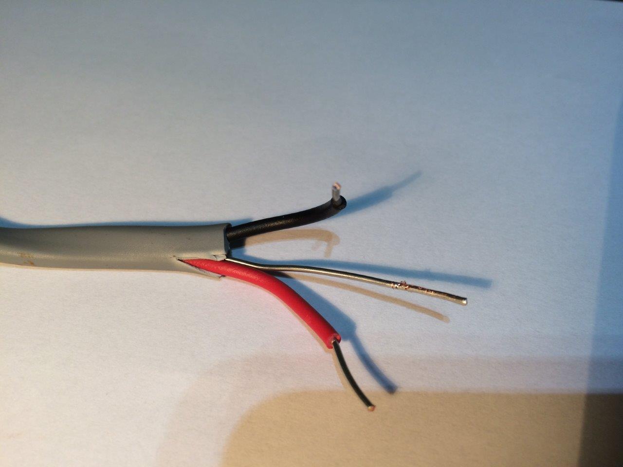

Here's some I came across;
It would be interesting to know what if anything is embossed down the sheath. The construction looks like metric but the voltage rating or BS No. might confirm or deny this. Actually, what I haven't given in the above is a definitive way of distinguishing the standard to which the cables were made, for these 'crossover' examples.
Do you have enough of that to hand to read what it has to say, and/or send me a sample for the display?
Its in me scrap pile :eek: I'll see if I can dig it out!
It is embossed with;
BICC GROUP PRDUCTS - 250/240 VOLT - TO BRITISH STANDARDS - MADE IN GREAT BRITAIN - H ''Y'' TYPE
If you PM with the address you want it sending, your welcome to have it.
It's a pity they didn't say which standards! I will have to get out my BICC 'Cables and Tables' booklets for this era and see what info they offer. I'm not sure whether the 300/500V grade became universal on T+E with the arrival of BS6004 in 1969 but suspect so, in which case this would be an imperial cable despite the sheath dimensions and appearance being similar to 6242Y. You've got a PM.
