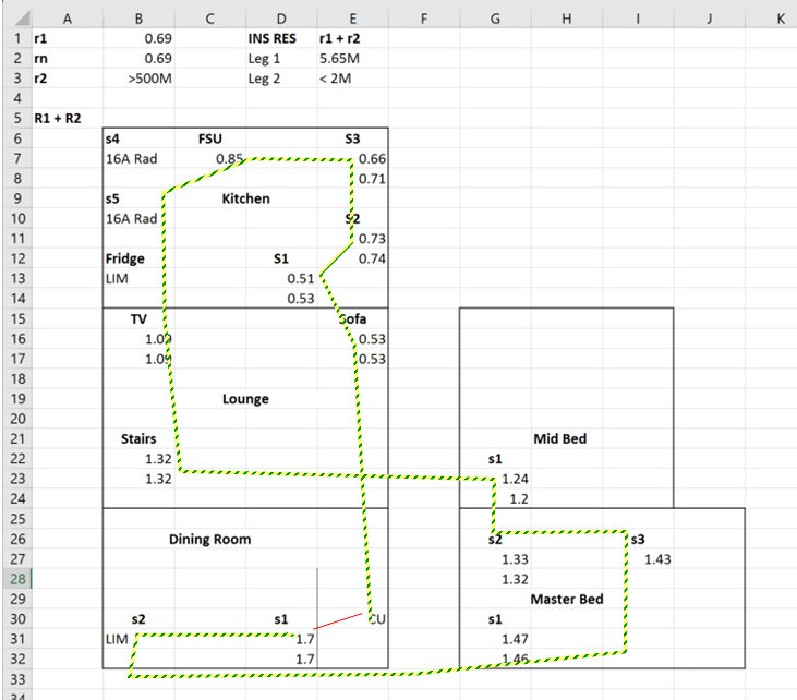

I have a 32A Final Ring Circuit that I have swapped a single socket to a FSU for an outside light. I'm now testing it and finding it has a discontinuous earth - I'm also kicking myself for not checking from the off but we learn. Anyway from the attached image you should be able to see my results arranged in a rough layout of the property. If you were looking for a DE where would you start?

Not quite sure of your explanation (of the fault), but from your end to ends looks like there is a bad connection on r2 (>500mOmhs)?
Is the dodgy socket s2 in the dining room?
disconnect the cpc's from the CU, then with a wander lead, go from one leg end round the sockets. when you run out of readings, then do same for other leg. the fault will be between the 2 sockets that have o/c readings.
Assuming the values given on the plan are Zs readings then having 1.7Ω in the dining room that close to the CU would indicate to me that you are measuring the resistance of the cpc over the length of the ring so the expected disconnection would be from CU to S1 (possibly S2) in the dining room.
Theoretically from the readings at a glance the ring would be laid out like the below diagram.

At the board connect live and cpc of one of the legs. Measure R1+R2 at each socket. At some point you will get 'open circuit'. Repeat for the other leg. It may help to to draw a diagram, as you go and note readings. You should now be able to narrow the fault down to a couple of sockets.
I had to read this twice but what you are suggesting is like the fig8 tests which I've done but on 1 half of the ring only! Good call. Wish I had known that when at the property - I didn't think I could do anything because I didn't have a long lead with me.

Hi Richard,
That's really helpful. Thank you. They are r1+r2 fig8 results. So, if I understand correctly, the low values I see in the Kitchen are because they only have one short leg from the CU and the 'return' journey via the dining room is open circuit. The LIM at s2 is because its behind a large dresser.
