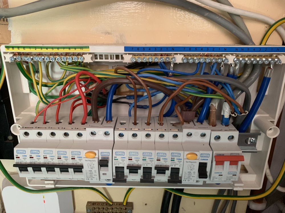

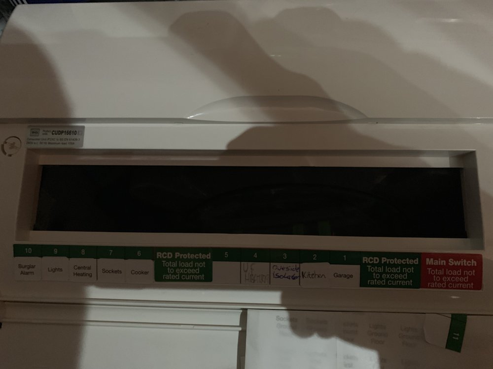

Some internal pics at the fuse boards would be good.
The tripping you describe sounds like a N to E short on one of these new circuits. If that is the case it should have been found by testing before anything was energised; disconnecting the new cabling will have removed the N to E short.
Top one is before I disconnected (obviously).

Did he just install a supply cable to a garage that was already wired or did he wire the garage as well?
Both.

I’d take some pics but my lights don’t work ? cable is fed into consumer through a rubber/plastic gland and again no earth.
