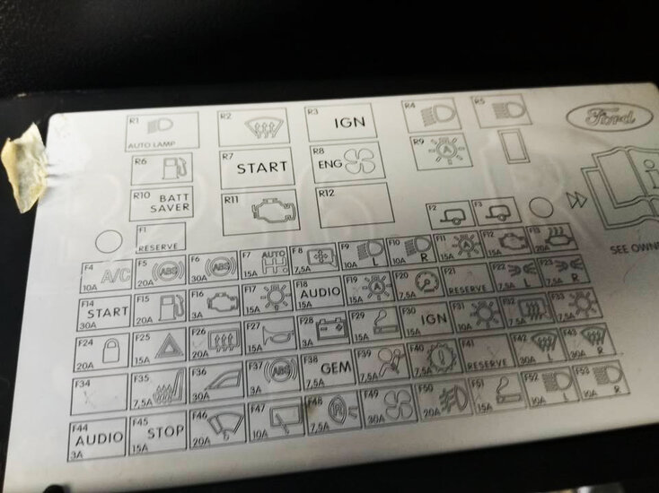

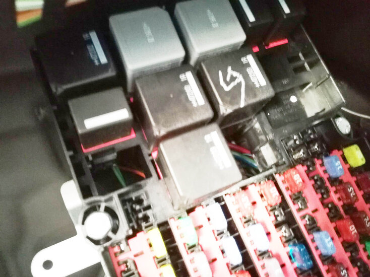

Here's the fuse box diagram on the back of my glove box, note top left of the diagram, slot R10, battery saver - you'll notice the actual relay module is missing on my car
Oddly all of my interior lights / clock / displays all work as they should even with this missing
Could this be the cause of my mystery drain? I've pulled most of the fuses out and nothing seems to stop this drain

I think the battery saver socket is for a relay that automatically operates several minutes after the ignition is switched off in order to turn of internal items that may have been left on by accident. Not sure exactly which items but usually interior lights, glove box light, maybe boot light etc. The battery saver....or lack of it won't be causing the drain.
