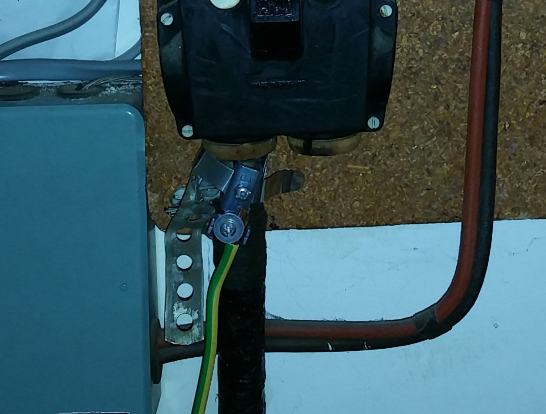

Hi All, got sent this pic overnight by that chap who wants a quote for CU change in Slough. It looks a bit diy to me. Your thoughts appreciated please, ok/not ok, DNO likely to fix charge/no charge. Should be SSE area. Cheers :)
Looks like someone has used a BS951 earth clamp. That is not good. It should be a constant compression clamp. Unfortunately I am not sure if the DNO will do anything about it but if they do, they might well charge.
Jay
Your problem is you will need to make a new earth, and if it is from there you are in a bind. You can't make off an earth to replace that bare earth going into the Falks CU. So I would advise the client the DNO will have to make good the earth. Having phoned them first and got a ballpark price adding no doubt £200-300 to the cost. And there is no warning on the 951 clamp which as stated (as I am sure you know) is not on at that position. And of course we can't touch it.:rolleyes:
It looks like the earth was originally supplied by the DNO so they should maintain it, however it also looks like the earth was deliberately removed and that clamp installed instead so this could be considered deliberate damage and so they would charge to repair this.
However they are likely to do the job, only at a cost.
If you can crimp onto the remaining strands then this may be OK but it would need site assessment to be sure.
I think the original DNO is there you can just see it peeking out and going into CU and you can see the original clamp/screw securing it.
Good pick !
Likely because there was no MET external to the CU someone's done a bit of freehand bonding direct to the cable. If that's so, it won't be too hard to fix, but I take Murdock's point as that's just the first thing :)
I'm also in the SSE catchment area, always found them to respond to things quite quickly, and coming out to have a look. But I suppose that might be down to my local depot. Always have to ring the call centre first, and then local depot calls you direct.
I'm guessing they will rectify that FOC, if it's just the clamp.
Edit; See now that the CU doesn't appear to be connected to the 'earthing facility', but least the gas is bonded!
I had a similar one years ago , it was sparking under test though.
They came out within an hour and replaced it free of charge with a constant pressure clamp.
is that gas bond the wrong side of the meter?
Let us know what they say!
SSE chap has reviewed pic and suggests on site safety check by one their engineers (arrange by calling 08000727282).
On the lighter side - I was told initially to get an Electrician in to fix it, but I said @Pete999 lives too far away so she put me through to their tech folks who were keen to see a pic, just like us :)
That perforated strap is the original DNO clamp onto the lead sheath, the 951 is a later bodge.
If the 951 is removed you can fit a lug to the screw which holds the original strap clamp together.
