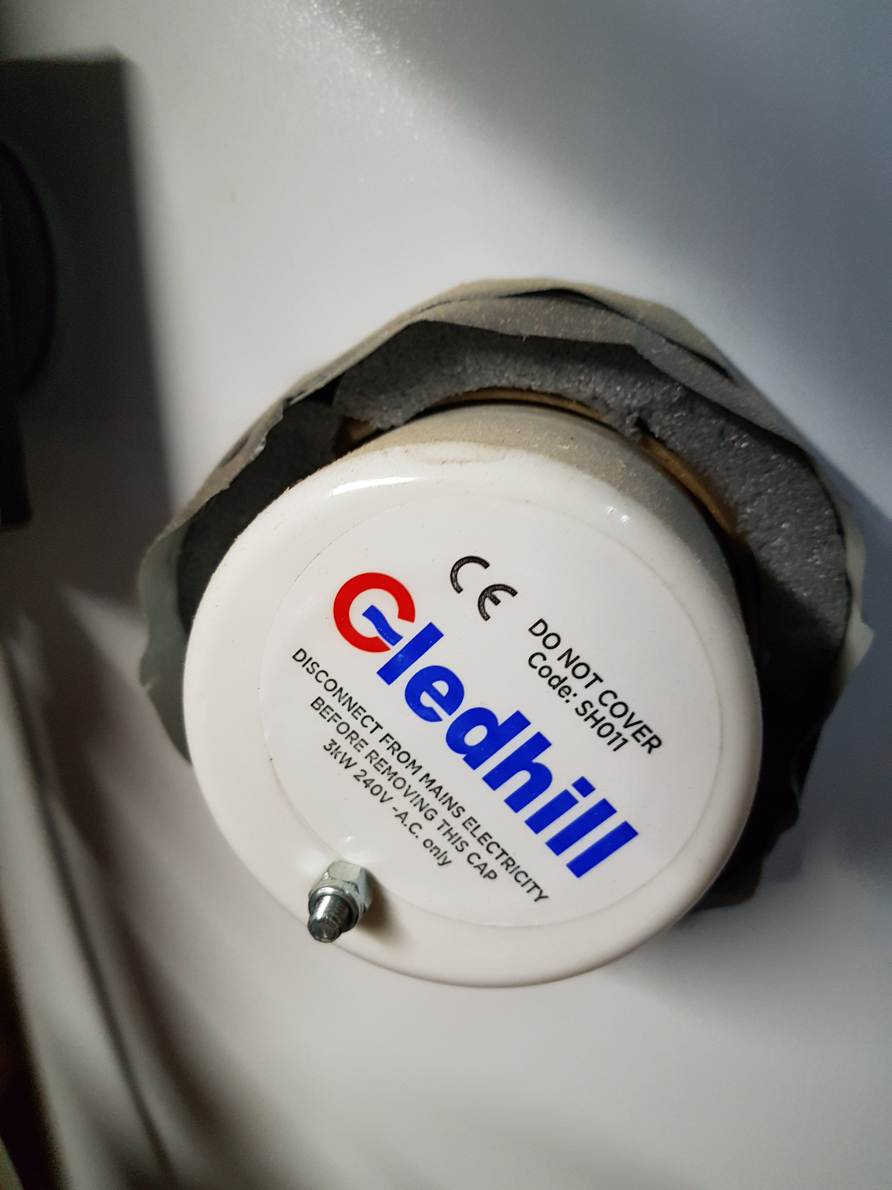

I have a water cylinder to get power to.
The product is a gledhill stainless lite 'indirect'. The manufacturers data sheet says for use with gas or oil boilers. The sheet says the 'direct' model has 2 x 3kW immersions. However from the plate on the side of the tank (see pic) and the tank itself you can see that this model the 'indirect' has 2 x 3kW immersions as well. Even though the data sheet says it has an internal primary coil designed for use with gas or oil.
My questions:
1. How can it have 2 x 3kW immersions requiring an electrical supply and only be used by gas or oil?
2. Will both immersions be used at the same time?
3. Does the electrical supply to the immersions need to incorporate a timer switch or are they just fed from a FCU?
4. If they do need a timer switch would it be one timer for both immersions or one for each?
I'll be chatting to the plumber tomorrow but I just wanted to have a little more knowledge beforehand.

Normally if its an indirect cylinder the immersion is only there as a backup for when the boiler breaks down.
So normally just supply the bottom immersion via a DP switch, don't do anything with the top one.
It's more normal to see a blanking plug in the top immersion hole when it's being used indirect. I think they are all supplied with two immersion positions regardless because it's cheaper to manufacture everything identical than make two variants.
Agreed, lower element is the main deal if used as backup. But if flexibility is wanted, the upper element gets you hot water faster because it mainly heats the water above it. Traditionally there was a selector switch marked 'Sink' and 'Bath', only one element was used at a time. But there's no reason not to use both for speed if the supply allows. Or, cheap leccy on the bottom element used only at night to provide a full cylinder by morning.

As has been said, its to allow flexibility of application without having to manufacture tens of variants.
The positioning of the elements Vs the indirect will be influenced by the internal coil location.
When wiring these up in the past, for use with heat pumps, we only used the lower element.
If you ask the plumber he'll go for the belt amd braces option, but if its his call let him make it.
Historically in the days of night storage heating I have seen tanks have two elements , the bottom one being used at night on the off peak tariff.

Wiring two supplies is just a waste of the customers money in my opinion, its a backup in case the main heating system fails.
If it is ever actually needed it's unlikely to be used for more than a few days, and modern tanks like that only tak ehalf an hour to heat up on one immersion anyway.
Plus if the heating system is properly installed and maintained the immersions will probably have developed faults from being stuck in water that long before they are ever used.
You can ask the plumber if you like, but ultimately its up to the customer how much money they want to spend on a non essential circuit theyay never use.

The 2 elements are for either a Bath / Sink switch or a dual tarrif set up.
For Dual Tariff the bottom element is connected to cheap rate and the top element to 24hr.
The top element then provides a top up to last until the cheap rate kicks in at night.
Bath sink is either the whole tank, bath, or just the top section, sink.

If it was a direct cylinder then yes, but it's not, it's an indirect cylinder so the main source of heat is the boiler, the immersions are purely a backup should the primary heat source fail.
That is the most likely scenario granted.
Sometimes the indirect part of the cylinder is connected to a stove not as the primary source of heat but as supplementary heating.
I have also come across customers who switch off their external oil boiler in the summer and just use the immersion.
I'm not sure whether it makes economic sense or not but it's what they do.
