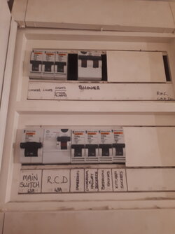

My RCD switch trips at the most unsual times, it will trip at 3am (no electric items are plugged in bar the kitchen appliances) then i will reset it and it will trip again at 10pm the next evening. It also tripped at 7:15am this morning. Electricians have been out and tested all my sockets and ive unplugged my fridge and washing machine for a few hours to see was it them and the RCD still tripped. I have no clue what to do next. I asked them to test the appliances but they dont think this is necessary. What else can i do?
You say "my RCD switch". Do you just have one RCD covering all circuits?
Pics. of your consumer unit/fusebox would be good.

its just the RCD switch that trips, none of the other fuses trip. Electricans have been here and they have tested sockets and the fuse board. They said all were fine. I dont know what else there is to do. The RCD just trips randomly for no reason. I dont know a lot about this but everything has been checked and the RCD still trips. I thought it was faulty wiring but i was told this wasnt the case either.
First of all, no real electrician would leave that fuse box as it is in the pic. The missing blanks in the top row mean that it is regarded as "an immediate threat to life".
Is it just the bottom row that loses power, or is the top rom connected through the RCD as well?
What country are you in? The type of board you have is available in the UK, but would be very unusual.

I live in an apartment so i dont have any outside lighting/sockets to worry about. I suggested the electricans look at the cooker wiring and lighting but they just said the RCD doesnt control either of them. Also when the RCD trips the oven and lights still work so they ruled them out this morning. My immersion is never switched on because my water heats up from my heating system.

I live in Dublin. No fuses in the bottom row trip, the only one that trips is the RCD switch.

I don't think we really need the drama of a few blanks missing.

Really? I was slated a couple of days ago for not reporting similar to the HSE.
We have a situation here where the OP is regularly accessing the box, and as far as I knew at the time, could have been accessing it in the dark.
There's also the matter of what looks like an overloaded main switch and/or supply.

im not sure its overloaded as all the fuses have been tested more than once this week and it all came back clear. None of the other fuses trip. Its just the RCD thats the nuisance. (The top row i never have a problem with)
