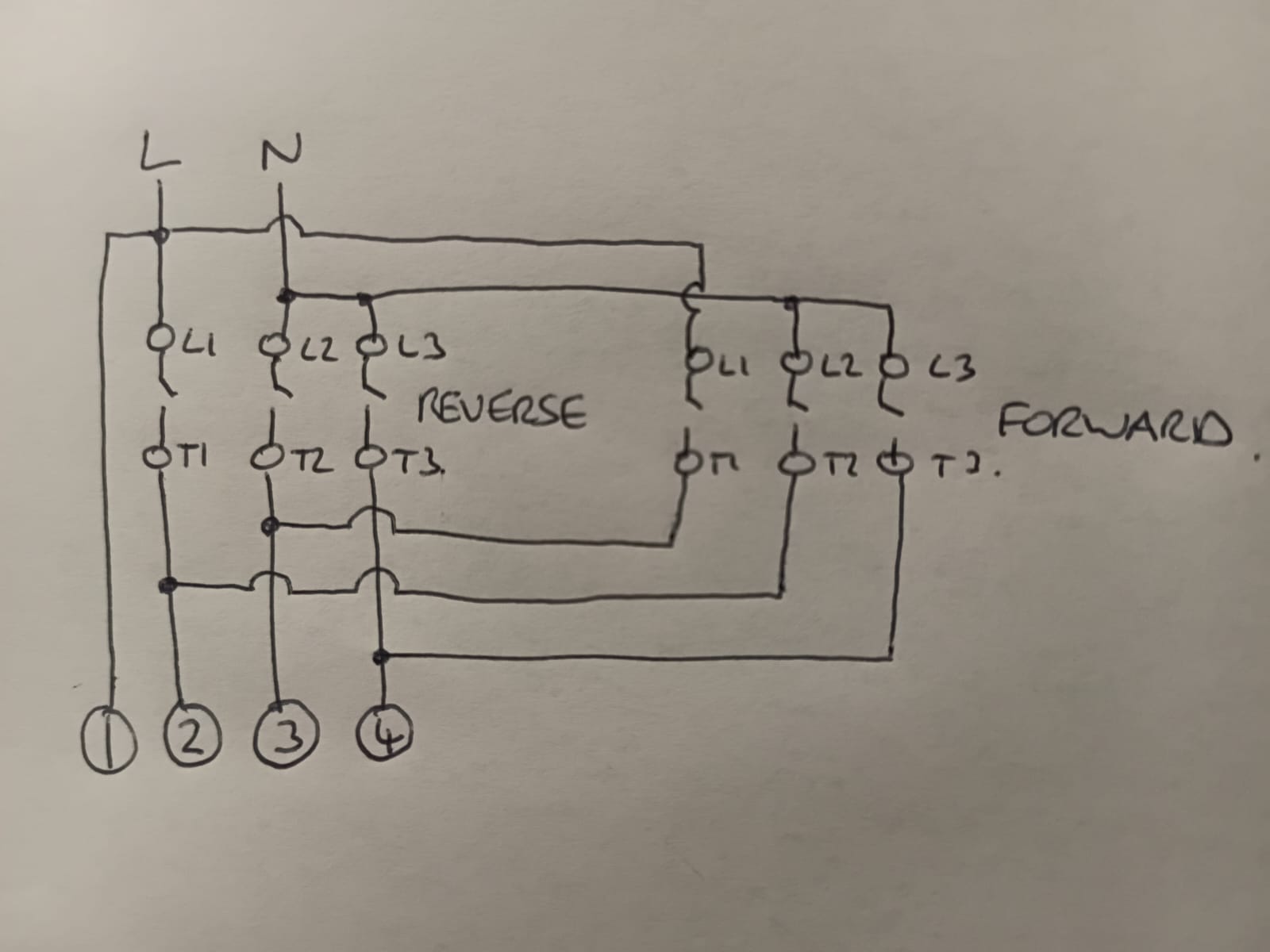

I have now sourced a reversing contactor arrangement that has all of those features, however I have realised that with the 4 wire setup to the single phase motor, 1 wire will bypass the contactors and be permanently connected (this could be L or N I guess as 2 of the 4 wires are permanently L & N respectively whereas the other 2 switch polarity depending on desired motor direction.) therefore also bypassing the overloads.
Question is , for a single phase motor such as this, do both L & N need to pass through the overload or just (for arguments sake and most likely) just L? . If both I guess I need to find a 4 pole overload as a standalone (not hanging off T1-T3) or put a 3 pole standalone upstream of the contactors? If only L needs to pass through I can stick with the arrangement I have.

Thanks for this. I am aware of the 'looping back' practice and have also used a standalone overload relay before however in this case I'm not sure it would help unless I put it upstream of the contactors. I'll explain.
The new contactor arrangement is shown in the photo and the diagram shows the 4 wire setup to the motor as supplied from the factory.
wire 1 is L bypassing contactors going to start winding
wires 2 & 3 are switched polarity for main winding
wire 4 is always N going to centrifugal switch
capacitors are permanently connected to switch and start winding.
The new contactor arrangement has overload relays fitted to outgoing terminals as per pic so if I wired it the same as the diagram the full motor current would pass through 1 or other of them depending on motor direction via the neutral conductor so they should work but of course wire 1 is permanently live to the motor and would remain so in all states unless isolated at upfront isolator I plan on fitting. I feel this is sub optimal. I could of course change the wiring to the permanent neutral (currently wire 4) being the conductor that always remains 'live' at the motor and switch all the L's through the contactors but not sure that is really that much better.
The contactors I have sourced are very cheap compared to other brands which is to satisfy budget remaining on this project and those thermal relays were the only type I could find in Chint's catalogue, also I can't seem to find a 4 pole standalone of any make to put all 4 wires through.
Can you suggest a better solution? I need to get this done now and I'm running out of ideas!!

Whether it actually has any effect on the tripping characteristics, I have no idea.
It has a big effect in so far as it will trip after a short period of operation if current does not pass through all 3 poles if the overload. I learned this as an apprentice when I connected a single phase motor through just 2 poles of the 3 pole overload.
The overload relay also trips on imbalance of current through the poles.
so my arrangement with the 1 L wire not passing through the overload(s) won't work you reckon?
Can anyone link a diagram of single phase reversing contactor arrangement with overload, I can't find one anywhere and as you can see am struggling to work it out!
I wouldn't have thought so as the current through the overload won't be in balance.
I don't know how it's normally done with reversing an SP motor but I'd be inclined to put an MPCB before the reversing contractors rather than use a thermal overload on the output.
Or just buy a complete reversing starter and use that
this sounds like a reasonable idea , must admit I have never used one before so I'll look into it, Thanks
couldn't find a suitable one or I would have done, anyway too late now have bought the quality Chint gear!
