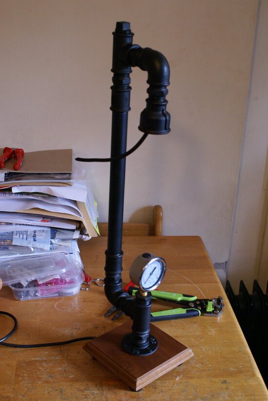

Thanks to all for your replies. Sorry if I wasn't clear with my description. Probably best if I start again and with photos.
I'm making a table lamp out of plumbing pipe. It's 3/4" bsp malleable iron.
The flex is entering through the bottom of the lamp (3 core x 0.75mm). I was initially going to use a lamp flex kit that had a molded plug and inline switch already connected. But because of the distance that the flex has to run through the pipework this probably won't be possible because the switch is too close to the actual lamp etc. This was why I was initially trying to extend/splice the cable

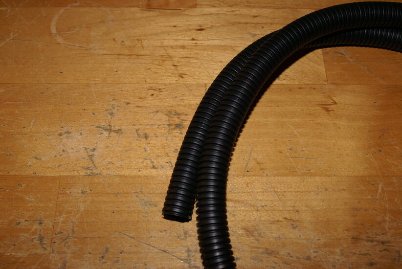

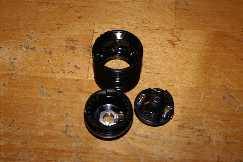

I have lined the iron pipe with corrugated plastic conduit for added safety. The actual lampholder is plastic and has an earth terminal in the cap. I'm wondering if I make the connection to the earth terminal in the lampholder will this be enough or will I need to earth the pipe body as well? If I do what would I use to do this? (Please bare in my mind I'm fairly new to such things).
Thanks for your help guys, really appreciate it.
I like it! are you using LED lamp? might consider heatproof cable. I think I would drill though the pipework close to the lampholder thread it and put a small nut and bolt of the right size and clamp a crimped lug/earth lead to it and attach other end to the earth terminal in the lampholder. The earth lead going internally to the nut. As the metal would be bare inside I presume?
I'm using Edison style filament bulbs. I think on reflection I will try and attach an earth lug to the pipework like you suggest. Could I use any small nut and bolt for this? Is there a specific name for heatproof cable? If I'm redoing the wire I may as well make it uber safe.
Glad you like it. Thanks again.
Yes you have done a good job, how are you fixing the lamp holder to the pipework. If you can put in place a thread it will earth the pipe through the thread with the earth to the earth terminal of the lamp holder. I am impressed.
The lampholder external thread screws exactly into the pipe socket on the lamp head, a happy coincidence. I'm not quite sure if I follow. I'm probably being dense
Just connect the earth to the lamp holder earth terminal job done no need for anything else as this will earth the pipework as well.
I like what you've done, great idea.
I think you may need a pressure gauge that is rated up to 30bar though as it is electricity and safety is always first!
Post a photo of the finished product.
Did you have bits lying around or did you buy it all, what's the bill so far?
The pressure gauge is only for show and isn't connected to anything. I'll certainly post pictures of the finished article. Got more elaborate ones planned.
All new parts. Probably runs to about £50+, especially allowing for my adventures in wiring
