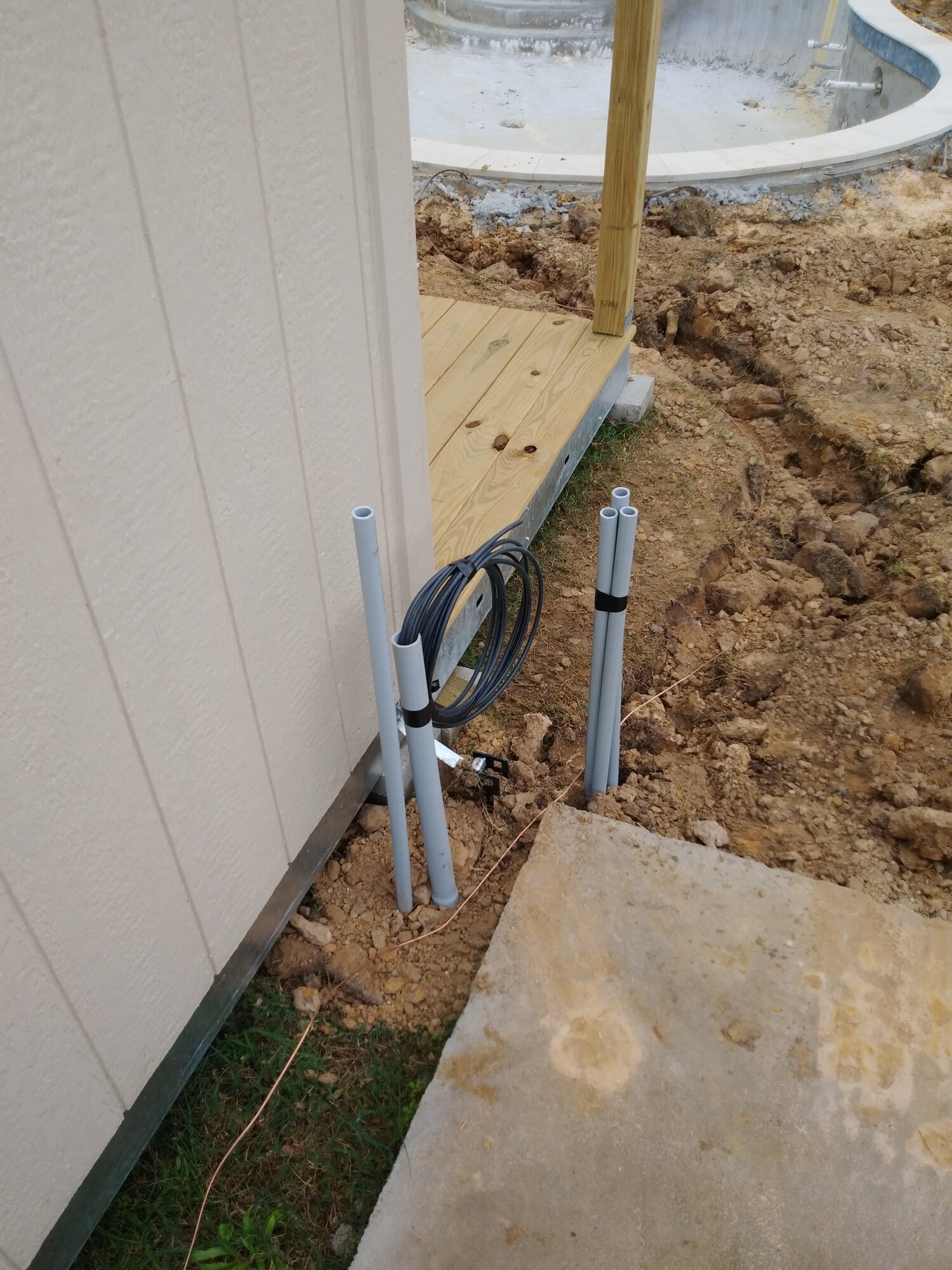

The conduit and wires for the 100 amp panel are run to my main panel and to the outside of the pool house but are not connected/terminated. The conduit runs are cut off and the wires are just coiled at each location.
I completely understand how to terminate these ends into the panels.
Its the power for the pool pump, the dedicated 20 amp outlet that is required, and the three 1/2" conduit that are going to have the led lighting wires that I'm not sure how to terminate.
Will there be 1 hole through the shed wall with a junction box and maybe din rail and terminals to supply power to these three separate circuits.

Here are some pictures of what i have right now.
I do have the panel mounted in the shed and a 100 amp backfeed main breaker installed.

I looked at your pictures and I see what you are talking about. The feeder pipe just goes to your building just drill one 1” hole and then your pull the feeders that goes through the wall of your pool shed and go ahead and terminate to your panel. I’m seeing 4 pipes left that I’m going to assume is stubbed out from the inside of your building where your sub panel will be installed. Have you installed a ground ring around your pool which should be # 8 bare copper wire for the metal parts of the pool to be bonded to ?
The four pipes that have no wires are 3 for the pool led lighting that are trenches to the pool and the single 3/4 conduit is for a 20amp circuit that will run from the sub panel in the shed to my garage which is attached to my home. I chose to do that circuit from the sub panel purely because it looks nicer to trench underground from the shed than it would have to run from my main panel on the opposite side of the house. The house is on a slab. No basement.
The #8 ground ring is installed around the pool.
Another problem is the conduit that was run for service wire ended up right in the middle of a stud on the shed wall.

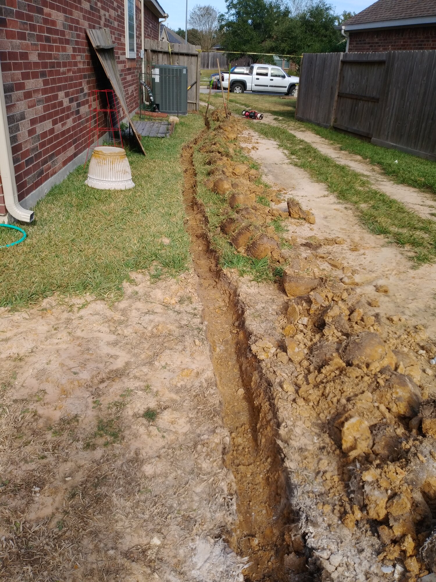

Here is a picture of my main panel and the distance to my pool shed. I'll also attach a shot of the trench from the shed to the garage.
I'll try to get another shot of the installed sub panel in the shed tonight after work.
