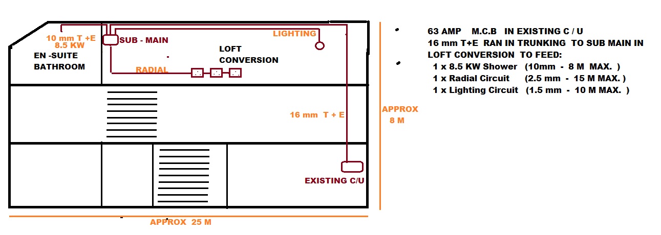

Just wondering if any sparks out there would have any obligations or concerns about a proposed installation for loft conversion,, ( see drawing for details..)..
Hear loads of conflicting theories about cable sizing for showers , some of them are borderline at best... and different installation methods etc... this is my proposed method, might seem a bit overkill.. but seems to tick every box regarding cable sizing , length of run,,, installation method ( in trunking..).. and diversity.. I'd rather be well clear of borderline to be honest...
Quite a big House.. concerns with the run to the opposite corner for feeding the shower... Didn't really fancy terminating two lots of 16mm in a shower pull cord switch to be honest,,, 10mm can be a nuisance at times,, I hope this method would satisfy every criteria..??
plus- gives ample scope for upgrades of showers in the future if you use 10mm,,
I have never used 6mm for a shower ,, EVER,,,, asking for trouble...
there's thousands of showers out there asking for trouble then. 9.5kW = 40A. 6mm ccc is 47A. what's the problem?

It is nearly always down to poor terminations not 6mm cable.
There's no such thing as "pushing the boundaries" in a compliant circuit. Either a cable can carry that amount of current or it can't. I think you will find that stated values err on the conservative side too. I have seen showers fed in 2.5mm cable that have not caught fire.

That's what your calcs are for. I trust them as I know they have a small margin of error built into them. I also know from experience that appliances don't always pull what they state, and that cable can take more than it is rated at.
As long as your calcs are correct you have them to back you up.

It's got nothing to do with diversity mate. A shower is a single item of current using equipment with a fixed load. No diversity applicable.
This is about the relationship between I[SUB]b[/SUB] and I[SUB]z[/SUB], and in this situation, I[SUB]n[/SUB] doesn't come in to it other than selecting an appropriate method of short circuit protection (I[SUB]a[/SUB]). Think about it :)

The question is why would you not protect a 6mm with a 50A mcb if the rating factors permit for the Ib?
You are not coming across as being mr safe here, all you appear to be doing is wasting your customers money on unnecessarily oversized cables.

Shower pulls 45A, cable is good for 47A. Ergo sum: cable is more than sufficient for the job in hand :)
16mm T+E for Loft Extension, (en- suit shower. )
