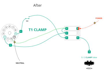

I have tried to add switches to the diagram and fleshed out how important the Sensor is to the sequence. I haven't had a chance to use the Multimeter and validate this. But in practice (from me using the machine) this is how it works. I've colour coded the T1 and T2 so you can see the exact pin number that goes to the solenoid valves. This is becoming clearer each time I iterate :)
Heating ON and Auto Mode ON
To begin Auto sequence press Button LEFT & RIGHT at the same time. While held power is directed to T1 CLAMP and the Clamp Valve. Once the Sensor CLAMP is engaged you can depress the Buttons. Power is now directed to both T1 CLAMP and T2 INJECT via the Sensor. Once the timer runs out on T2 INJECT the Inject Valve is released. Once the timer runs out on T1 CLAMP the Clamp Valve is released. This trips the Sensor CLAMP and power is removed from both T1 CLAMP and T2 INJECT. The sequence is reset.

First response today. The switch outputs for the TR relays are the two sets of contacts 1, 4, 3 and 8,9, 11.
For the equipment’s relays T1 and T2 the switch output is 5,6 (and maybe 7).
The triggering for T1 and T2 is caused by the application of mains power across 2 and 10. When this happens the timer function of T1/T2 starts and results in the closing of the T1/T2 internal contacts connected between their 5 and 6 terminals. By applying mains Line to terminal 5 a device can be switched according to the timer function by connecting it to 6 and Neutral.
In summary for now 5, 6 on T1/T2 are not trigger inputs as they are for the TR series of relays you show function and terminal diagrams for.
If the timer function of T1/T2 is triggered by power applied to 2 and 10, then we could use one of the TR series and rejig the wiring to its base so that it performs just like a T2/T2. The switching - what you mean by output would done using one triplet 1, 4, 3 or 8, 9, 11 with a Line being connected to 3 or 11 and the load to 3 or 9 respectively.
What remains to be clarified is the timer function actually required so that the TR operates like the T1/T2. This is what we need to know next. I suggest the use of the neon lamps so the timer function can we watched. My earlier post refers.
Note well- as the panel is currently wired you cannot use any of the TR relays because your panel uses 5 and 6 as contacts to switch mains power whereas the TR relays uses them as input start timer function triggers.

Yes - on the 11 pin there is a set of NO contacts between terminal 1 and the circled in yellow terminals which could be used to control power to the clamp and solenoid. Your application relies on power being applied to 2 and 10 to start the timing function which determines how/when these contacts close and open. As I said we can rewire the base to use these NO contacts.
Finding a suitable replacement relay is not the current main effort - that can be done easily. What we need to confirm is what timer function is required when power is applied to 2 and 10. eg: Interval, delay on........
Great, then I think we've done it pretty much!
Changes would be:
  1. Change wiring as per 'After' diagram below if sticking with an 11pin timer
  2. Use a timer that starts with power input to 2 and 10

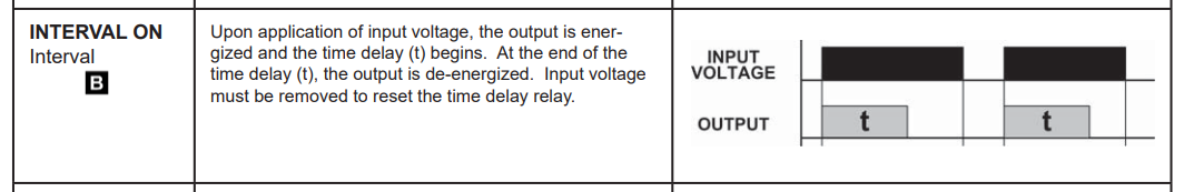

  3. Use an Interval type timer as my system continues power to input 2 past the timer ending (Interval was the only type I could see that lined up with this). I've updated the chart to represent what I'm seeing with the multimeter and ignoring 5. The flicker I eluded to before is likely the change from button power input to clamp sensor power input. And this is likely to not influence the timer as power still continuously supplied.
  4. Don't mess with any gate or start inputs. You can see in the T1 Clamp wiring it is simply folding over power to both 5 and 2 at the same time. So there really is no need for it and all the modern timers I've found need a signal input, not continuous power to 5.
From my research this is actually far more common on 8pin timers. And they are about half the price. So there could be an argument to change the 11pin to an 8pin.
Example timing chart for Interval on an 8 pin:
Your after wiring diagram needs a wire from the relay base 11 to the connector block 4 as shown in my attachment.
If you buy a couple of power (230V ac) initiated interval timers you can replace T1 and T2. If you are not sure send me a link to the ones you intend to buy and I will check they are suitable. Obviously they need to have suitable interval time range. The contacts only carry the small current to operate clamp and inject actuators. Up to you whether to go for 8 pin, 11 pin or din rail ones. Happy to check a photo before you power on should you want me to.
Please keep me informed on progress and DO NOT WORK on live equipment.
note: For power initiated interval timer if applied power goes off then interval output ends at same time.

Brilliant! I thought the timer power actually supplied the output power. How silly of me. But according to your diagram each Relay in the Timer can have its own power and the Timer simply switches the NC & NO contacts. So you could actually have a set up like this and mix voltages and all sorts:
This has helped me greatly as I completely missed I need to supply power to the contacts! Thanks so much :)
I will get on to ordering some Interval Timers that function with Power ON and report back how it goes
And I'm thinking of going for something like this. The 8pins really are more geared to the Power On Interval style and the 11pin options are less common and expensive! The 8pin option below looks like it will do the job just fine :) One caution might be the 3A vs 6A on current Timers, is that something I should worry about? It is just supplying voltage to a solenoid valve, I can't imagine it drawing a huge amount of power.

The relay you have selected is suitable. Order AT8N . (Do not order AT8N1 or AT8N2 ).
One they have arrived we need to set up the timer range and timer mode for I = Interval operation.
