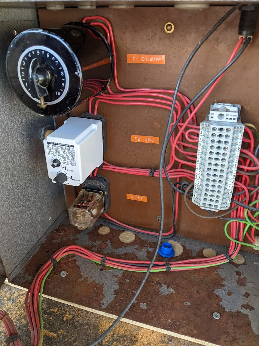

Complete novice electrical wise. I am refurbishing an old 1950s Injection Moulding machine and looking to replace the Power Timer Relays. So far with no success myself and two attempts. It appears I need some expert help. I would love direction on the type of timer I need and a link to where I could purchase is a bonus. Any help much appreciated. Details below:
The old Timers:
What I've investigated:
  • There are 2x Timers, one for inject and one for clamp
  • They are both the same, because I can swap them around and it still runs just fine
  • Markings still remaining on one says Supply 230 V AC and Rating 6A 230 V AC. There is no cut down in power on this machine, 240V throughout.
  • They appear to be short-circuit driven (not power on all the time and Start commands etc)
  • Power is only supplied when they run and is instantly straight through to the output
  • 11 pin circular configuration
  • Phase to pin 2, Neutral to pin 10
  • Power into pin 5 and 2 makes the output run forever until short-circuited. I think I've heard this called an Inhibit function which allows the Timer to pause and force power through pin 6. In the clamp instance this forces the clamp closed, lets the inject sequence run, and then allows the Timer to run before cutting power and releasing the clamp.
  • Pin 6 is the only output. This runs to the 5/2 solenoid valves and changes the valve position for either inject or clamp
  • Timer appears to be a Power Off Delay or similar as it only tells it when to cut power off

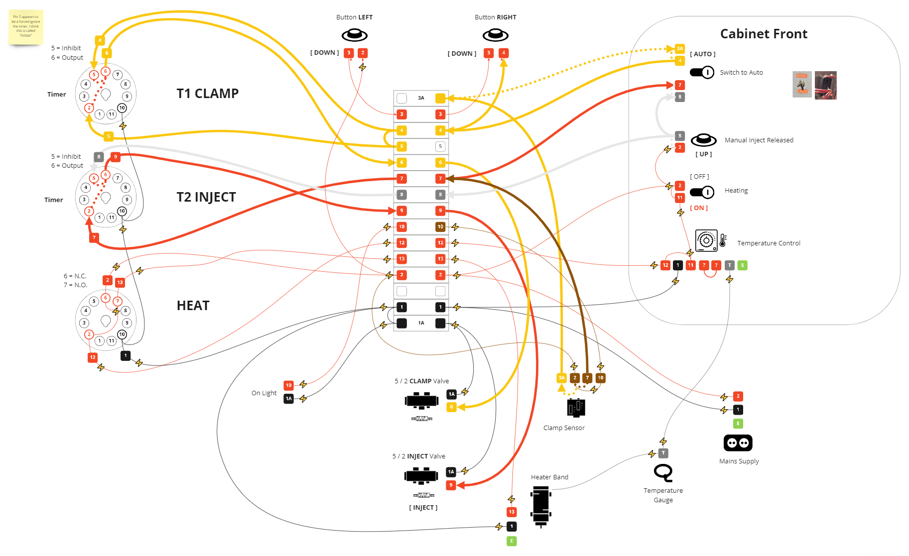

Diagrams that I've mapped to help explain how the Timers work and current wiring:
If you need any more info I'm happy to provide. And even if you are just interested in the machine I can post pictures of that also :)

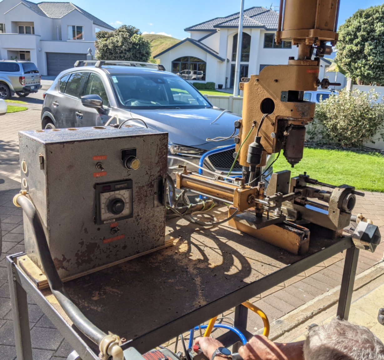

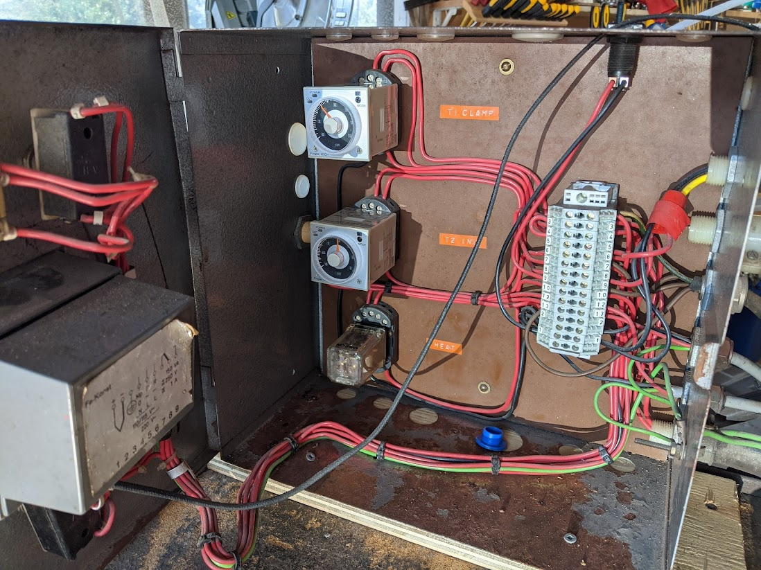

Here's a look inside the cabinet:
And machine if of interest:

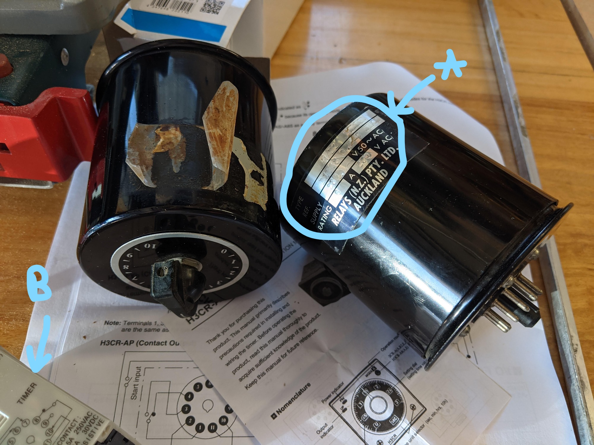

Could you tell us what is stamped on the plate circled A? See attachment.
Circled at B are the connections to pins of a device; which one? Could you show these too if they refer to the relay you wish to source new?

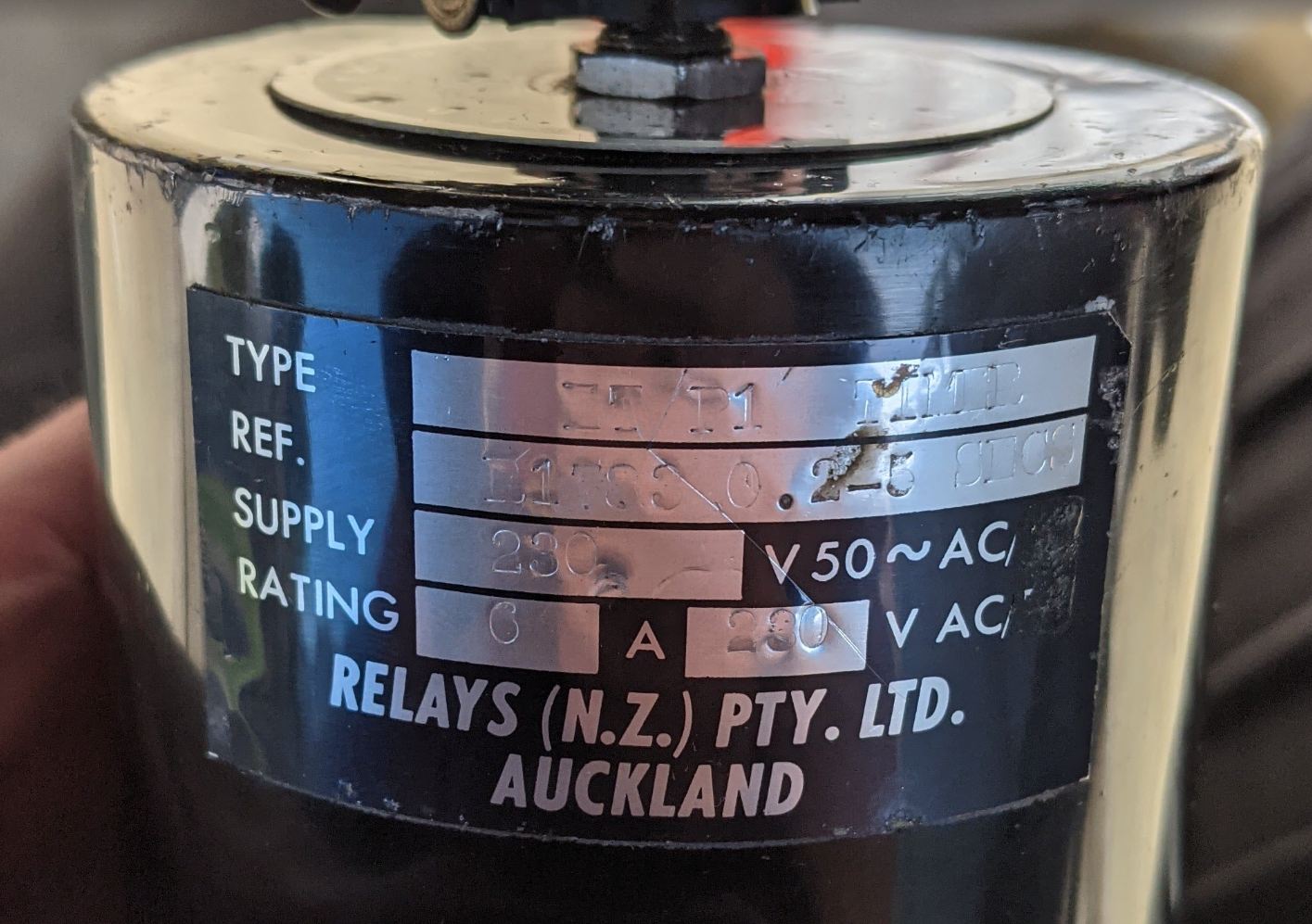

Hi Marconi
Sure, here is a close up of the stamp and my guesses:
Type: ET P1 TIME
Ref: R1783 0.2-5 SECS
Supply: 230 V50 AC
Rating: 6A 230 V AC

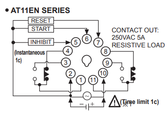

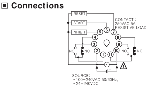

And as for some new ones I'm wondering about there are these:
Macromatic Analag Timer TAA2U
Autonics AT11EN
From my understanding the numbers 3, 4, 8, 9 are internal to the Timer. But where I struggle is, what is considered an Output and Input. Because from the looks I require Input to 5 to inhibit. And then I want 6 as the Output to the solenoid valve. I also see the - and + are the other way around on these timers.

I will study these over the weekend. I have found this firm which does a wide range of 11 pin timers both electronic and mechanical. There are others of course. Just need to determine the functionality and pin out to select the correct replacements:
Foxtam Electronic Timers - Foxtam Controls - https://www.foxtamcontrols.co.uk/products/foxtam-electronic-timers?gclid=CjwKCAiAvOeQBhBkEiwAxutUVHSvHPRKJ82h19_XRP_x6cjnG9xgrFnutB03_ZHWCQ_b9qyrUHY_OhoCuRoQAvD_BwE

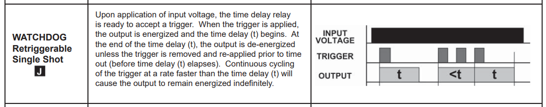

I actually stumbled on this article which might shed some light. It looks like timers that old might have been True Off Delay timers rather than more modern Off Delay timers. https://www.macromatic.com/blog/relays/what-is-a-true-off-delay-function
"Upon application of input voltage, the output is energized. When the input voltage is removed, the time delay (t) begins. At the end of the time delay (t), the output is de-energized. Input voltage must be applied for a minimum of 0.1 seconds to assure proper operation. Any application of the input voltage during the time delay (t) will reset the time delay. No external trigger is required."
From a search I can find some 240v 8pin ones of these. But I haven't found a 240v 11pin version. Do you know how I would test to see if a True Off Delay or not?
I do have my own attempt at a wiring diagram. I can confirm the numbers the timers are using as I took off the timers to record where the wires went:
Please keep in mind it is only the black large old timers that work. But I found some old pictures I have of inside the cabinet:
I have asked FOXTAM for a quote to supply two 11 pin true delay off timers from this range:
https://www.foxtamcontrols.co.uk/assets/img/25-YRKF-8RKF-11RKF-8R2KF-11R2KF.pdf
The timer above does not require a 230V ac power supply to be present to maintain the contacts closed during the delay off period.
I will also look at other suppliers such as RS components.

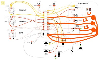

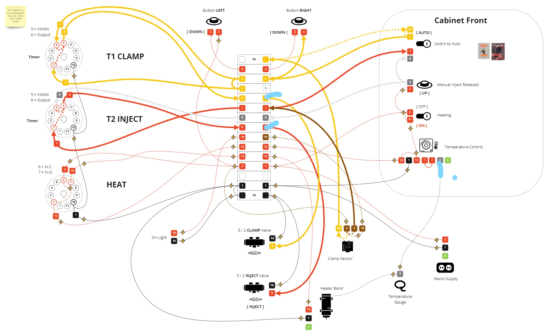

I will explain later how you can use three lamps connected to the terminal strip to confirm the functionality of the timers. You do not now need to fill in the connection matrices I mentioned earlier.
murd_the_nerd:
Please remove the wires marked with a short blue dash in the attachment called 'disconnection'. Label them so you know were to connect them back to. Put the ends of these wires inside a connector so they do not touch anything. This will disconnect the valves and the heater.
Buy three neon lamps like these:
IND5032405-240-T/RD | CAMDENBOSS Red Indicator, 240V, 8mm Mounting Hole Size, Lead Wires Termination | RS Components - https://uk.rs-online.com/web/p/indicators/0576181?cm_mmc=UK-PLA-DS3A-_-google-_-CSS_UK_EN_Displays_%26_Optoelectronics_Whoop-_-Indicators_Whoop-_-576181&matchtype=&aud-832474874771:pla-302376642891&gclid=CjwKCAiAgvKQBhBbEiwAaPQw3PKQPeh7zExzTVve1WMoT2jRpbFI38x3yiulbOparbQKTL-P_mZxfxoC1tgQAvD_BwE&gclsrc=aw.ds
They are 230V ac neon indicators pre-wired with leads. Amazon will do them.
Labels these indicators as L1, L2 and L3. Now connect these lamps as I show in the second attachment 'ThreeLamps'. The leads go to the terminals at which you had disconnected a wire and the neutral.
You can now run the control panel and the lights will indicate power being supplied to the two valves or heater so that we can confirm the functionality of T1 and T2 as True Timed Delay off.

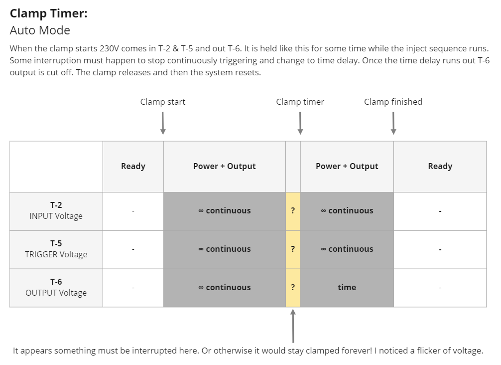

Please draw a timing diagram like the ones you have shown.
Hi Marconi

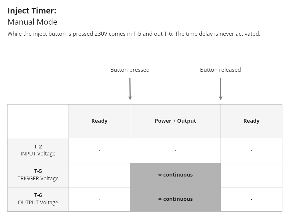

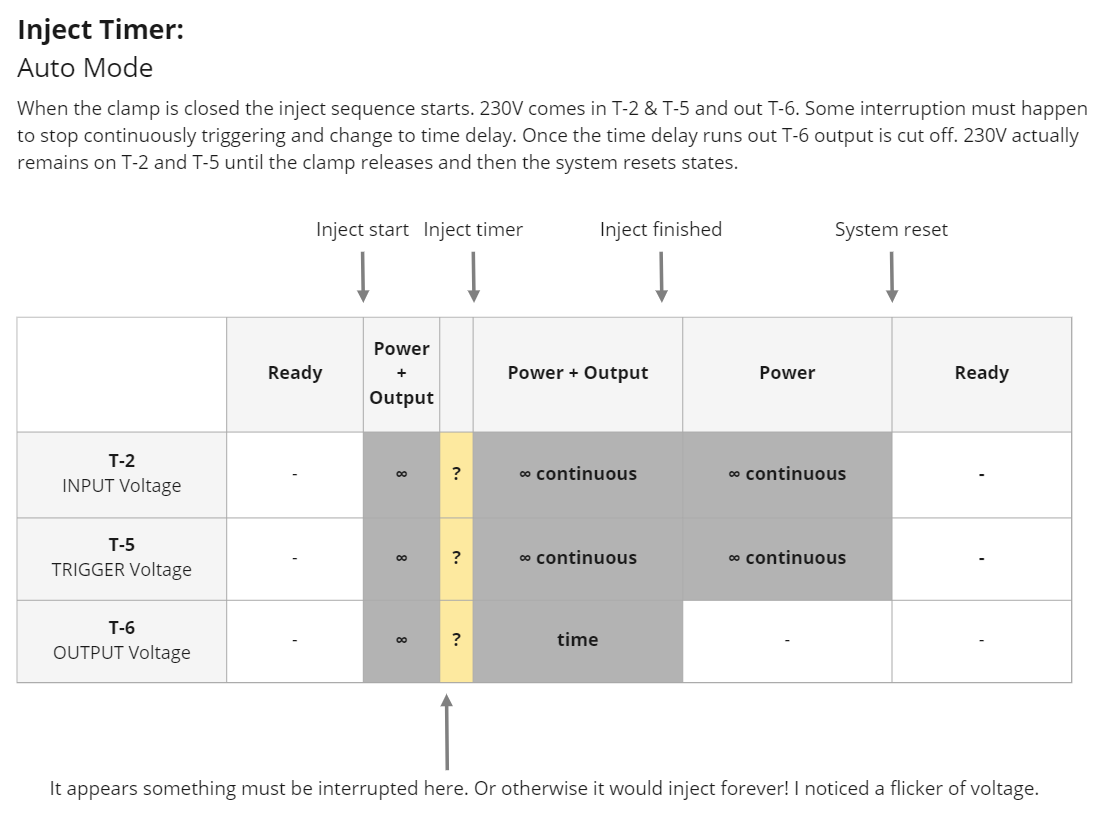

My new multimeter arrived and I have had a chance to check voltage in various states. I think this has given us valuable insights and I've added detailed diagrams below. Any help much appreciated :)
  • Looks like we're dealing with a "power trigger" as I could see 230V continuously being supplied to T-5
  • There appears to be an interruption where I've marked in yellow. Its like the first time it is powered up it runs continuously and then after interruption it then carries on with the time delay. I'm kind of assuming this interruption is on T-5 or both T-5 & T-2 but not sure.
  • Interestingly on Manual Mode Inject the output is energised with just input to T-5
  • In Auto Mode both timers start with power supplied to T-2 & T-5
  • Interestingly on the Inject Timer, even though the output is de-energised after time delay is finished, power remains on the inputs until reset by the system.
