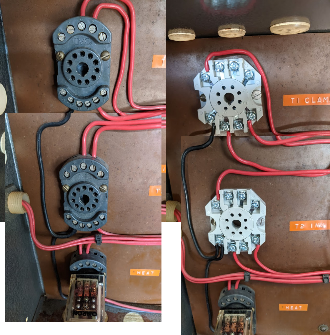

With power off and referring to any pictures of the relay wiring before you swapped for new ones just check you have moved the red wires to the new bases so they act as relay power or output contacts as necessary.
What do the top left and right lights do?
Hi Marconi. I finally had a chance to wire in the new timers today :) I was in a bit of a rush and may have got the + & - the wrong way around. The heater wouldn't start so there is an issue. I either need to force the sequence change on the machine or the wiring is not letting it turn on. There is a relay in series with the two timers (- black wires) that allows the heater to start. I ran out of time to trouble fix.

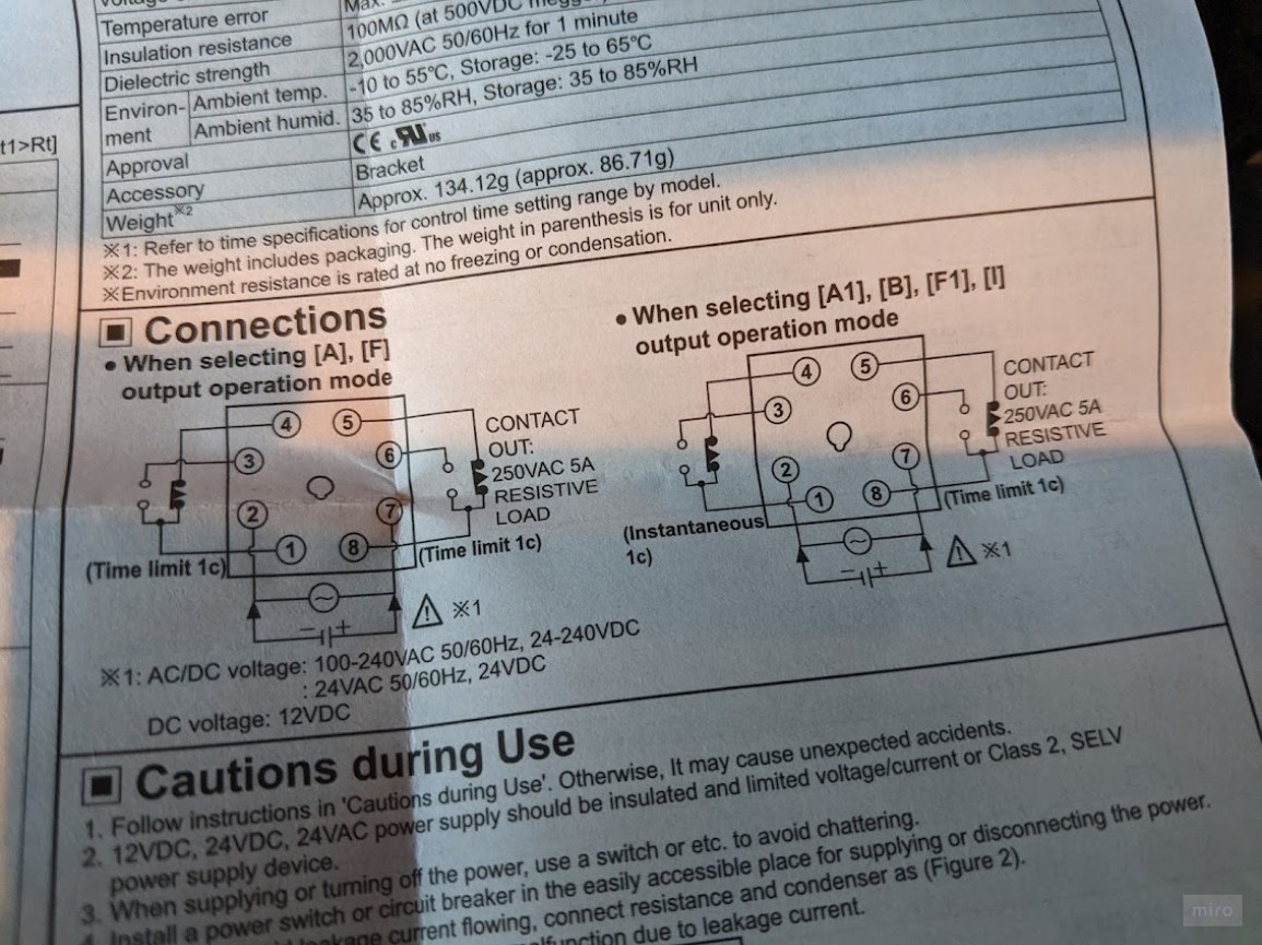

I would appreciate if you could let me know whether switching the + & - between timer pins 2 and 7 would change anything? It seems just for DC it is wired the other way. Everything else appears fine at first glance...
New wiring:
New vs Old timers:
Timers and relay wiring new vs old:
Wiring diagram from the timer manual:
It is only for dc supply you need to connect plus and minus as in the wiring diagram.
Thanks for confirming the +/- only being an issue for DC. No lights or anything on the timers because without the heater relay working the sequence won't even start. And power is only supplied at the time.
Hmm maybe a stuck sensor or something not to do with the timers at all. I will investigate in the coming weeks and hopefully have some good news!
@marconi we have victory!
Turns out the new wiring of the timers was perfect. And the issue was with the heater relay itself. I found a loose wire, fixed that and then all worked perfectly. I don't think I can post a video on here so I've just snapshotted a picture here with the Clamp timer running and output live in interval mode. I can now see the indicator lights on and off during the sequence which is an added bonus with the new timers.
