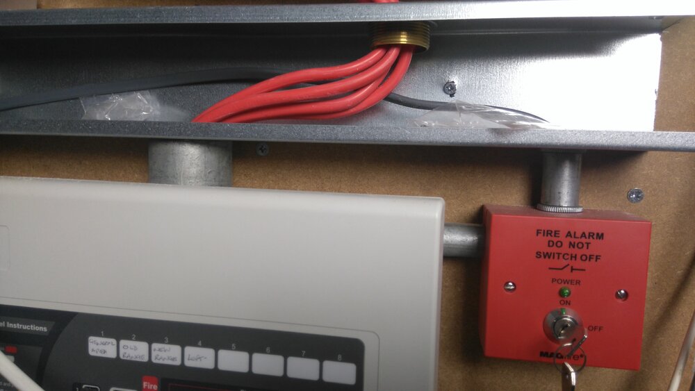

Is it permissible to run the red fire alarm cable with the mains T&E cable, though holes and in the same trunking?
I thought alarms were 24V and that ELV, data, telephone etc & LV should be kept separate?
Maybe there is an exemption for fire alarm wiring as it is screened and fire retardant? If so, I can't find the specific reg.
TIA,
N.
You can run the mains cable to the fire alarm in line with other mains rated cables, but the fire alarm circuits ( Loop, Zones, Sounders) need to be separated from mains cables under BS5839 to reduce interference
It's not just the LV and ELV issue. As a safety service fire alarm needs to be segregated from other services. Both BS 5839-1 and I.S. 3218 in the case of the poster from Ireland require this.
It sounds like you're referring to FP200 cable, so I'm presuming that this is a commercial or industrial installation (in spite of the reference to T&E being used). You are correct that they are generally 24V.

Second photo shows the new fire panel. FP200 cable is crossing the T&E, running in the same trunking.

The T&E into the keyswitch for the alarm should also be fire rated, not straight T&E, pretty certain the standard is explicit about this as it forms part of the alarm system itself and so should be fire rated.
