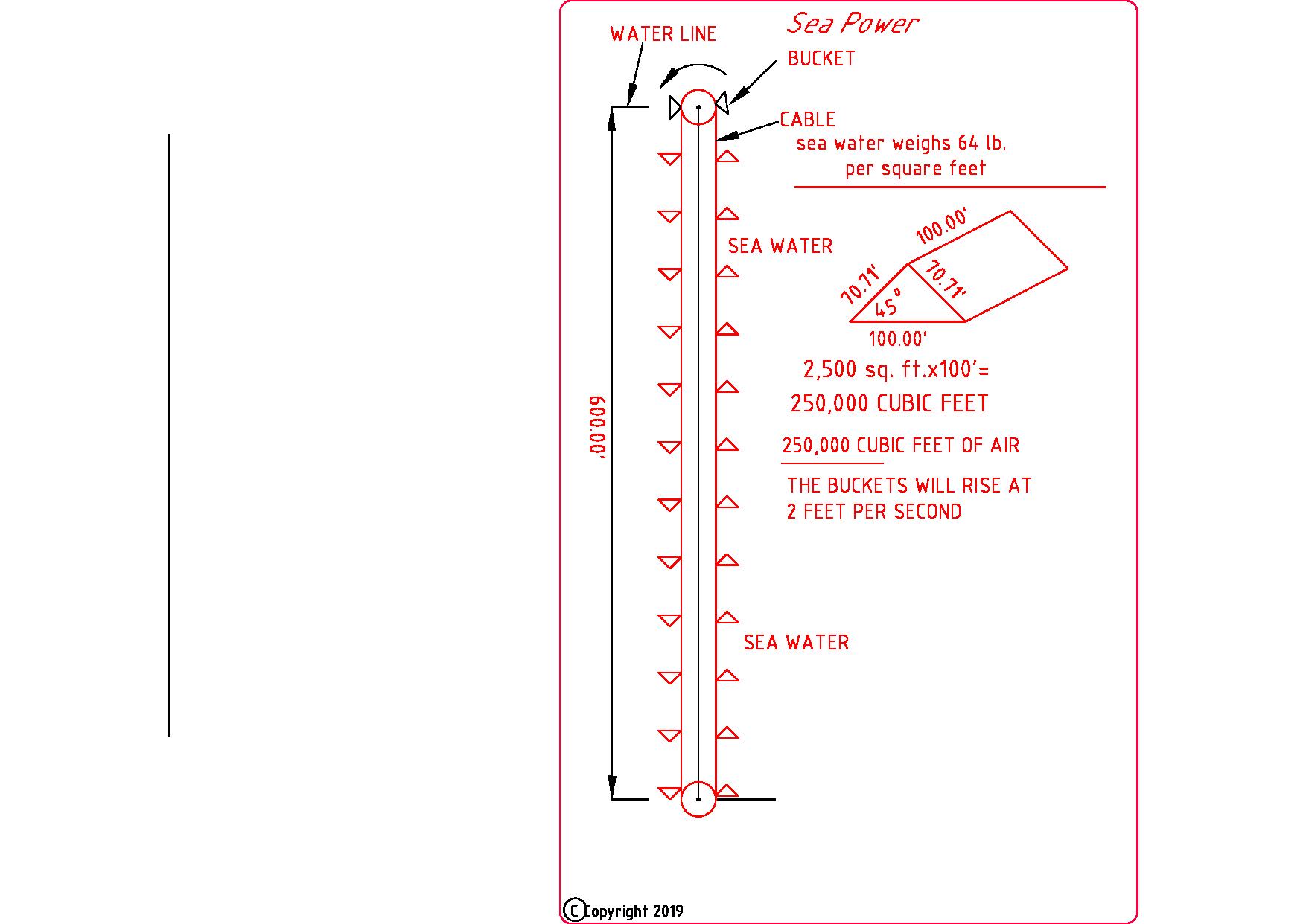

This is a diagram that details a new energy generating power from the expanding rise of air underwater
In the diagram, there are balloons that air was injected in the lower balloon. As the balloon rises it expands and this expansion is caused by the reducing pressure applied upon it.
Picture this as if each balloon was a hot air balloon with an opening at the bottom. The first balloon at the bottom is injected with air; as the balloon rises it expands creating more lifting power.
This is the same principal that keeps a boat afloat.
I realize that there must be a reason this idea won’t fly but as of yet I have not found it.
If you really believe this contraption won’t work, please explain; otherwise you don’t have a clue.
The lifting force is equal to the volume of water displaced. This is the same principal that keeps a boat afloat. One cubic foot of water weighs 64 lbs. A balloon that displaces 10 cubic feet of are has a lifting force of 640 lbs.A new energy source-maybe--maybe-not SEAPOWER - EletriciansForums.net
you are injecting a balloon with air. where does the power to do this come from?

I'm not even going to try to unscramble the numbers on the drawing. Force is not measured in foot-pounds. Sea-water does not weigh 64 lbs per square foot. There seem to be some fundamental misconceptions.
In an ideal machine, the energy used to compress air at sea-level to fill one balloon at the bottom of the belt will be equal to the energy transferred to the belt as the balloon ascends back to sea-level, numerically the integral of the buoyancy force over the distance it moves. The balloon skin simply behaves like a piston of variable area, against which the air expands, a reverse analogue of what went on in the compressor cylinder. It's an air-motor using a liquid medium as a cylinder, nothing more, nothing less.

A little bit of Physics .. mixed with common sense
is the best basis for "Looks plausible - Never done before schemes " .. as they are breaking the laws of physics in a subtle way.
volume of water displaced by an expanding air bubble
..Looks good
Put it in a piston chamber , it will expand (only if it started a higher pressure ) final step at surface
.. will have minimum force -not so impressive

But how are you filling the balloons with air?
Here is another look at the system. The bubbles are more like hot air balloons but instead of heat, air is added. As the air bubble rises, it expands creating more lifting force. When all six (6) bubbles have air in them they combine this lifting force.
But the problem is that the energy used to move the air to the bottom of the system will be more than the energy output from the system.
The balloons will expand yes, but the amount of air in them will remain the same, it will just be less compressed. The lifting force won't change as it rises.
@justcurioustwo why don’t you build it.....film it......and prove all us doubters wrong?
This is a simply mechanical machine that utilized the rising force of balloons with air in them. You can also envision this as inverted umbrellas. What makes this “work” is the combining lifting force of multiple umbrellas with expanding air in them. The result is an increase in “force”; that I am now trying to convert into watts and the speed these rising balloons are traveling.
Maybe someone here with more technical knowledge can help me out in this. Once done we can the evaluate whether it is a zero-sum game or whatever.
You state that the lifting force will not change as the balloons expand. This might be my Achilles heel. The lifting force is equal to the water being displaced. At 1 ATM the volume of air under this umbrella is 300 cubic feet. This same 300 cubic feet if air under an umbrella at a depth of 594 feet is under a pressure of 264.6 p.s.i.; has a volume of 16.66 cubic feet.
As the umbrella rises the air bubble expands pushing out more water.
If I understand your statement correctly, please tell me how a balloon displacing 16 cubic feet has an equal rising force of a balloon displacing 100 cubic feet?
I am sure I am wrong, and you are right but just saying so is not convincing enough for me.
Please elaborate on your point of view.

Is it possible to build this system? Yes, if you throw enough money at it you can build it.
Is it possible to build it and make money from it? highly unlikely in my opinion.
