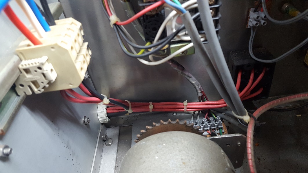

I am hoping this is in the correct forum. To start, I acquired a film processing machine that runs on 3 phase. Now before getting the machine I fully understood it's power requirements and the cost of getting 3 phase installed at my house. I figured as processors are mostly a few pumps and lots of motors, I would be able to find a "workaround" like finding what motor draws the most and replace it, or re-wire the machine.
Examining the machine, I discovered there are 4 motors, and 2 pumps, only one motor is 3 phase, all others are single phase. There are two 3 phase connections, one that was hardwired and cut, the second is a 3 phase plug on the machine. I have attached some pics to show the different power inputs. I have inquired locally of some sparky's to see if they would help, I even offered to pay more than their call out fee, but all declined. One said that if I did the wiring he would attend to test it for safety before flicking the switch.
Here is the question: If I replace the biggest current and voltage drawing motors, at least the 415v 3 phase, and the plugs and fuses...can I fool the machine into running happily on single phase? If the machine did not need to draw 415volts could it still run on reduced voltage or would the collective draw of the other motors still require alot of voltage, hence needing 3 phase regardless? Or can replace the biggest voltage drawing motor and simply purchase one of the converters linked below? That way the heavy duty motors are replaced and I can still utilise the original wiring.
The machine I think is very well made, these were very expensive when new. The wiring looks to be professionally installed, and it appears the manufacturer installed quality items. I would hate to have to rip it all out and re-wire it for single phase wiring... which I reckon I am capable of doing, basically wiring the motors and pumps to a switch board, similarly to how it already is, installing my own switches, however I would perhaps lose some existing capabilities. Running the machine essentially needs a motor to run the processor, the two pumps can be left off while the processor is running, they simply filter the developing liquid, this can be done later. Once the film is developed a vacuum motor needs to run, as does a hot air blower, and a take-up motor (winds the film onto a spool)
I cannot afford to spend $$$$ but a few hundred is certainly doable.
These are the motors and pumps, one I cannot access but I think it is also a 3 phase motor.

Main fuse board
3 phase power input -fuses top left, main power switch bottom right
This is the 2nd 3 phase power input, these wires connect to the main fuse board, first pic
The below connector block links all the various motors and pumps
It looks like there is enough space inside the machine for modifications which is handy
You would need to replace the 3 phase motors as they require 3 phases 120 degrees apart in order to turn, they work differently to other motors and have a set of windings for each phase, its the phase rotation which cause it to turn
If you found suitable speed, toruqe and HP single phase motor replacements that would be a way to go, then everything inside the machine is running on 230v, the accumulative current demand as you say just needs to be worked out and then you ensure you have installed or can get installed a circuit with enough current carrying capability to handle it. Also worth noting a single phase replacement motor may draw more current so the wiring inside the machine might need to be upgraded
Thats my take on the motor side of it, the control side of it would need to be verified as to how it is configured, But I suspect a single phase can be supplied to all the relays etc doing the switching and if not already there a single phase AC to DC power supply could be sourced for the PCB

The first thing you're going to have to do is to reverse engineer those connection and control panels, to produce an accurate circuit diagram of what you have. From there, it should be relatively simple to see whether it can be adapted for single phase.
A quick update, I got a closer look at the power supply wiring, bottom left, and from the small amount of reading I have been doing on 3 phase power supply, I should be able to re-wire as per the bottom right diagram (as long as I isolate the 3 phase motors by initially removing the fuse, I can replace with single phase motors later)
Before I flick the switch I will isolate not only the 3 phase motors, but also the single phase pumps, at least until I can get it working, then try with pumps de-isolated to ensure I do not blow a fuse.
I am hoping you guys might check my suggested re-wire?
Cheers, Gareth

Hello,
I had an electrician check the machine while he was at my house on a wiring job. He had not seen a VFD before, and was curious as to why the terminals had no labels, so he is researching which terminals are which.
So i have a vfd standing by. He suggested i wire 240 volt to the machine, pull fuses on all non essential motors as a way of starting it and checking its function.
I did that and the machine is working well, not all its functions, but its a start.

Some interesting design decisions to be made. I would suggest that this is not the forum for those as is well out outside of normal electrician territory.
A rotary phase converter is probably your best bet. Much simpler than transformers and vfd.
Yeah the rotary converters looked like the best choice from the start, but the cost is too high. This machine is for private use, not within a businesses financial sphere... I have to explore cheaper "work arounds" hence the alternative like single phase connection, remove all 3 phase motors. How hard would it be to wire in a step up transformer to act between house mains supply to VFD to 3 phase machine?
Honestly, by the time you have installed a vfd and a 3phase step up transformer, you will have got above the cost of a rotary phase converter.
also, your bespoke system may well encounter problems with the unusual issue that a vfd is designed to run a single motor and by design this will have a near perfect power balance across phases.
your machine with single phase loads switching on and off may well trip the vfd into fault.
Thanks for the good info guys, it helps me work out how to connect the machine. Mostly i am inclined to simply replace both 3 phase motors with single phase equivelents, and circumvent the 3 phase controller board and re-wire all other 240 volt motors individually.
The machine is an old film processing unit, basically low amp 240volt motors, 2x 240volt pumps, 2x 240volt heater elements....
