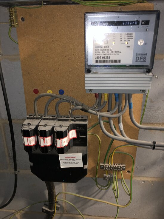

Am trying to take a lease on a commercial premises but I require a lot of electricity. See attached the photo of whats already in the premises. I'm being told its only a 45 kVa supply.
I require (I think) a 300amp supply. I dont really know my watts from my amps from my kva but what I do know is that the machinery I need to run 24/7 will consume about 3000 kw per day. Its a data centre but I dont really understand the ins and outs of the electrical supply.
So the landlord has told me its 45kva (I have the MPAN if it helps) but the photos (attached) I'm told look like 3 phase. Can someone please help me the f out as I am totally clueless.

I can't really help in terms of upgrading the supply but you will need to get some more exact figures with regard to load in order to work out what you need. When you say 3000kW per day I'm guessing you mean kWh? Thats would equate to 125kW of load which comes to around 550A. To run this I would think you would be looking for at least a 200A 3ph supply, more if you are planning to upgrade in the future? Best thing is probably to discuss your needs with an electrical contactor used to working with commercial/industrial to design the instalation and calculate the maximum demand and therefore the size of supply required.

If you need a 300amp supply, the photo you provided shows 60-80amp fuse holders with a 40-100amp meter.
I don’t think you will be getting more than 100amp without major upheaval.
Call a spark along to look at your requirements and have a look at that Main supply a little closer.
Getting the DNO to organise you with a bigger supply won’t be cheap.

You would need a new upgraded supply, the existing supply is too small. You will also need metering upgraded to CT metering, whole current only used up to 100 amp. I would check with dno to see if large enough supply is even available.
