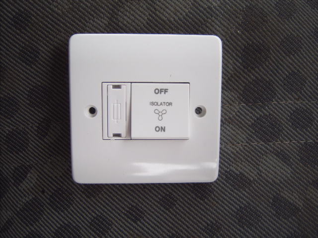

Screwfix do a manrose inline duct kit fan outlets inlets ducts etc good little fans to one point i will make is the fan will have to be fused down and this type of work is notifiable too ... im sure thats 2 points ...
not wanting to hijack post in anyway, but how do you fuse yours down when its a timer fan, i know someone who puts line to line and switch line to neutral then connector block for the neutral . i have pointed out to him that this means the switch line is not fused
personaly i put fused connection unit before the light so the light and fan are both fused down as this seems to be the simpliest method

i use one of these and fuse the perm live side as per manufacturers instruction you will find that the fan itself will not be energised if the perm live is not presant as its this that enables the timer circuit to operate but with out it it wont work and the issue is the fans seizing and over heating causing a fire i have seen this happen on several occasions one causing £1000,s work of damage the other where the fan motor had caught fire dropped out of the housing and burnt a hole into a soil pipe where the fire was extinguished , these are available from scholmore click MR seed 009.JPG

is that a two pole switch with the line being isolated by fuse removal?
its a good looking unit i was wondering why no one had made one lol
is the purpose of the manufacturer requiring it to be fused down due to the potential overheating? do they draw excess current when at fault then ?

That looks nice .. it saves having the twin backbox with both the FCU & Fan Isolator in it.
they are great i use them all the time , they are modualr face plase fuse holder and a fan isolator its a 3 pole switch so the perm live goes into the switch then the out put goes to the fuse then to the fan all you have to add is the link from the switch to the fuse doing it this way when you switch the isolator off the fuse is dead so you can remove the fuse with out it being powered as you should

its all about maintainance if you have a fan thats not been cleaned and looked after you get a build up of dust and what ever else im sure youve see this if it buids up to the extent that the fan siezes then the fan can over heat and in some cases catch fire , this can also happen if the bearing siezes for the impellers are damaged etc , the problem is the coil when it siezes draws less current than the 6 amp lighting circuit requires to trip so catches fire hence the reason for fusing them down
