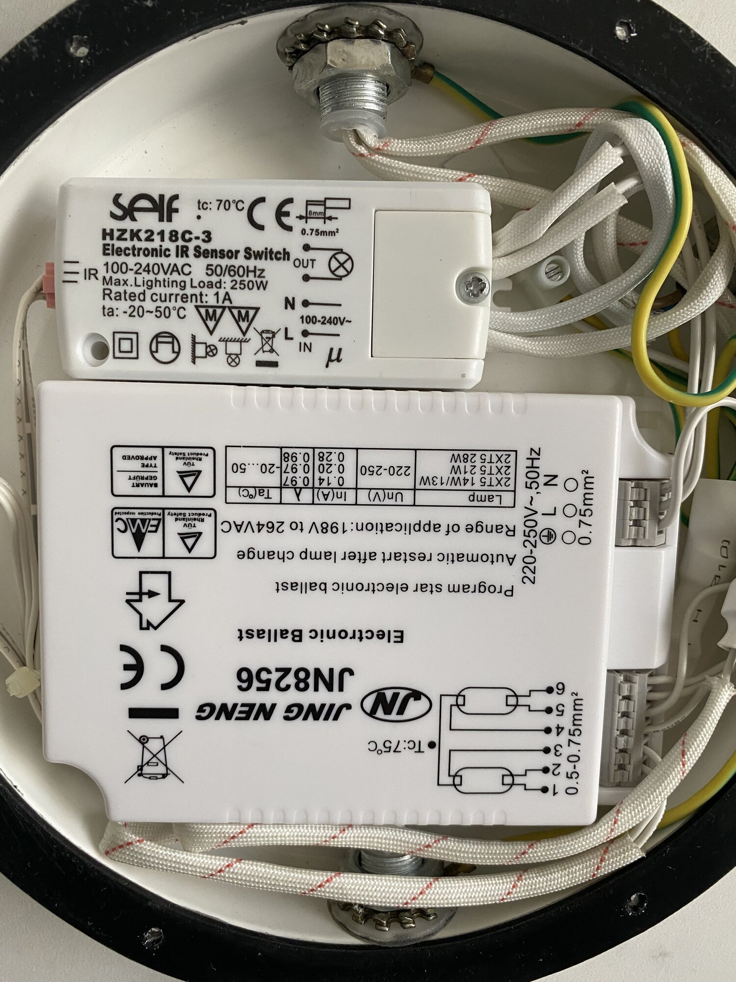

I have a bathroom mirror with 2 x 21W fluorescent T5 tubes and an IR sensor. The tubes switch off after a few minutes. I have changed the tubes and the fault persisted. I checked the output from the IR switch and it was 240V so that leaves the ballast as faulty. The problem is the ballast is a not one of the long ones but a shorter one that fits neatly inside a waterproof compartment. I cant get a replacement ballast so I'm looking for some options. I want to replace the Fluorescent tubes with LED T5 equivalents but UK ones still seem to require a ballast (presumably to make them a straightforward replacement). It seems that the US have type B tubes which will run straight off the mains (that would be an easy option as I could just remove the ballast and adjust the wiring but they don't seem to be available in the UK. Can anyone suggest an alternative? Thanks

Changing the entire fitting isnt an option as the mirror was expensive and we want to retain it. So there must be an option to retrofit this with LED tubes?

Do type A LED tubes HAVE to be run through a ballast, or is that just for ease of installation?
It would be great if they didn't and I have read a number of articles that suggest that although you can leave ballast in its a better idea to remove in case ballast fails at a later date. If that is possible then I just need to work out how to rewire them.
I would engage the services of a local electrician and have them rewire the mirror to use these:-
Unless you feel confident you can undertake the work safely yourself... and for the record, safely does not involve using choc block terminal strips and PVC tape. For this, safely involves decent wire connectors such as the Wago or Ideal lever connectors, or if the cabling is solid single strand copper, the equivalent push fit connectors (I would go with Wago's personally).

I've fitted many 1200mm and 1500mm LED tubes; some to existing fittings with the ballasts still in place, and some to new IP55 fittings that were supplied without ballasts fitted, and intended to be used only with LED tubes.
This question was aimed at the knowledgeable regulars on here, rather than at the OP.
Crompton do direct mains ones (the ones I linked to in my previous post) and ones suitable as direct replacements where the ballast is fully functioning. It's entirely possible the ballast is just getting hot, crammed in there, and it may have dry joints and/or failing electrolytic caps, but in this case rather than take the chance I'd go straight for the direct to mains ones.
The tubes I've used in my last post were all the same. Some are through a ballast, and some are direct to 230V.
No idea what the voltage drop is across a ballast when used with LED tubes.
