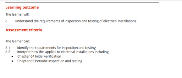

Okay, so you're saying that just because the C&G 2382-18 covers 'Inspection and testing of electrical installations', this would not be enough to prove the 'competence' requirement?
No, I wasn't saying C&G 2382 covers inspection and testing, please read my post again.
2382 covers the book BS7671 Wiring Regulations.
The book has a section on Periodic Inspection and Testing. It's a book that tells you what must be done, and not explicitly how to do it.
2391, and the others beginning with 239, are much more detailed exams, based on courses that are quite rigorous and difficult to pass for many.
However, as others have said, you can have the exams under your belt, but it's competence gained through experience and understanding of the various electrical systems that really counts.
My point was that C&G 2382-18 has a section which covers inspection and testing. See the screenshot I attached in my last post or refer to the C&G 2382-18 handbook:
That only covers on how to find the relevant information within BS7671 such as disconnection times, requirements for RCD protection, earthing conductor sizes and hundreds of other references.
It does not in any way cover how to inspect and test and installation, the courses I mentioned earlier on in the thread do.
