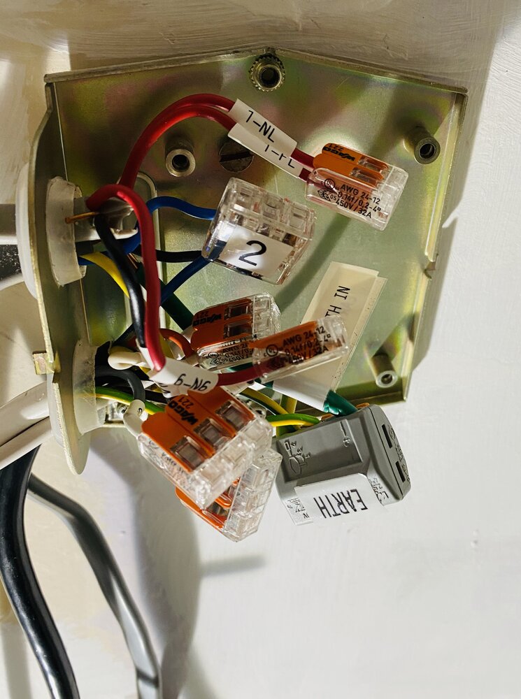

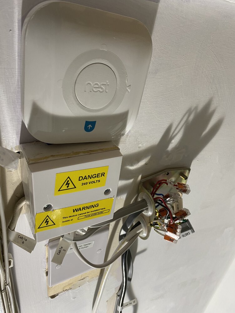

Pictures of the layout. Two enclosures .
2020-07-16 11.00.06.jpg2020-07-16 10.59.56-1.jpgFile 16-07-2020, 11 24 53.png
[automerge]1594896975[/automerge]
Two enclosures.
Small unit contains Nest wiring, and a pass through to an RCD which provides power to a 3amp shower pump.
The box did have the in wires to Room Thermostat. This has been removed.
Wago connectors have replaced many of the choc blocks than filled the boxes
Pictures of the layout. Two enclosures . View attachment 59500View attachment 59500View attachment 59501View attachment 59502View attachment 59500View attachment 59501View attachment 59502
Two enclosures.
Irrelevant point, but did you label the earth wago earth? I want to believe that anyone who decides to open the cover/ start working at it would know what it is.
Yes - in case the next person was colour blind. But you do raise an issue. I have watched numerous Youtube videos covering problems in this area and no qualified person labelled the cores nor were they labelled at installation time.Presumably, so that the next person can charge for the time to identify the circuits?
No, it doesn't take long to identify which cable is which in a domestic heating control circuit. On a normal setup I can probably identify the wires in the same time without labels as it would take to straighten out all of the labels to read them and work out what your abbreviations mean.
In your picture you have a connector labelled 2 and wires that appear to be labelled 6-N6 and 7-NL, what do these mean? Do you print a reference chart and circuit diagram to go with this?
I realise that most people will be able to do it in a few minutes but more time needed when the equipment is upstairs / down stairs. I searched for the Boiler SL cable for a time before realising it was a forth core in the mains cable . (silly me)
Part of IET is documentation....... it just adds to this.
The numbers relate to diagrams of the system and the numbering on the cores is 6-N6 is runs from WAGO 6 to N (Nest) port 6 etc.

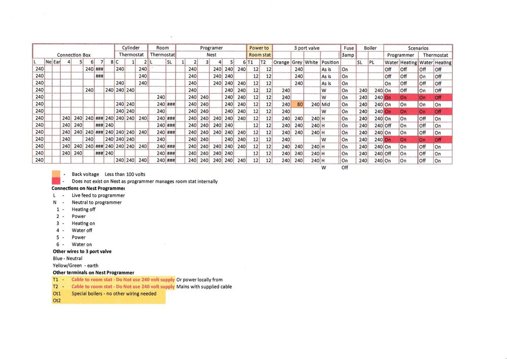

In the pack, I have a diagram showing what is wired and live in all the potential configurations nothing on, Heating on Water off, ....etc.
and a final sheet showing the voltages at the WAGOS and components - still to be fully checked!
Hats off to you sir. A very thorough job and very helpful to the next person working at it.

I am moving to the Ktech Wago wiring centre.
They supply the following diagram and a form for noting the usage of the various connectors.
As I am ripping out all the existing wires, then labelling them is a time saver.
