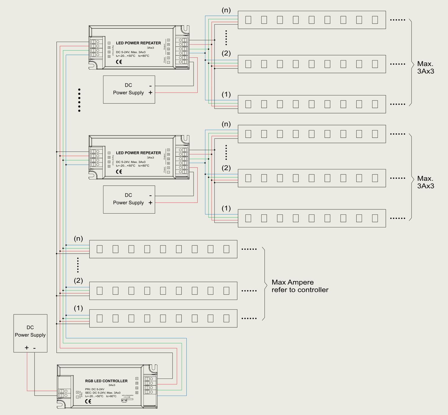

Several manufacturers offer remote control of multiple strips with one remote control. Each strip fed by it's own driver and with a receiver for each strip, that can be synced to the one remote.
Like this for example:

I have not installed this scenario before and assumed that each set of lights (on a different driver) would have a separate remote, and I don't want the customer to have to use 2 remotes. Could both set of striplights be controlled with the same remote if using 2 separate drivers?
Look at systems where you can get RGB (or RGBW) repeaters. They're basically slave controllers which have their own local power supply, and allow you to overcome limits of cable length or numbers of strips and keep just one controller for the whole shebang.
