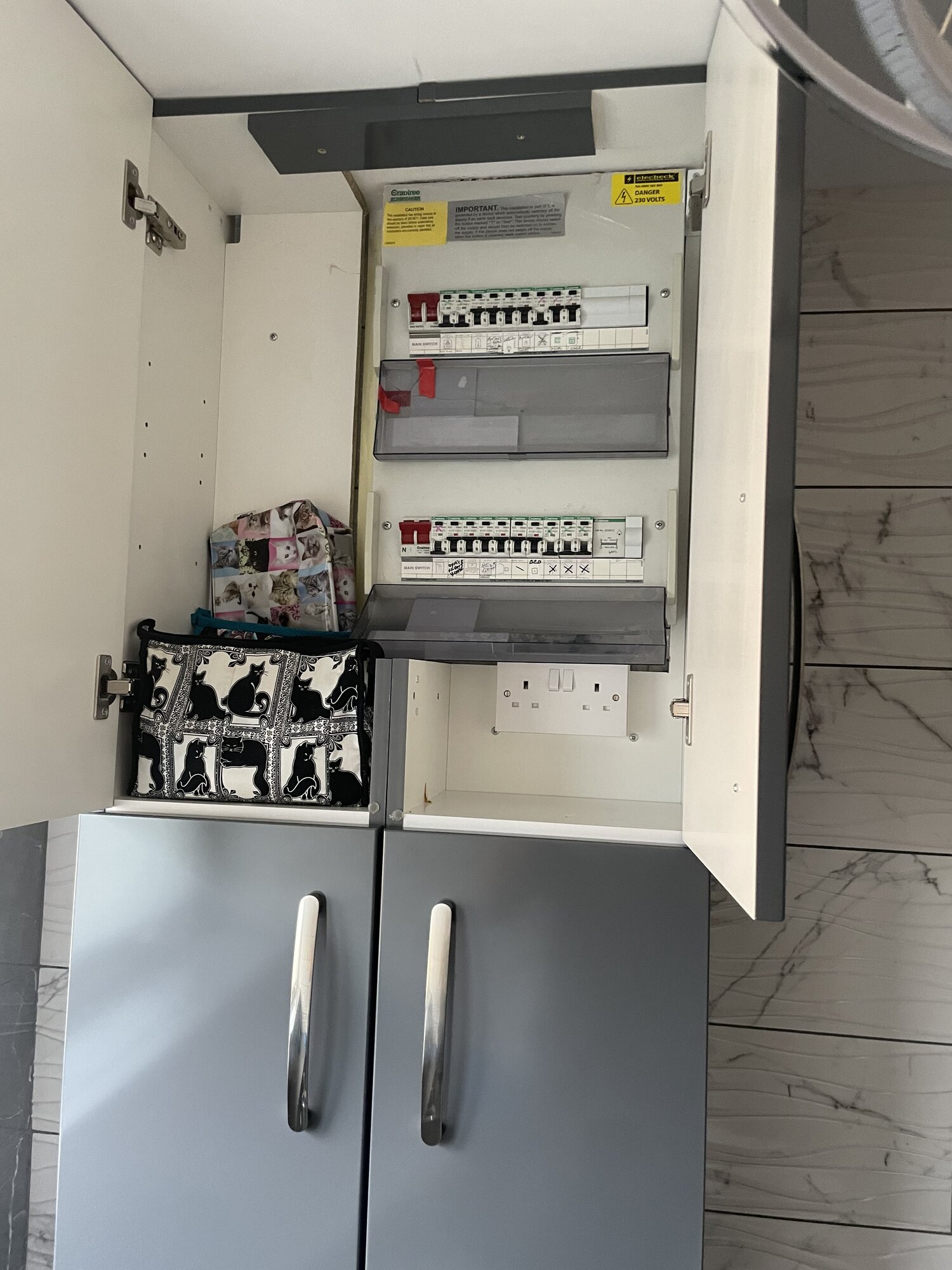

701.32.1 ........................doors, floors and fixed partitions may be taken into account where these  EFECTIVELY limit the extent of locations containing a bath or shower as well as their zones.
See #38. Is said cupboard providing an  EFFECTIVE barrier.
And see #10 ;-)
A cupboard isn't listed as something that can be taken into account to limit a zone, and it says a door has to "effectively" limit the extents of the zones and I'd argue this one doesn't.
  • Agree
Reactions: ipf and UNG
It doesn't. But an electric shower mounted in zone 1 is only correctly IP rated for the zone if the cover has not been removed. The cover of an electric shower can only be removed by use of a tool. Same principal could be applied to any item of electrical equipment, if one was desperate to make it comply.
I'm just playing devil's advocate here, there's no way I would want a consumer unit anywhere in a bathroom.
THis...Rules and regs dont make a lot of sense at times . For me this install is a Joke and a mockery of what is safe etc . That telephone shower hose can easily reach and spray water directly onto the cupboard .lets see if anyone happy with the regs would let their child take a shower in this bathroom !
I think most would agree that the situation is far from ideal and I doubt many, if any would commission such an installation.
The problem isn't whether or not anyone likes the situation presented, but what problem it actually presents from a regulatory perspective.
Personally, I'd insist on the removal of that double socket as a precondition of working on the installation, but could only recommend its removal if carrying out an eicr.
Edit: meant to quote the previous post from @LukeD and not even going you attempt editing on a mobile.
Maybe something like this would be acceptable?
It would improve the situation but there would still be inadequate access to the CU.
Having to stand in a bath is not an adequate access arrangement.
The cheapest solution is to box it in the cupboard, it's then out of zones and out of reach. It would just be a C3 for access but a bit of a bodge. The ideal and recommended solution is to relocate it.
Very interesting thread and many of the comments are extremely pertinent, however I am just astonished that anyone would install that CU in that location. No matter what technical justification might be relevant, it's just a bad installation idea.
A few years ago I was doing some work on a new-build housing estate where all the houses had the CU installed at high level in the downstairs cloakroom. This was a mainstream builder and I am aware the same installation was carried out on other estates. Now, I accept the cloakroom had no bath or shower, but the only way to gain access to the CUs in these houses was by standing on the WC...there's no room to place a ladder or hop-up. I accept these houses passed BC regulations, but in my opinion the CU should not be mounted high up above a WC. A less-able person would find access extremely tricky and indeed hazardous, and for that reason alone it shouldn't be allowed.
We’re all pretty adamant it shouldn’t be there, but the OP questions how it should be coded on an EICR, as it is already there.
I’m wondering originally if that room was an entrance hall…. Ergo, CU was there before the bath was.
Although a keyed lock could easily be fitted to the cupboard door, the suitability of the equipment is not good for the environment.
C2…. Just to make sure it gets done.

Agreed. While having it locked is (in some ways) an improvement, there are still issues, in particular that locking it impairs isolating power quickly or restoring power (e.g. lights) quickly.
Daft scenario: someone's alone in the house, having a bath, and the lights trip. Standing in a foot of water in a slippy bath, dripping wet, scrambling for a key to operate a breaker doesn't seem a very acceptable scenario!
I think the Reg 12 guidance in EAWR speaks for itself:
"The suitable means for cutting off the supply (regulation 12(1)(a)) should be in a suitable location regarding the nature of the risks, the availability of people to operate the means and the speed at which operation may be necessary. Access to switches etc should be kept clear and unobstructed, free of tripping and slipping hazards etc;"
The only solution I'd be happy with is putting the whole lot in an IP box or two and extending supply and final circuits to somewhere else.

Can the CU and related controls be reasonably operated without standing in the bath?

Relocate the socket outlet 2.5 m away from the bath.
Looks bloody awkward to clean the window as well. Can't get near it.
An outlet socket on a landing directly outside a bathroom door less than an MTR away would be compliant as it's behind a door.
An airing cupboard with electrical heating etc in a bathroom behind a door is compliant.
Electrical equipment under a bath is also compliant.
An electric shower which has just a plastic cover and also has uninsulated connections inside is also compliant.
Because is behind a barrier, it's technically not in a zone.
If not in a zone, then IP rating etc shouldn't be an issue. ?

None of us on here, I hope, would install this CU in this location but we may be put in the situation of advising someone on "is it safe/compliant".
The vast majority of my work is commercial and the answer is always pony up and put it right. One example was a national storage company that decided to have showers fitted in all their sites mostly in the disabled WC, don't know who did it but very few of the showers were RCD protected and none of the other circuits pressent in the room were. So that's lights, whatever random circuits passed through he rooms. In the end most the showers were disconnected.
I can see why domestic solutions have to be a little more creative, the customer may not have the money to fully correct and a significant safety improvement will be better than no action. Just make sure you offer the full correction in writing.
In this case I'd quote for the CU to be moved to a compliant location. Get their refual in writing, email is a powerful tool, before suggesting the socket is removed and the door to the cupboard should be screwed shut, a lock will just be removed and left off, but then the CU is not easily accessible I the event of a trip.
Yes, ALWAYS get it in writing, even email (but make sure you save a copy just in case).
Check with the manufacturer: if you can get them to state the equipment is unsuitable for installation in a bathroom due to humidity & condensation then you have another very good argument for C2 beyond the obvious placement close to a bath and possible ponying about as to whether the cupboard doors make it in or out of the prohibited zone.
