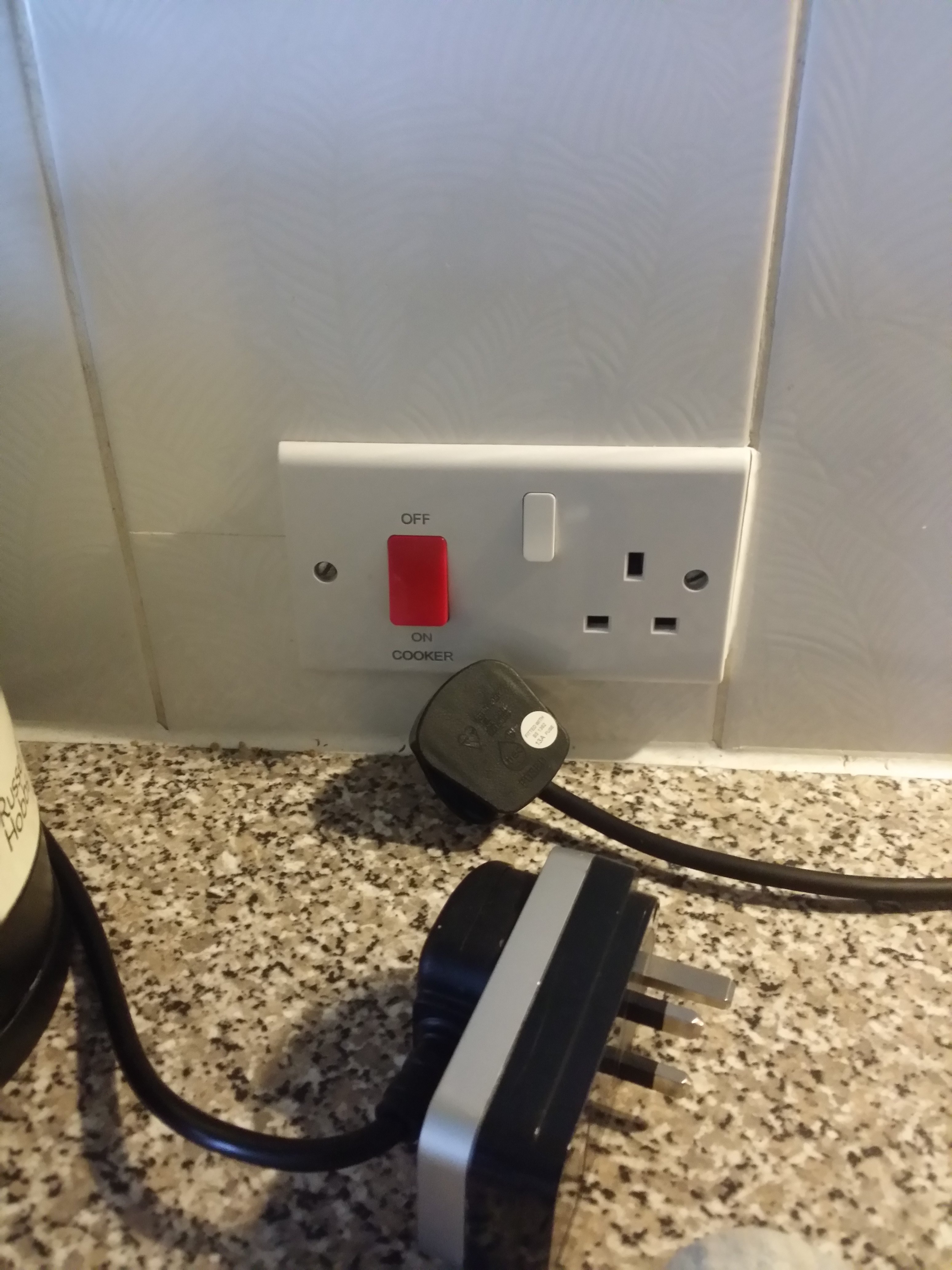

Hi all,
I currently have a cooker control panel with a 13 amp socket but the cooker switch needs to be on for me to use the 13 amp socket.
I remember using at my last place the two where separated and I could then use the socket without the cooker on.
If thats right then what panel do I need to do this?, reason being I don't like the cooker being powered on when im not using it and I just want to boil the kettle etc.
Thankyou.
Regarding my post above.
I miss understood. Thinking it only had one switch controlling both cooker and socket.
Yes. As everyone else has said its a basic mistake easily rectified by swapping conductors around.
Competant spark would get that done in 15-20mins depending on size of conductors, legnth of conductors and depth of Back box.
That socket outlet is FAR too close to the worktop.
Yup, I rent this place and even I know about distance/location with these things...
Its a Victorian house converted into two flats, I wont show you the 2 gang socket under the kitchen sink then...., they just boxed it in with a panel yet from the top its exposed, I had to build something around it for protection...
