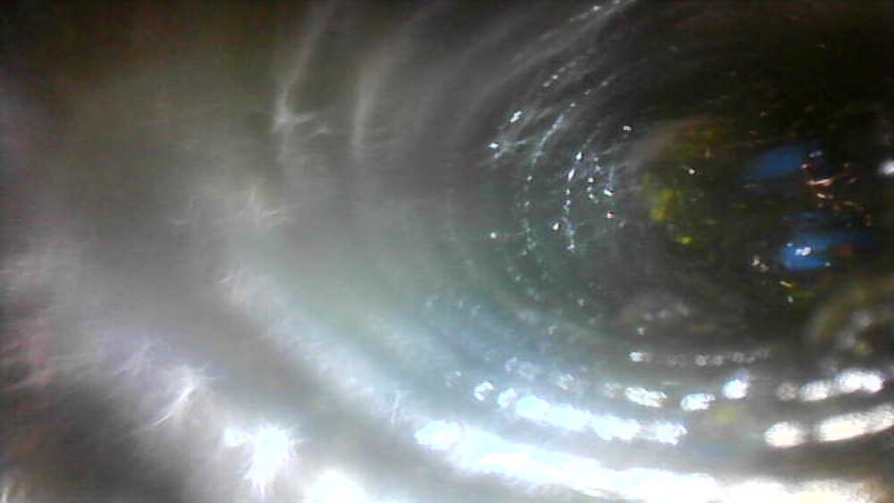

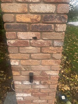

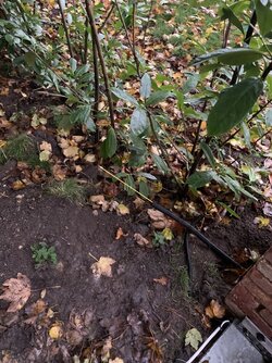

Any suggestions welcome.
The gate company has pulled the draw cord out of the flexi conduit inside the brick pillar and left behind a blockage of tape by the looks of it. The pillar has been back filled so no chance of getting inside.
Ive got the bore scope down and you can see the mess.
I’ve tried poking a Klien steel draw cord through and also a 10mm tri rated but it’s stuck fast.
Its about 200mm into the pillar.
It’s my gates BTW...

There are all sorts of ways of trying to do this and I am sure lots of suggestions will be forthcoming, but just bite the bullet and carefully take out a few bricks to get access to the conduit and clear it that way, it's what you will end up doing after frustratingly trying all sorts of rods and screw threaded ends.

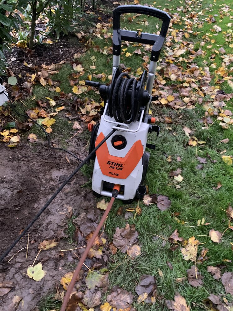

Assuming the conduit is still in one piece, that's not a bad idea if you have a jet washer, from the far end try to blast the blockage out, don't stand in front of the pier could be painful.
I must admit looking at the photo's one seems to show the conduit has been compromised and split, hope not.
Have you been in touch with the gate people and asked them to rectify the problem they created? if indeed they did, the split conduit may have been done by the builder and that's why the draw cord failed when pulling the cable?
Does the flexi go though the brickwork , rubble and end up underground or just through the brickwork into the open rubble filled core?
If it's continuous try a vaccum from either end to suck out whatever is in there.
Or compressed air and blow it out.

Hi if both ends are available and clear then I’d definitely be trying the air and water methods. If air will pass through it then my first go would be the shopping bag tied with a bit of string in one end and Henry on the other and see if it will vacuum past the obstruction. then same but with my compressor on the other end. To use an expression from ‘the old Country’ it’ll go like a rat up a drain pipe. Hopefully :) .
Options I'd look at would be to try a length of 10mm speedfit pipe to rod it out or tape a piece onto a vacuum cleaner hose and feed into the conduit until you get to the blockage and turn the vac on and pull it out hopefully with the blockage stuck to the end of the pipe

Wow, thanks all.

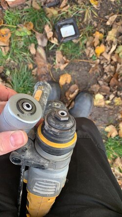

1. I’ve spoke to my builder and he’s said to drill around the bricks. He will epoxy resin them back in then point them up.
2. I tried my super rod kit, put the ball on the end and rammed the ---- out of it, no joy.
3. The pressure washer idea sounds great, all give that a go!

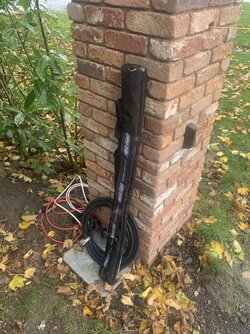

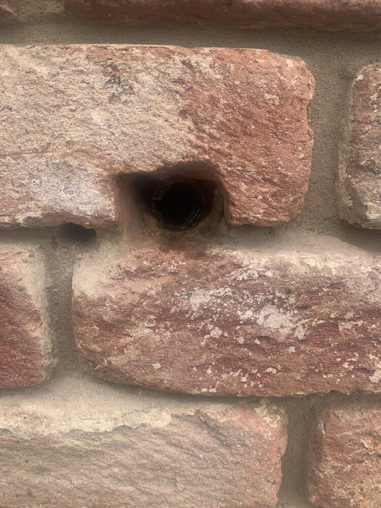

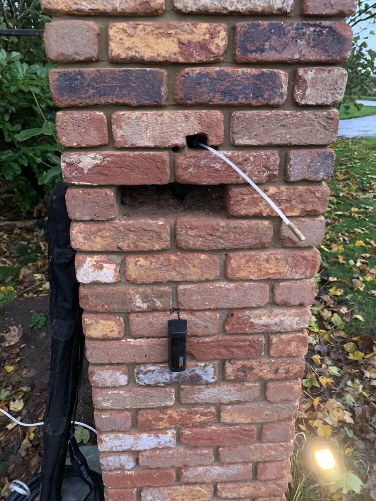

Sorted!
A combination of Marvos idea, knocking the brick out and the flexible part of the super rod set pushed in from the bottom end.
I could see no evidence of the conduit collapsing, I think it was just blocked by 2 sharp turns in quick succession.
The automation is now installed, the GSM intercom and gates are due Friday. The builder is coming Monday to fit the brick back in.
No need for TNT ? thankfully.

Just a heads up, when replacing a brick into a space like this, the brick tends to sag on the stretcher face whilst the mortar is setting, I have in the past inserted a couple of squashed copper pipe bits to support the brick until the following day, then removed them and made good the holes.

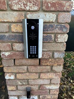

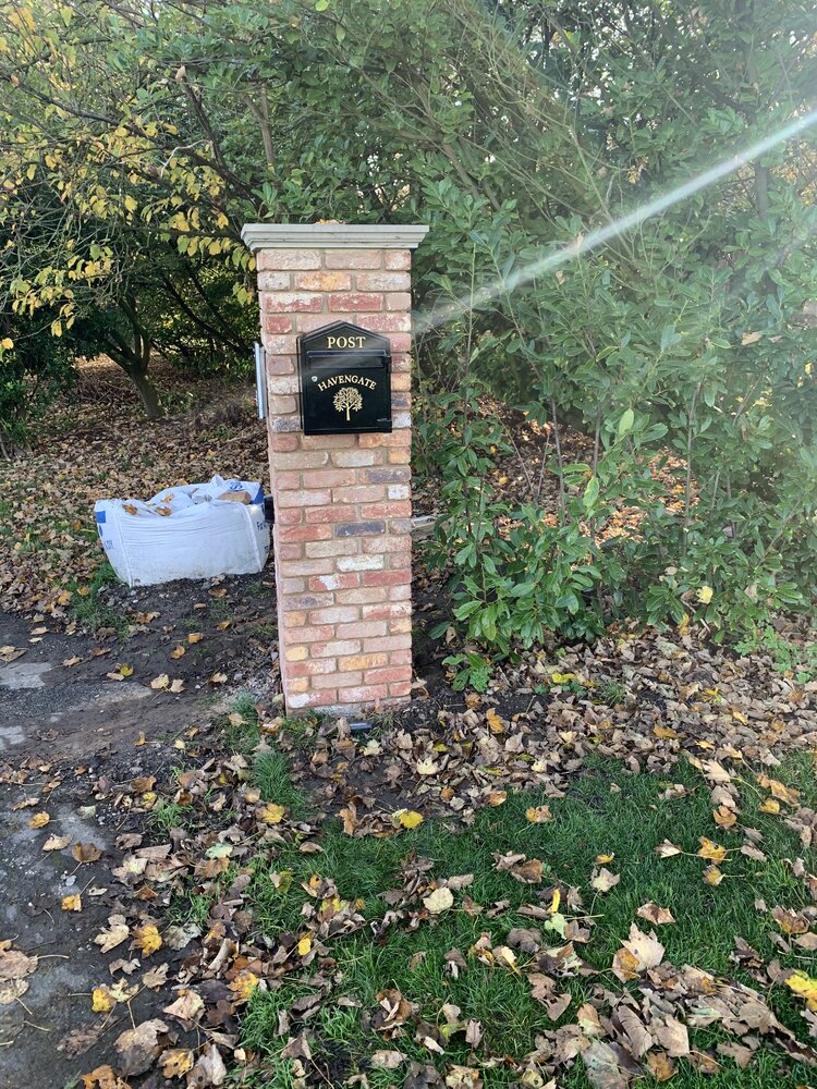

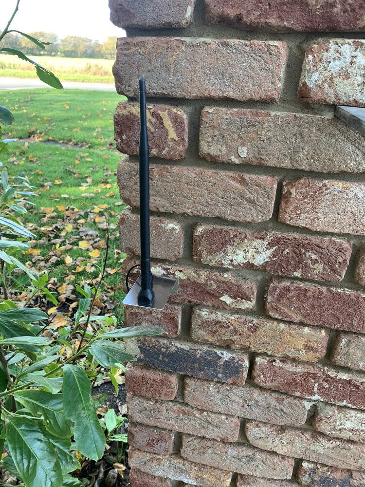

Update if anybody cares.
Intercom is on, post box is up, gates here tomorrow.
