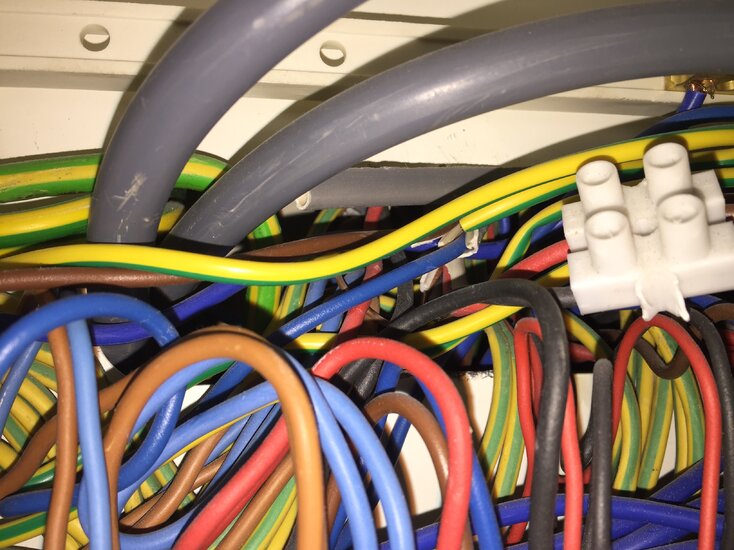

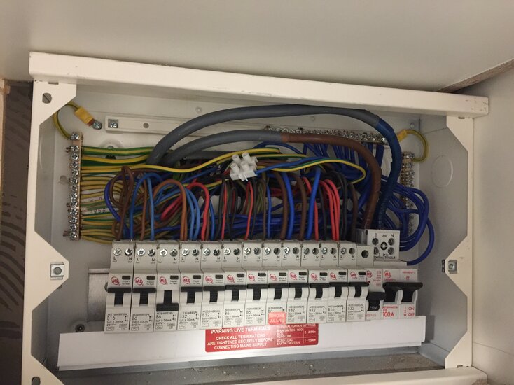

A new fuse panel was installed in the utility room. To facilitate installing a new cupboard the fitter subsequently moved the panel to the left by 2cm. In doing so he shorted a new cable that had been nicked (insulation damaged when installed by the sparkie) against the chassis of the fuse panel. Big flash and bang and main breaker tripped. Sparkie fixed the issue (not quite sure how) a few days later. Granted, the fitter should not have moved the panel but that the sparkie nicked the cable and either didn't notice or didn't care?!

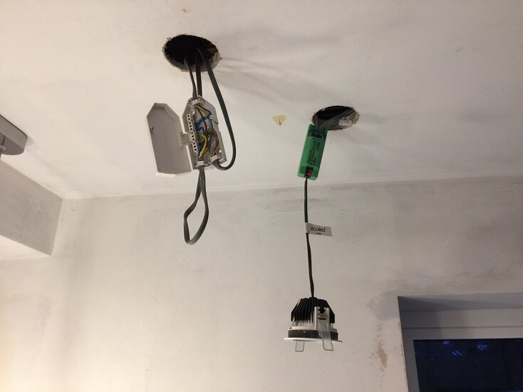

As part of the testing he measured earth resistance on the new kitchen lighting circuit. After the testing finished he left a junction box dangling through a hole in the ceiling with its cover open and live wires exposed and he lost the cover to an LED driver so the live wires are exposed there as well.

I was standing right behind the fitter when he was fiddling with the fuse panel. He simply unscrewed it from the wooden blocks it was screwed to and move it 2cm and things went very bright and then dark. He had no tools in the proximity of where the scorch marks were.
How did the nicked cable touch the chassis of the fusebox? Are there no grommets/glands fitted? Can you post a picture? Cheers.
Can anybody make out any kind of grommet strip or any form of protection for the tails coming in? I'm tired, my eyes hurt but I cant see any.
*Edit - upon closer inspection I think I see bare, cut metal at the bottom and outer sheath of T&E at the top. Classy
