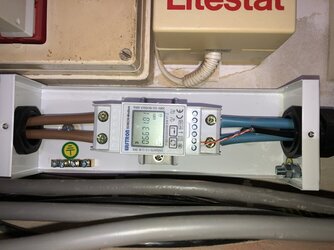

Doing an EICR that’s ‘interesting’.... found this. Installed by a solar outfit, it’s the first thing in circuit after the supply meter, feeds back into a pair of Henley’s doing the rest of the mess. L & N terminals are wired incorrectly - can anyone think of a legit reason for doing this this way? And so no... there’s also no protection to it or means of isolation.
Am I right in thinking it should be L in and N in at the top?
Are the colours right? 2 Lives at top and 2 neutrals bottom.
I’m surprised it’s working at all.
The conductors themselves are correct - those are two neutrals etc, but it should be L/N top and L/N bottom (I checked online). So A) I'm not entirely sure exactly what it's been measuring anyway and B) the entire mess of an installation is in some way passing through it. When I get a minute I'll draw out and post the circuit.
The customer said to me (his words, not mine so please don't think me abrasive....) "It was a Polish sparks, at the end of a day, in a hurry to leave". Country of origin is irrelevant, but the rest I can absolutely see!!
The terminals are correct it is NN one end and LL the other end. Just fitted one of them.
Yep - I looked that up as well. The terminals are numbered on the casing as 1-2, 3-4, not 1-3, 2-4
Wow...... that's a confusingly close error to make between the two almost identical units! One is as Vortigern says - LL, NN and the other is LN, LN.
OK, so we'll keep that one for FI on my next visit (pretty sure it's a V2 wired as a V1). In the meantime, it still seems to be in a useless and dangerous position in the circuit.
Other (big) issues aside, at least it looks like it's rated to 19kA breaking capactiy (is that a common rating, 6 and 10 are the only ones I usually see in domestic?) So it shouldn't explode before the DNO fuse goes!
What are standard meters rated at?
