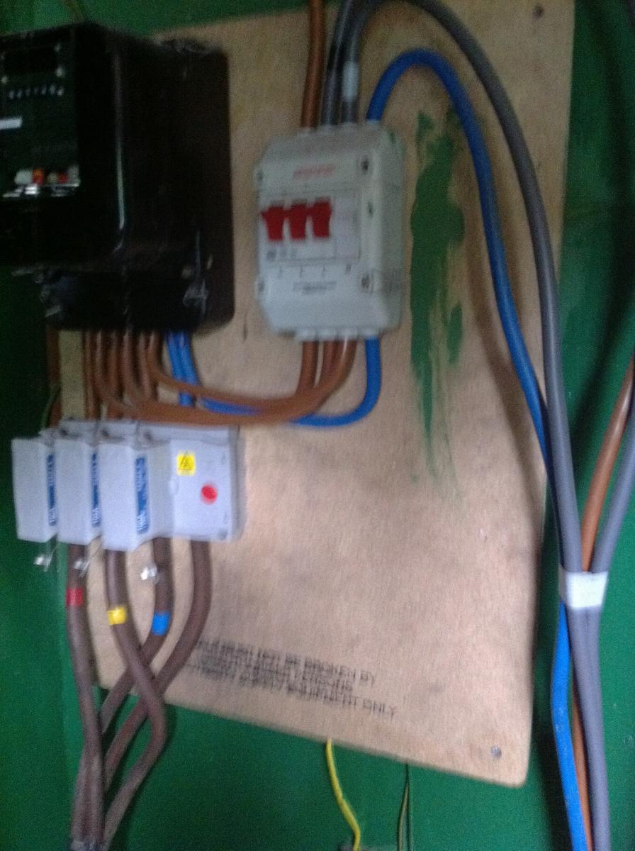

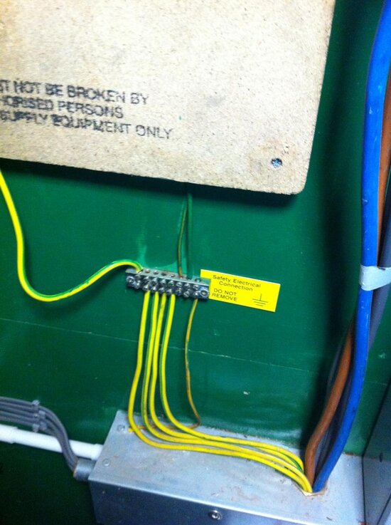

Eng, thanks, I've never come across this before ( I have not been able to carry out a Ze test at the mains. I cannot make out the main earth
conductor so how would I do it?? ((
Where have you taken the supply from for your installation?? The overhead supply could be a sub-main from the works main intake, but then would have included a earth conductor. You really do need to do some investigation here. As there are certain rules that need to be taken into account when PME supplies are involved!! Especially if any of these workshops you have supplied have any extraneous services (metallic water/gas/ steelwork etc)

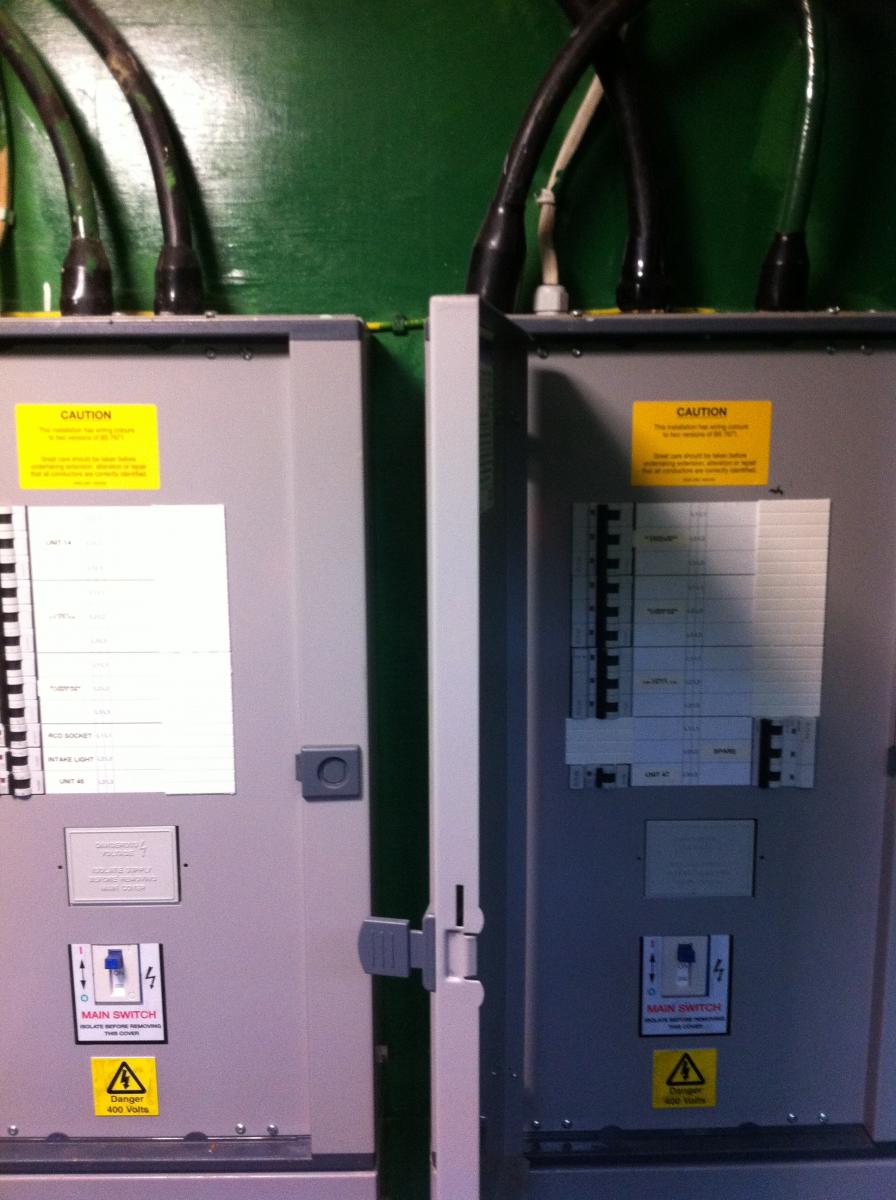

Honestly chaps I've looked over and over and traced the other earths than run away from the earthing connector block, I've tried breaking it down but still get readings via parallel earths, am I missing the obvious?? Wish I could upload pics then u would see (

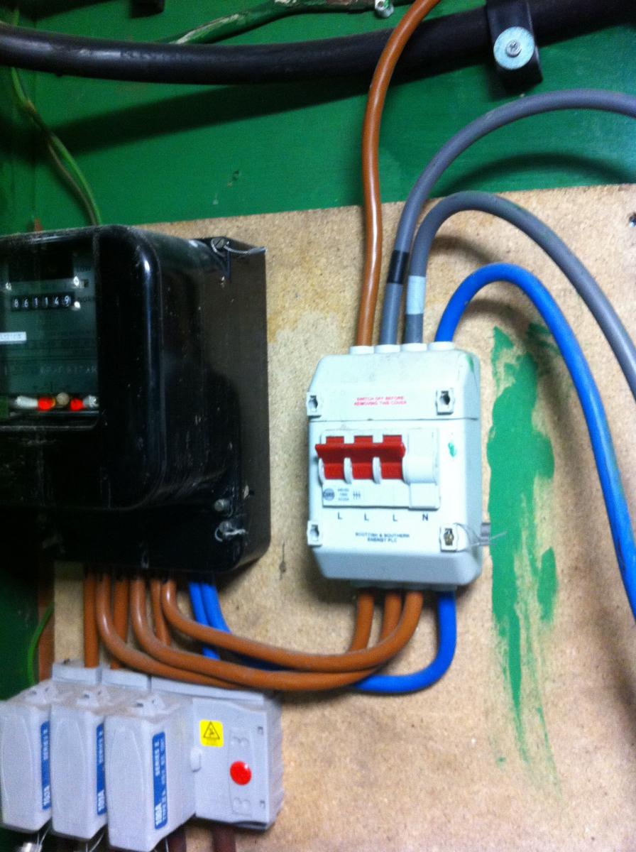

Eng, I have take a 63a supply over to block of units. No water or gas supply into units, just glorified sheds. If you have e-mail I could send over pics if anyone is interested?
You really need the advise of the supplier,there is obviously a earthing system in place somewhere
If the suppliers earth terminal is not apparent maybe there is a possibility the whole site is TT
You say readings are within range,within range of what? Are there rcds around or are we talking extra low TT readings for fuses and/or mcbs ?
Hi DES, I was thinking the same as you, done a earth loop test on a circuit supplied by a b type 20a mcb and the reading was within range of that of the osg for that type of breaker, I have fitted rcbo's for my ring mains and they operate fine.
