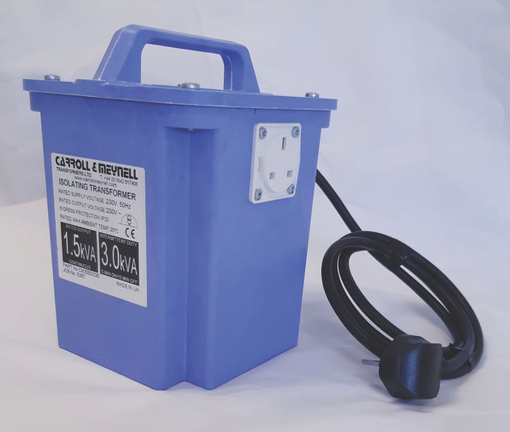

Hello - hope someone can advise please.
I have a recently purchased second hand Myford lathe which has a 3-phase inverter (Siemens Micromaster 410)
Lathe all works fine but regularly trips my RCCB 80A 30mA breaker taking out half of the board - usually when first powering on. The inverter is plugged into my downstairs ring main which has a Crabtree MCB B32 breaker but it is always the RCCB that trips.
A PAT test of the inverter reveals that Ileak is 7.29mA which I understand is over the limit of 5mA and is therefor a fail.
The manual for the inverter says that if a RCD is used it must be an RCD Type B. The downstairs ring is protected by a Crabtree MCB 32A
Lathe works just fine if I power it from my inverter generator (no Ground of course)...
There is an option on the inverter to remove the Y Capacitor link if it is used on an ungrounded supply - but I guess that will have safety issues.
So anyone have any ideas to stop the inverter tripping the mains (I'm guessing the fact that it is also an inductive load doesn't help)

It would be better if it could be fed from a dedicated RCD/RCBO rather than sharing with several other circuits. The combined leakage on your existing RCCB could be on the threshold of its trip point.

we have slowly worked round the ones that trip rcd’s and installed an isolating transformer in each one.

Thanks - is there such a thing as an isolating transformer that can be plugged in to the ring main then the 13A plug on the inverter plugged in to the transformer?
Not as far as I know.
it could be added to the machine control panel though.
There are isolating transformers available in plastic or metal cases that offer a built in 13A mains socket to feed your equipment.

Thanks both - at the risk of being accused of being premature (hate it when that happens :) I found that exact device in the Screwfix catalogue and ordered one earlier on today - I'm picking it up tomorrow. Assuming I don't burn the house down or electrocute myself I'll report back tomorrow.
Looking at the instructions on the Inverter it says I must cut the Y Capacitor link if using it on an ungrounded supply. When I run the inverter powered by my Pure Sine Wave petrol generator it works just fine, and I guess that is seen as an ungrounded supply. I'll try it with the new isolating transformer and se what happens first before cutting the link.
Thanks all for your helpful advice. Dave
Just an update - the Isolation Transformer from Screwfix fixed the tripping problem - so thanks to @James and @DPG for the advice.
