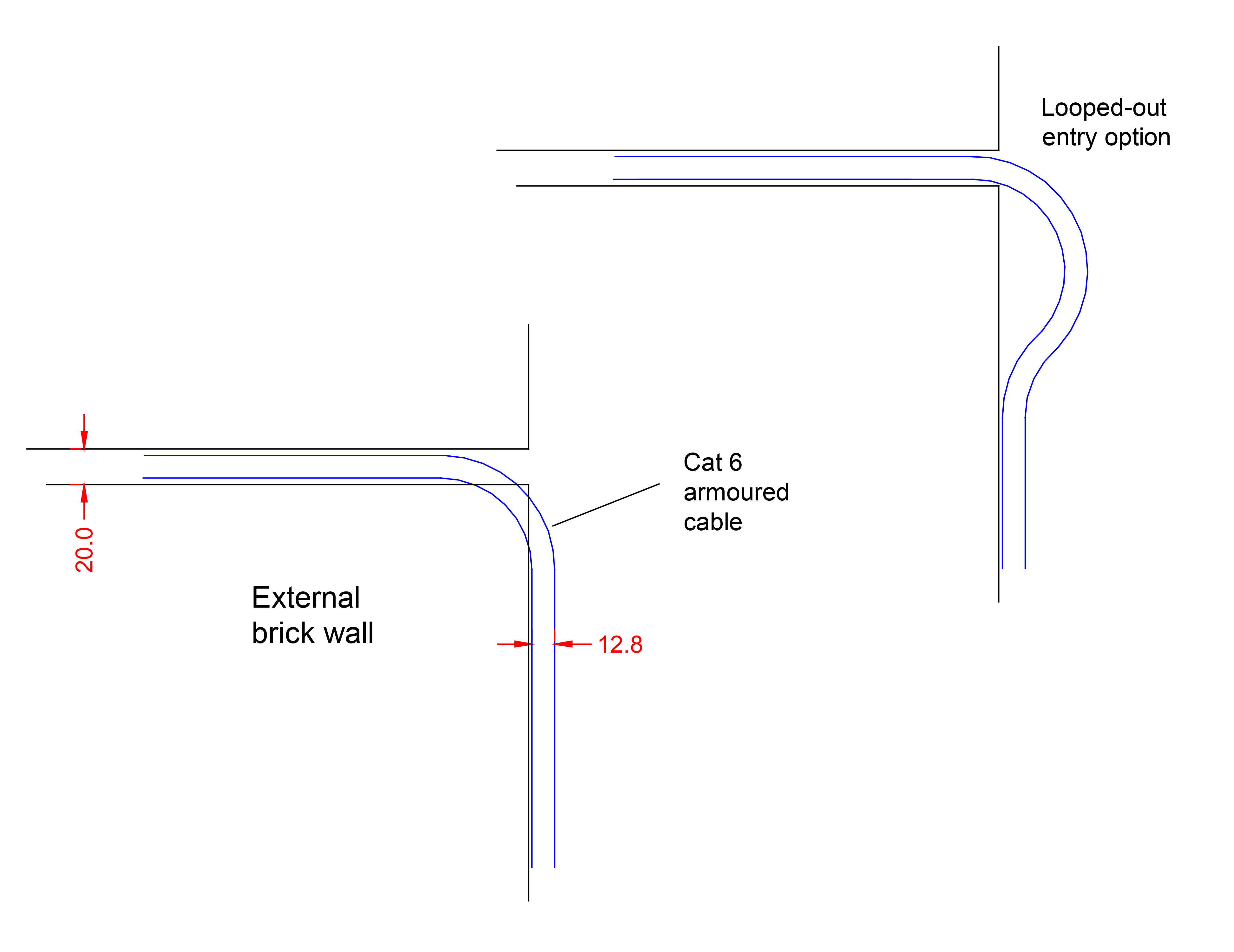

I am planning to run an armoured Cat6 Ethernet cable to my house from a detached garage. The external section of this cable will have to pass through the brick walls of the garage and the house, and I would appreciate some guidance on how best to handle that aspect of the job.
The attached drawing shows two options for dealing with the minimum bend radius of the cable. In each case, how should I seal the entry point?

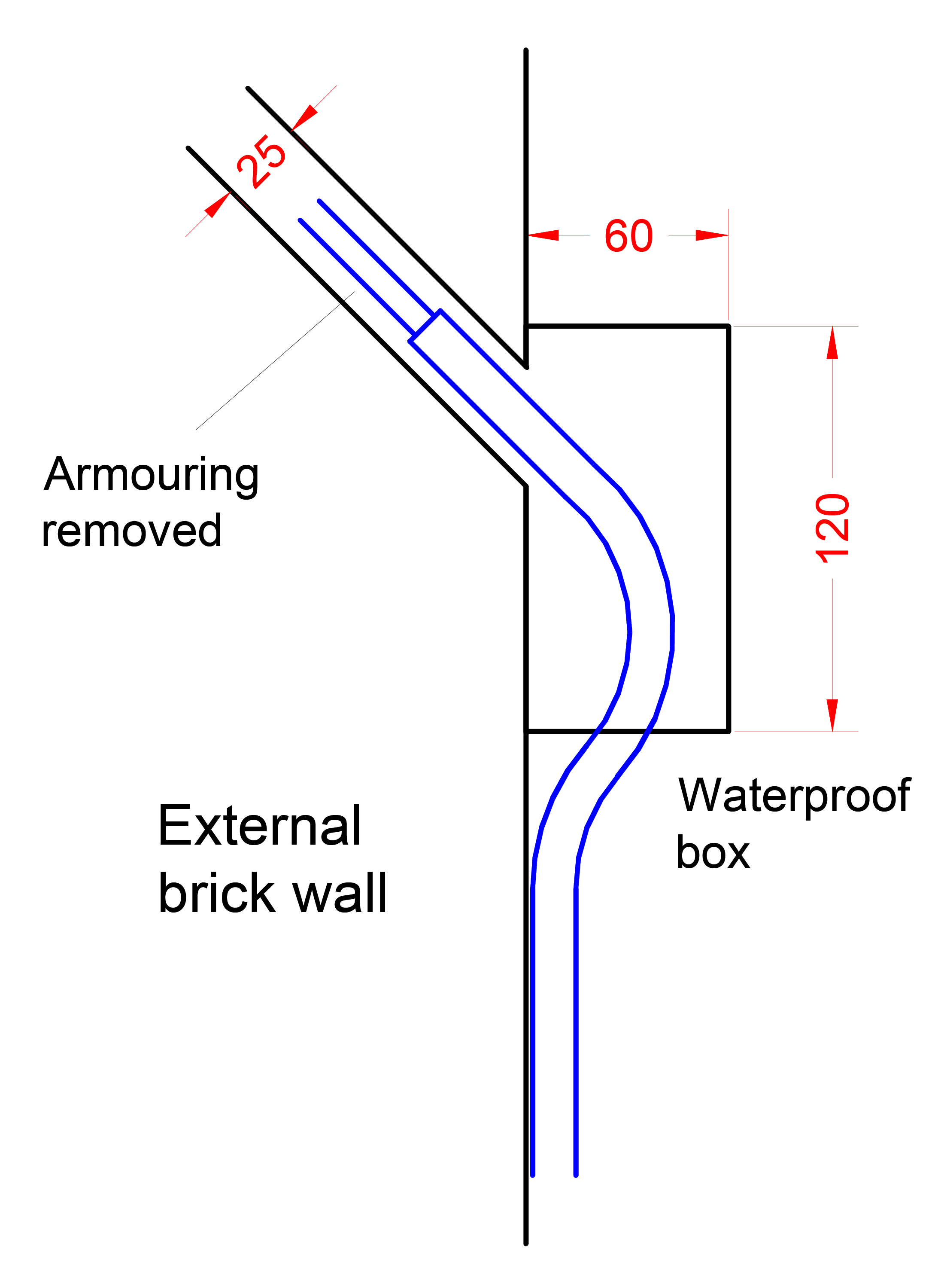

Strip the outer sheath and armouring off the cable from the inside end back to where the cable passes through the wall.
Terminate the armoured into the bottom of a box on the outside of the wall using a suitable gland and run the none armoured length through the wall to wherever you need it.
Seal the back of the box to the wall on the top and side edges.

If possible, drill the hole at 45 degrees, lower side of the hole on the outside of the building.
1. stops water ingress to house
2. helps with the bend rad on the exit. (especially if the last bit is rounded off by starting the hole almost vertically and transitioning to 45 degree as the hole goes in the first inch or 2.
The attached new drawing combines the responses from both snowhead and James. This is looking like a good solution :)

I think you have misinterpreted post #2 advice, it would only be the section that enters the house/garage that would not need the armour.
I would gland the cable to secure the armour when it enters the insulated box (not metal) as shown in post #5 then unarmoured cable into the buildings.
If you use a wiska armoured cable gland it keeps it fully insulated and cant be considered extraneous metal!
