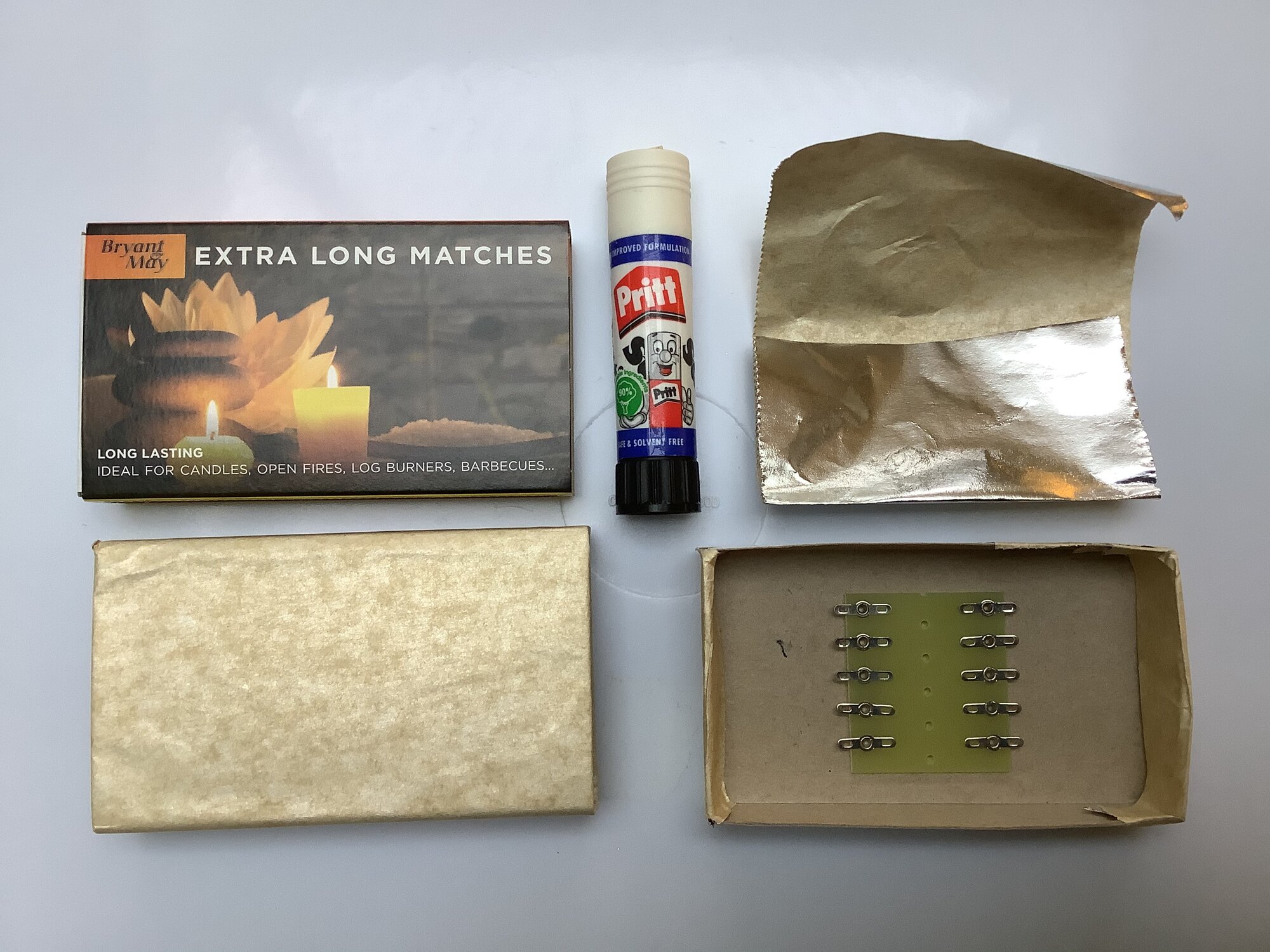

Would you do one test for me in absolutely the way I describe? Make up a 6 Volt battery and use this to power your wings circuitry instead of the 5V power supply. Completely disconnect the 5V mains power supply (top left of your wings board) and unplug it from the socket. I would like to see how the modules behave when powered by a pure continuous direct current not derived from the mains supply. Four AA batteries should do the trick - four Cs or Ds even better.
Solving problems is what engineers like you and me and countless others do to have fun. I hope you like the latest motivating poster to go on the wall in your laboratory.
