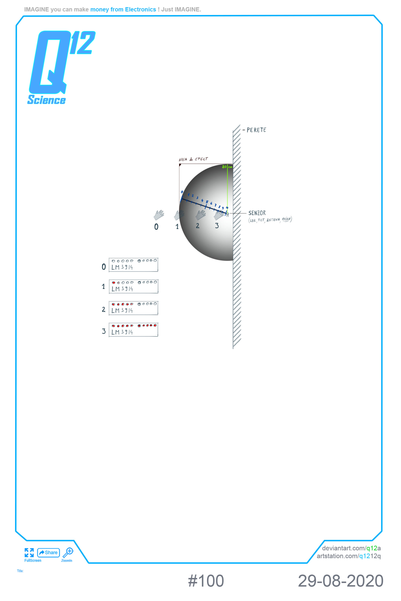

These are the stages I am working through with my version of your project:
1. Movement sensor to control the ruler of LEDs - my work at the moment, about 80% complete and then thorough testing;
2. Build pulsed LED array with 940nm torches* and associated pulsed LED receiver to produce Vs - pulsed sensor to distinguish torch reflections from steady (albeit slowly changing) ambient IR ;
3. Ambient IR monitor and controller to adjust for ambient IR - circuit built but yet to be fully tested and developed further as required.
4. Beep/click sound signal each time a ruler LED turns on/off.

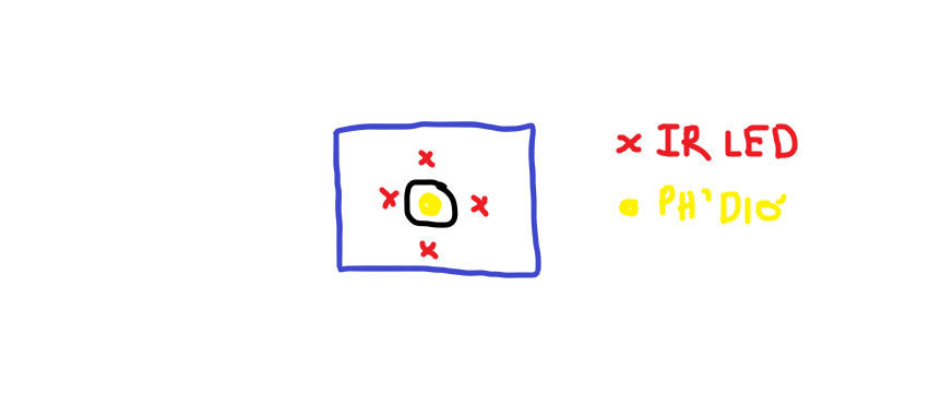

q12x Good morning. Just a thought on your latest IR sensor. The photodiode is operating in the photovoltaic mode which is ideal for low light levels because the dark current noise the photodiode produces is minimised. Any diode current flow is then mainly due to photons hitting the photodiode.
It may be that at the moment the single IR LED is not providing sufficiently intense illumination of your hand in front of the sensor which is compensated by using a high gain cascade of op amps (1) and (2) - (A = 100 x 10 = 1000). Of course this also means that ambient light from other sources will be detected and similarly amplified by a 1000.
What about brightening up the IR light you shine by having 2, 3 or 4 IR LEDs placed around the single IR photodiode? One might then reduce the gain of op amps (1) and (2) which would make your sensor less responsive to ambient light. The sensor would then mainly be reacting to the reflected light from the IR LEDs and tend to ignore ambient IR light. Worth a try? The second image shows my 850nm array of 4 ir LEDs and 4 pds.

The other subject, the IR leds, YES, I will have to test more of them as you just did on your board. But again, this was more an educative circuit for me, since im quite new to both IR and opamps. Now im a bit more familiar with them. I will make it in the near future.

I have been pondering why LED1 is lit whenever one of the LEDs 2-10 is lit in dot mode. The LM3914 should not do this as you have noticed. For correct operation , the Vref voltage has to be less than or equal to the V+ voltage minus 1.5V.
You have two resistor connected in series between Vref and ground and their midpoint connects to the Vref adjust pin. If I remember correctly, the two resistors are the same value which means that Vref becomes 3Volts. This the voltage impressed across the internal voltage divider which provides voltage references to the 10 internal comparators which switch the LEDs on and off.
My first thought is that for correct operation V+ (pin 3) with respect to the V- (pin2) must be equal to or greater than whatever the Vref (pin7 ) to V-(pin 2) voltage is plus 1.5V. Is it?
If Vref V1 is 3V, then V+ to pin2 must be 4.5V or more. Is V+ decreasing below 4.5V when the LEDs turn on?
Take voltage measurement at the pins of the ic.
