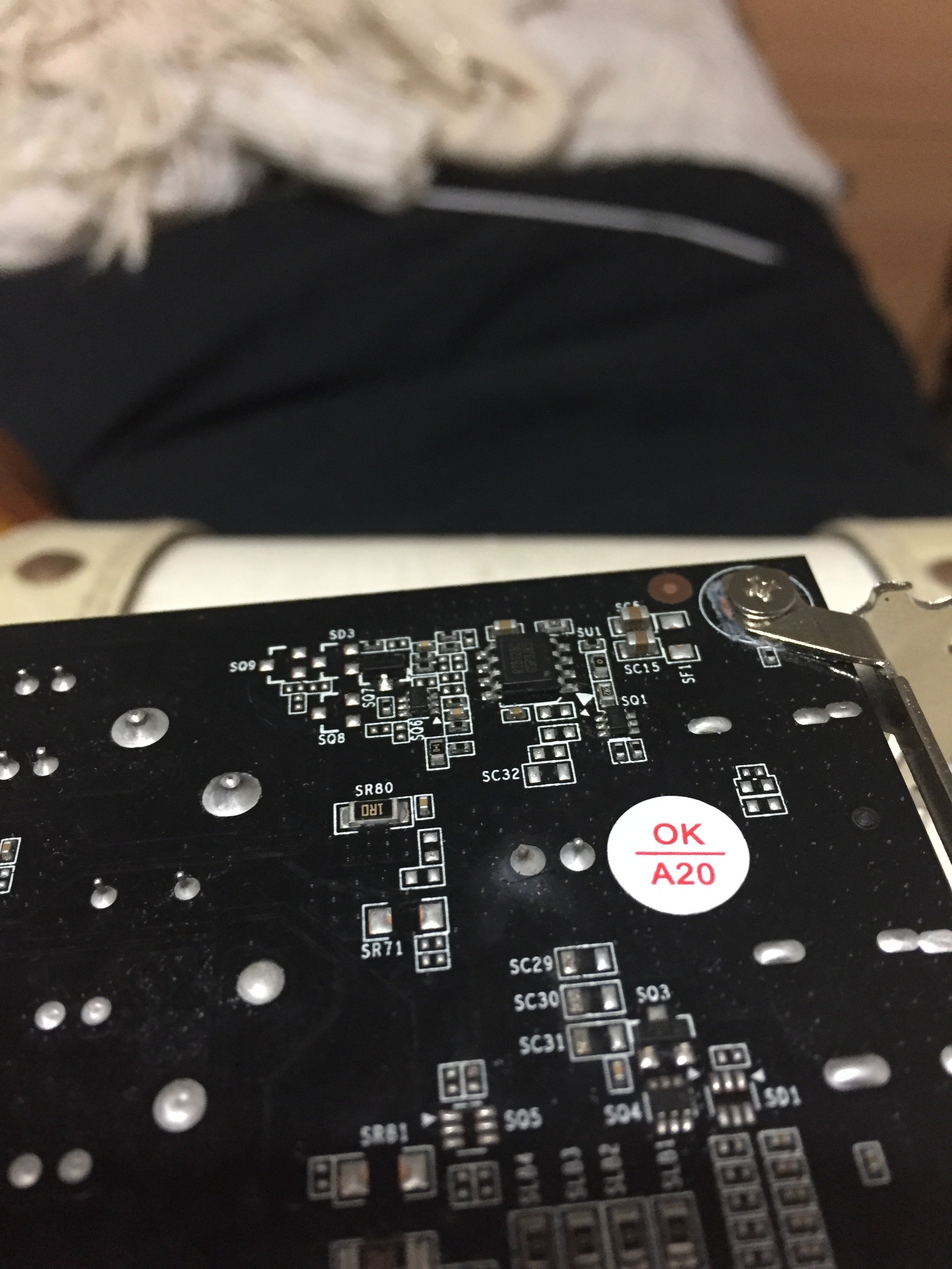

Hi everyone
I have the strangest problem that no matter who I ask in the trade they seem to scratch their head and tell me to buy a surge protection unit. I have bought a million surge protections units Just sayin
Here is the problem and some of things done over the past three years to try to resolve it ....
I seem to be getting some sort of problem that is blowing up my computers. No amount of electrical test seem to find the faults. It's not just bad components or the company's where I buy the machines either.
I have estimated Over 16 devices blown and 47 repairs since 2014. This is from five different companies where I have purchased computers with a warranty.
Computers last typically for anything up to two days or two weeks before failing. This most common failure benign burnt chips on the GPU s
It is my understanding The modern motherboards have built in surge protection and they go into protection mode when a surge is detected. I have had this happen but when I next switch on the computer the GPU is damaged or becomes damaged.
Work carried out on my electricity by the electrician working for the housing association house I live in
1 - four different surge protectors bought
2- ups bought with surge protection
3 - 2013 a full electrical test on RCD panel and all sockets - passed
4- 2015 another full electrical test - passed
5- electric supplier monitored for surges from outside- none detected
6- two sockets faceplates replaced (the ones used for my computer)
7 - independent electrician hired tested sockets. No fault found.
8 - Eco Max Home Voltage optimiser fitted on RCD panel and set to 230v
Other information.
No other devices in the house fail and we have two HD TVs, a MacBook, two iPhones, router, and the usual lamps, kitchen equipment. New mouse,keyboard,HDMI cables,USB cables purchased
UK based electrical system with RCD panel with an additional Volt regulator fitted. We have 240 volts coming into the house
The housing association also fitted a gadget that regulates the volatage 230

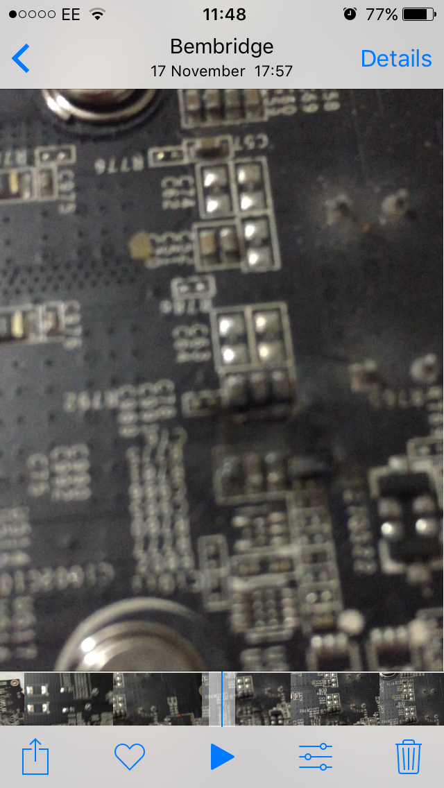

On the last occasion I saw the the computer component frizzle smoke and could see the damage. I'm really worried about a fire risk
I have on occasion see sparks come from the switch on the outlet.
I would appreciate your thoughts on why this is happening to me as three independent electrical test and Electricians tell me they can not find or think of what could be causing it.

The sparks from the sockets '!!! What does that mean????
The last time the GPU burnt I saw sparks as switched on the socket and then I heard crawling and smoke
When I lolled at the GPU I could see visable burnt components
