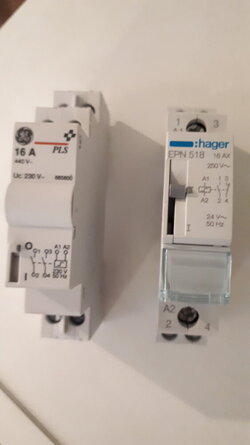

Hi. I have a problem with these relays. They are controlling the lightning in my house. Light are always on and switches are not working. Lights can be turned off only from main fuse. Lights have 24v transformer. Is there some kind of trasformer or fuse controlling the relays witch can be broken?20200914_085209.jpg

House is about 200 m². Relays are controlling microswitches for lightning at kitchen, livingroom and some other places. Fifth relay from left were broken and i tried first replacing it with the left one at the picture.
And that was mistake cause its wrong relay. The right one is new and right.
Latching relays are circled red.
Also led lights inside the microswitches blacked out. Thats why i thought if there is some kind of transistor conrolling the relays.
So changing the one relay has resulted in all of the lights in the house malfunctioning? This seems strange. Do you have any test equipment?
If you put the original (faulty) relay back in, what happens?
It is now on place. New one kept hell of a noise and nothing changed. I guess cause you cant close the new relay.
Yes i have multimeter but my skills are limited at this purpose :rolleyes:
