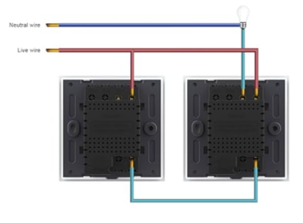

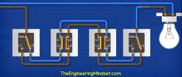

My hall is wired with a 3-way switch circuit, controlling a single light fitting from 3 locations, and the landing circuit is 4-way, with a pair of lights switched from any of 4 locations. I have verified with the electrician the circuit wiring is standard UK (2004 build) as shown in the attachment (4-way example). The back of the proposed touch switches are as in the other attachment, Livolo 3-way.
For normal light switches the replacement is simple using a couple of 2-way switches and then a number of intermediates as required per circuit, but there does not seem to be an equivalent setup in the touch switch world and the electrician has never done this before. I found the LIVOLO's advertised on Amazon as 3-way but will these meet my requirements and would I simply purchase 4 of them for the 4-way circuit for my electrician to fit?

it looks as though you can just add more switches in parallel like the second diagram there. Loop the brown between all switches, and loop the pale blue the same. (should really be sleeved in brown to distinguish it apart from the darker blue neutral. Took me a few minites to see the light bulb)
The actual layout of your wiring needs examined as well... I would expect the live feed, with a neutral, plus the switched live and neutral going up to the light, and a 3 core + earth all at one switch.... with the 3 core running to all the switches in turn. I doubt its exactly like your blue diagram there.
It needs planned carefully whether this can be done or not... but i think you'll have a redundant core in the 3 core cable.
EDIT; Just crossed with Littlespark - I'm not sure that other switches in parallel will do it - you'd have to go back and turn one off surely?

The schematic of LIVOLO 3-way you show is just another way of doing UK 2-way, and it shows just two switches.
That circuit cannot be extended to further switches (unless I'm missing something !)

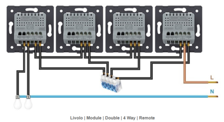

I think this is correct, on their website they have a 4-way 2 gang (remote), in the text for this is states that the lights must always be connected to L1 and L2 position and then 1,2, or 3 2-way switches can be connected as in the attachment. It means I'll have cores not needed but already have traced each core so know how the circuits are built. The only issue I have is that my 4-way and 3-way have a common 2-gang switch which I believe the common line from each gang (yellow core) is the switched live to each light. Will need to draw this out I think as electrician is not happy to progress.

It appears the Livolo single or double 4-way Remote switch is what I need. From their site "You can easily connect the Livolo remote 4 Way switches to 1, 2 or 3 normal touch 2 Way switches. You only need to have 1 remote 4 Way switch in a 4 Way circuit."
My only challenge now is I have a 3-way and a 4-way tied together by a common 2-gang, 2-way (inters are all elsewhere). But on the surface it now seems possible to do if I can redraw the wiring and repurpose some of the cores. Electrician won't touch it until that is done and I present him with a colour coded diagram, as he has no experience with these touch switches. I'm surprised as they have been around for a while and seem popular enough and I have had them fitted in two houses but to replace 1-way switches only.
